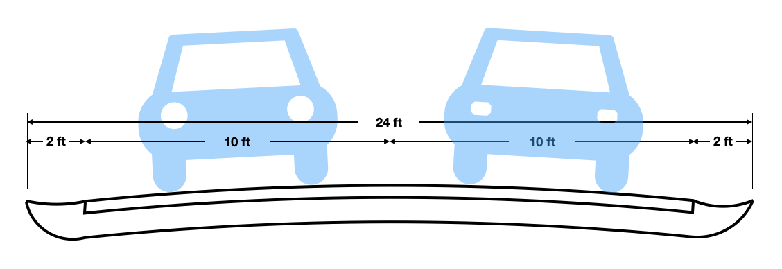

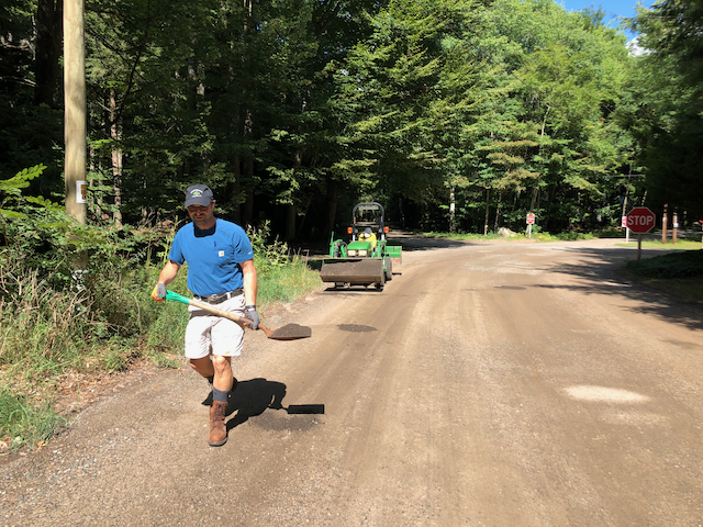

I grade a few miles of gravel road. Lots of hills, valleys and flats.
For me it comes down to a few things and all were previously mentioned.
Crown
I need to help my community understand crown in the road and why we need it. We have many that want to manage the roads from the keyboard and arm chair. I created this graphic often used to help them understand runoff with a crown. I spent meany years not maintaining the crown and using a landscape rake to grade the road and hiring a large grader to do a fall and spring grading. In the past few years I have spend much more time rebuilding the crown and the large grader is not required.

Moisture
Moisture is key to a success. After a rain, I typically wait until the potholes are just damp, no standing water in potholes. This allows the gravel in the box blade to roll and churn. I get my best finish when the gravel is just moist, not wet, not dry. The cars driving on the finish grade in that moist form really establishes a good base you need to rebuild the potholes. There will be a little dip in each pothole even after grading and cars packing which is a good time to do another quick pass before it dries out too much. We also use brine the roads with calcium chloride 2-3 times a year. This keeps the dust down and hardens the road bed like pavement...for about a 4-6 weeks. During that time, I stay on top of potholes by filling them by hand with asphalt millings from the bucket using a shovel.
Speed
Speed of the tractor is a huge factor in how well the combo works. The BB works best when the tractor is in low gear and full throttle and steady pull. Too fast, you don't dig in, you don't roll and churn the gravel and you drag the gravel through the pothole leaving just a few rocks, no fines to pack. With the slow digging in you take all of the high sides off the hole and on the second pass you start taking the pothole down. In the higher gear the tractor does not have steady power and goes too fast to do it's important work. Most of my roads are 20' wide so it take patience and seat time to do a good job.

   / Grading--what am I doing to cause this? #146
Crown
This is how I maintain public gravel roads. Excellent visual.
To do this on a hillside the OP would be required to add culverts under the roadbed to get rid of the water he channels to the high side.
