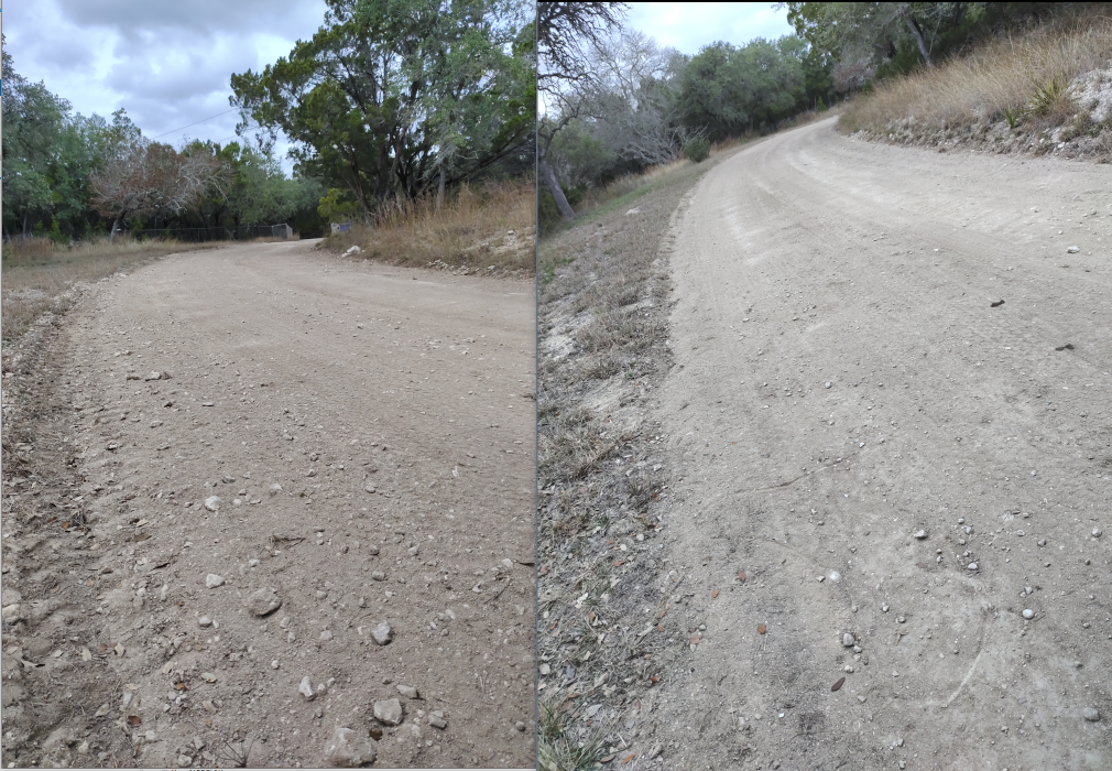

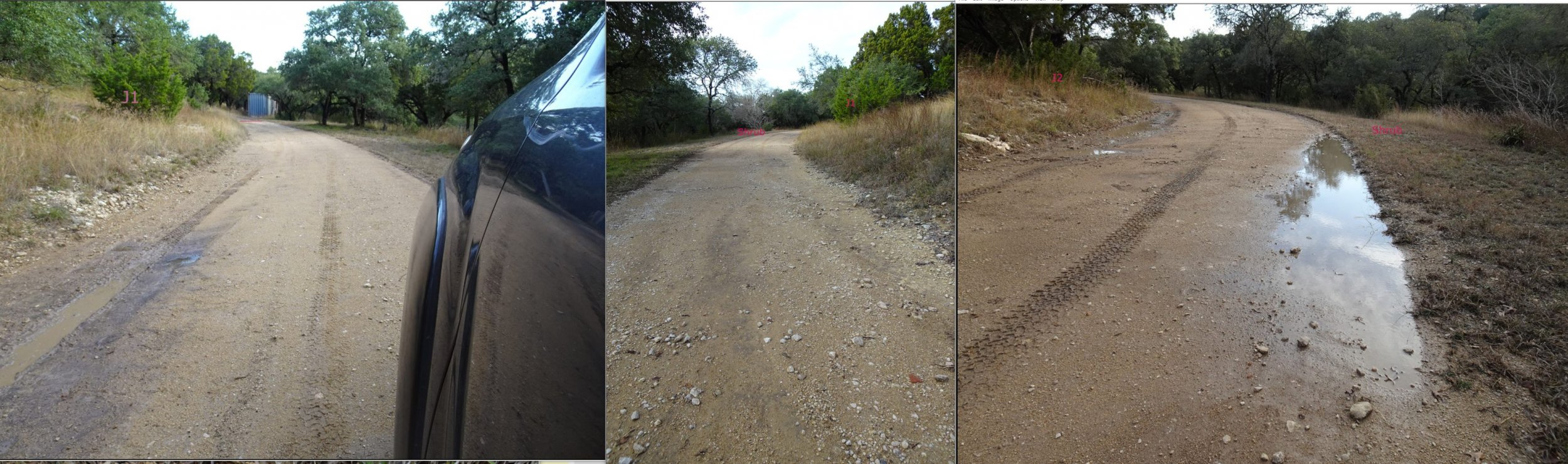

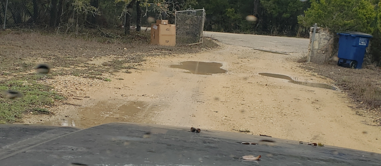

The requested pix of my road. The rainy one is from a couple of years ago [documenting delivery conditions], you can just see part of the worst spot over the left side of hood, if I got out I'd step in it. In the other photos, it's right under the straggly looking tree with right-leaning hang-over branches. Most of the road is like you see over the right side of the hood, it doesn't matter how wet it gets, it stays firm/hard enough to not rut at all.

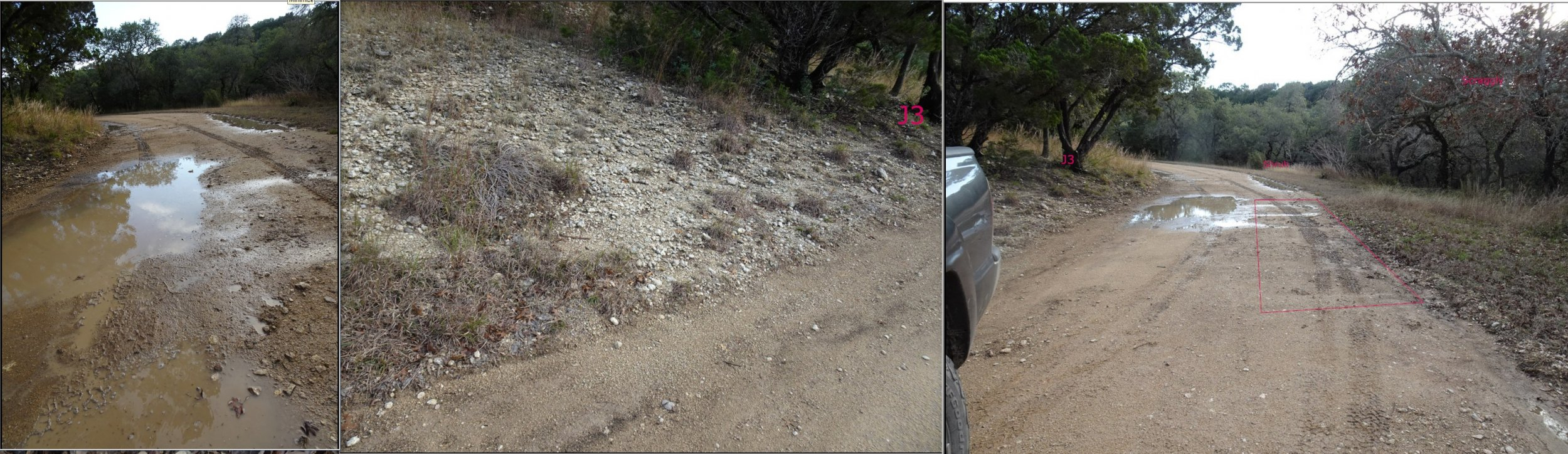

So the pix above were from Friday late afternoon, we then got 1 1/4" rain overnight so a good test and it will allow me to go abuse my poor road some more.

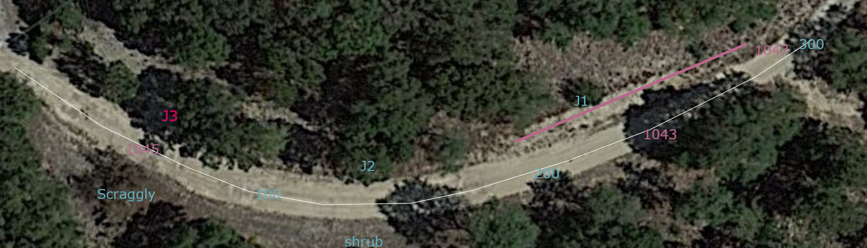

In the way too much information department, below pix show what the rain did, overall, I'm pretty happy with it. The problem spot I've mentioned is the trapezoid area, before my latest attempts, it was a fairly deep mudhole after a rain like this. With the wonders of google, it turns out it's about 315 ft of drive and varies in altitude by about 4 feet. I've labeled a few spots with elevation, distance from start and some trees for orientation. I got rid of the worst spot and turned a couple of other deep-ish holes into broader but very shallow puddles that will dry in a day or two.
I don't think the former/original owner who built the road in the early '70s ever added any extra material, the line along the road is where there was a long hump that must have been material removed to cut the road. You can see what he did in these photos, kinda draw a line down the slope to go over the road to meet with ground level on the downhill side. The top middle photo is what the land looks like in a lot of areas. I think you'll get a gravelly road without doing much of anything. The roughly 50'x50' parking area by the house has no soft spots or mud holes, it's like a gravel road, always very solid/hard with occasional fist or so sized rocks popping out once in a while. I even changed its shape with different usage patterns and the new areas are just like the rest of it.
If anyone who understands these things is still paying attention, I was thinking it seems like in this particular case, maybe trying to establish a crown isn't very useful, wouldn't it be better to try for a flat-ish but slightly inclined surface sloping downhill? I'm getting no erosion, the road doesn't rut into the usual two tire tracks, water would just run off downhill along the whole length. Trying to put in a drainage ditch kind of thing on the uphill side doesn't really make sense.
That rain was substantial enough to thoroughly wet the ground and except for a couple of places, my truck tires didn't sink in appreciably. You can tell I was digging down on the downhill side but what I think I should have been doing is grabbing material from the uphill side and using that to build up any low spots and also establish a more definite incline. The lowest spot, if google is right, is the 1043 spot and there's no water collected there.
