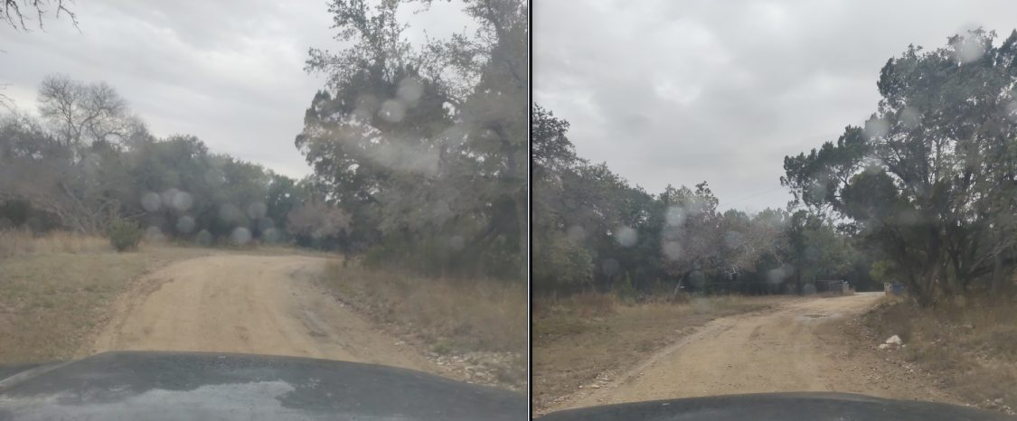

mechtheist,
I absolutely agree with your slope theory. I would eliminate crown and create a drainage slope to the surface of the roadbed. That would eliminate the puddles in your pictures. Obviously your soil conditions can handle the load of traffic. All you need to do is create drainage.
I'm not sure you will ever get a glass smooth surface. As you describe, the rocks are natural and you are going to always have to deal with them.
I am completely opposed to using a scarifier or ripping the roadbed in any manner. If you do this you will have to deal with the dozens or hundreds of fist sized rocks that you will dislodge. In the end your roadbed elevation will erode down to the depth you ripped. Which would be the exact opposite of what you are trying to do.
I would start working the loose material toward the high side of the natural ground slope. You know where the puddles are so try to bring more loose material into those areas. This is going to take time so be patient. Always end with your loose material on the high side. Create a straight side slope toward the low side of the natural slope.
I think you have a very good natural roadbed that most of us can only dream about. My Aunt/Uncle used to live near Lamar Oklahoma. Traveled 2 miles of natural material roadbed to get to pavement. I was there when it rained. It looked just like your road. A few hours later it wouldn't even pick up on the vehicle tires. I've lived with the jealousy of that most of my life. :)

I have a lot of options to try.
ovrszd I think I could get the same effect by spinning the blade around and dragging it backwards as some have recommended.
So the pix above were from Friday late afternoon, we then got 1 1/4" rain overnight so a good test and it will allow me to go abuse my poor road some more.
In the way too much information department, below pix show what the rain did, overall, I'm pretty happy with it. The problem spot I've mentioned is the trapezoid area, before my latest attempts, it was a fairly deep mudhole after a rain like this. With the wonders of google, it turns out it's about 315 ft of drive and varies in altitude by about 4 feet. I've labeled a few spots with elevation, distance from start and some trees for orientation. I got rid of the worst spot and turned a couple of other deep-ish holes into broader but very shallow puddles that will dry in a day or two.
I don't think the former/original owner who built the road in the early '70s ever added any extra material, the line along the road is where there was a long hump that must have been material removed to cut the road. You can see what he did in these photos, kinda draw a line down the slope to go over the road to meet with ground level on the downhill side. The top middle photo is what the land looks like in a lot of areas. I think you'll get a gravelly road without doing much of anything. The roughly 50'x50' parking area by the house has no soft spots or mud holes, it's like a gravel road, always very solid/hard with occasional fist or so sized rocks popping out once in a while. I even changed its shape with different usage patterns and the new areas are just like the rest of it.
If anyone who understands these things is still paying attention, I was thinking it seems like in this particular case, maybe trying to establish a crown isn't very useful, wouldn't it be better to try for a flat-ish but slightly inclined surface sloping downhill? I'm getting no erosion, the road doesn't rut into the usual two tire tracks, water would just run off downhill along the whole length. Trying to put in a drainage ditch kind of thing on the uphill side doesn't really make sense.
That rain was substantial enough to thoroughly wet the ground and except for a couple of places, my truck tires didn't sink in appreciably. You can tell I was digging down on the downhill side but what I think I should have been doing is grabbing material from the uphill side and using that to build up any low spots and also establish a more definite incline. The lowest spot, if google is right, is the 1043 spot and there's no water collected there.
I'll keep trying, figure out what works, it's a good excuse to go do stuff on the tractor.View attachment 725591

That all sounds good, close to what I was letting nebulously rattle around in my head but you laid it out in detail, thanks. There is actually a fair amount of loose material there, I don't think I would need to do any ripping, plus, I can drag in some from the uphill side which would probably be returning a lot of it to where it was initially
It is great land for roads, not so much for ANYTHING that requires a little digging, like ground rod, fence posts, garden, etc. An atom bomb might do the glass surface, hoping that isn't in the future.
