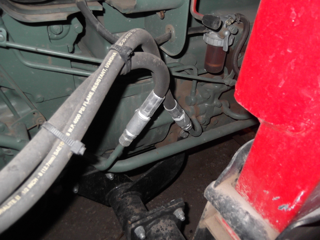

it was plumbed wrong no way it could work right its a long explanation
Sorry if I'm exhausting your patience! :)
From that photo it appears to be plumbed as Hoye recommends on their loader install page.
Ie in series ahead of the 3-point lift.
Am I understanding it correctly?

Only trying to help here....Hoye's install instructions are flat wrong. They are almost just incomplete, until they specifically say to bypass or plug the power beyond, which makes them down right bad. The outlet port on valves is not usually (i.e. almost never) rated for hydraulic pressure (500psi +). The way hoye sets it up, when the 3ph is used, the outlet port will be passing the hydraulic pressure to the 3ph. Eventually, the valve will fail to work properly, or worse, fail catastrophically. The power beyond is design to pass the pressure to the next service, and also adds another return hose for draining the loader cylinders (lowering a load). If the loader is not working as you'd expect, I'd expect the valve is leaking by internally.

Your factory loader install must have something plumbed differently ( internally ?) Or the hydraulics are engeneered to work correctly the way its factory plumbed. I can tell you that my loader was plumbed like all the rest of the yanmars that I've seen. HP line was cut & routed to the loader valve. Then , outlet loader valve to 3 PT. The loader was slow & it seemed like the loader & 3 pt were fighting each other for pressure / hyd fluid. Mark in (Redbluff Cal ?) offered some advise / suggestions as to how I might be able to solve this issue. The 3 PT & Loader, now operate great the way I have them plumbed

Well, Your welcome.The way I see it, Were all in this together. If it's a better way of doing something, a repair , adding something, etc, etc, we should let others know.....There is a T at the end of the pipe where 2 lines connect. 1 line is a return for loader valve & 1 is a return for the grapple valve. (If that's what you are asking)
