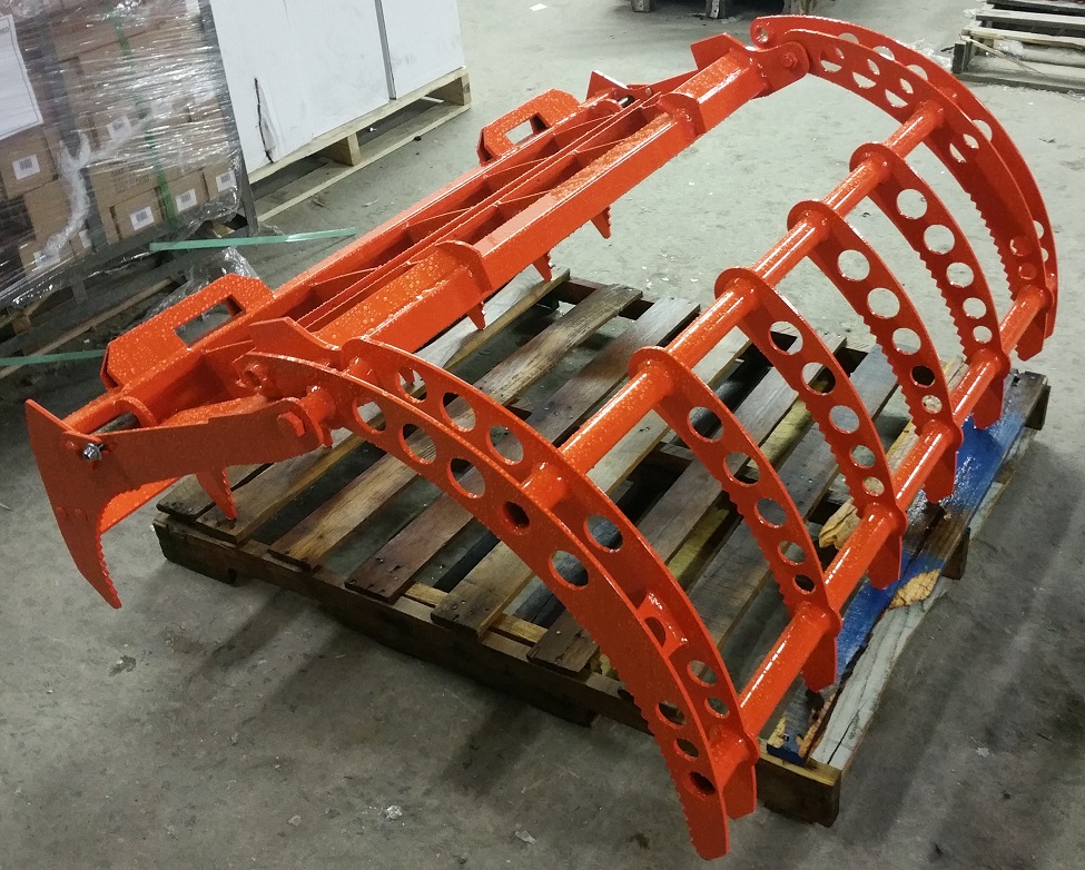

"Very excited just received my 55" Wicked Root Rake Grapple today! Have to say that I am very impressed with the level of detail on the unit from the tabbed and bolted cylinder pins, grease fittings and to top it all off they even installed Parker hoses with swivels on the lines at the tee's. Top shelf."

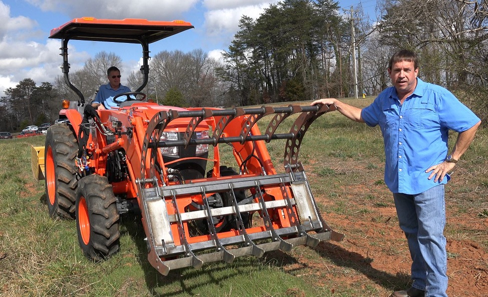

Oh, and don't worry about how strong the Wicked is because it's Ted tested with our L6060. :thumbsup:

No problem! If you can get the LP valve kit for less, I won't argue a bit, but I do not see why anyone would choose the LP over ours based on feedback, solid welds vs stitch welds, doubled up lid tines on either end, all pivot points greasable, stronger cylinder mounts, serrated tines....it goes on and on.

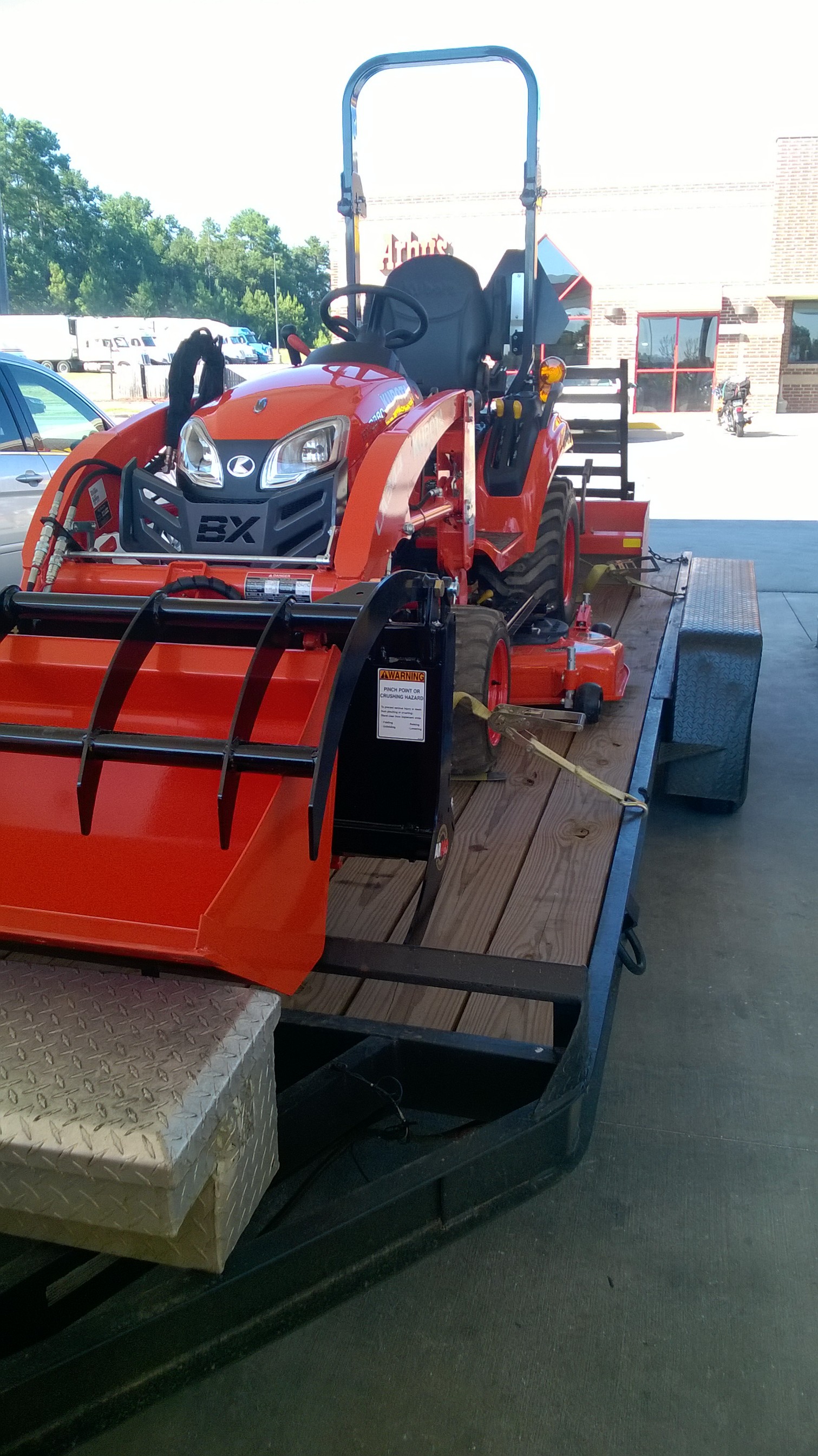

There are essentially no pics of the LP installed on Kubota tractors, even on their website or literature. Kinda funny?
We have tons of photos and even videos of the Wicked 55 so you know exactly what you're getting! Oh, and you can even get it in ORANGE!

To the OP's question: I have the same loader as you and Old Red. As Travis mentioned, you can't get the SSQA in the 48" Landpride, you'd have to get their 54". I had the Landpride 48" on my BX2370, but it did not have SSQA, so when I traded to the BX2380, I also had to go one size up with the grapple.
Couple things to point out here. You may never notice the difference if you didn't already have a BX, but yes, the new SSQA plate on your loader is heavier than the old QA on the old loaders, and the grapple choices you can use are heavier than my old grapple. Yes, I can notice a difference. That said, the new grapple seems more smooth, responsive, and tight to me than the old one ever did. I really like it better overall. Will attach some pictures here for you to look at.
Not trying to talk you into or out of anything either way, but I will say this to you from my experience. First, I don't own and have never tried the EA grapple, however, I really like 2 or 3 things better about it just by the design. I really like the serration on the tines. Nice touch getting more grip. I believe they use the same A400 steel that Landpride uses so quality has to be high. I like how they put holes in the upper teeth to lighten it up, but didn't put them in the lower half. I really like what Travis calls the runners. And really not just for controlling the depth. I actually like the idea of sturdying the tines up out toward the end. I bent 2 tines on my old grapple. One probably more than 4 inches at the end. Another maybe a half inch. Haven't bent any on the new one yet, but I do know it can happen.
