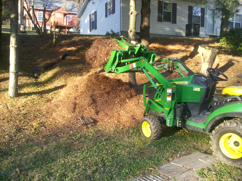

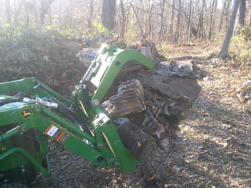

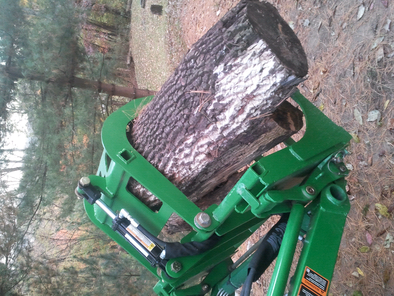

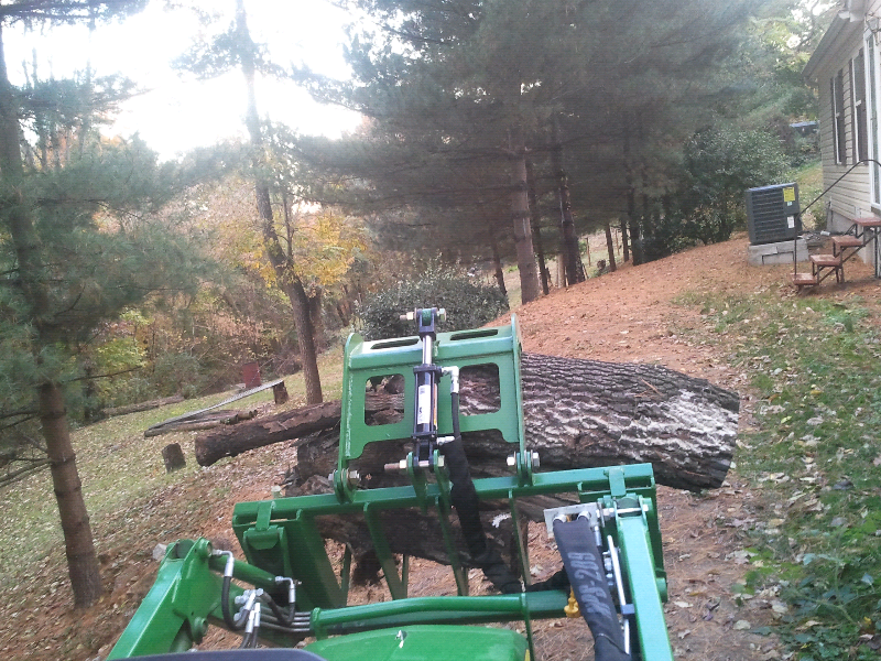

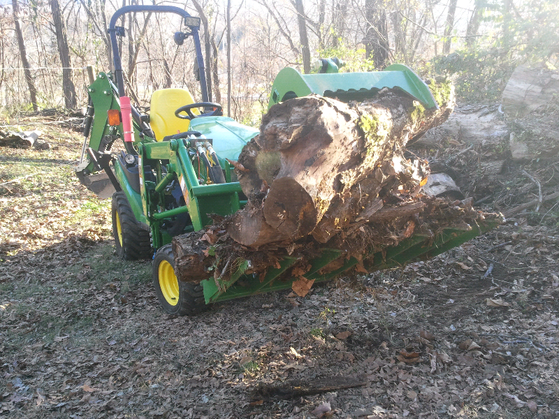

I built it out of scrap metal
3/8 x 4 x 4" angle
1/4 x 1.5 x 24" flat bar
1/8 x 3 x 96" tubing
1/4" mounting and lifting points
1/4" chain to bucket
All welded with 7018
It can safely hold 800-1000 lbs at the lowest lug and 250 at the top lug

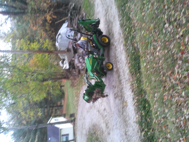

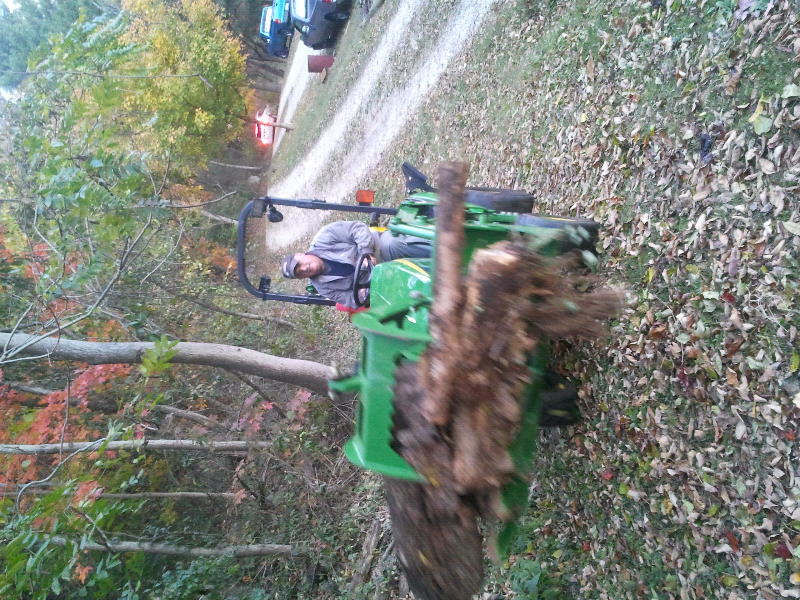

200 lbs of steel rigged at 9.5 ft from bucket pivot with the boom at a 45 degree angle. This is equivalent to 950 lbs at the pivot.
At this height I could not lift, only curl.
   / grapple hydraulic setup 1026r
#106

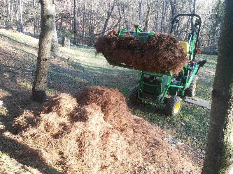

Here's me as the counterweight. The rear end was very light
   / grapple hydraulic setup 1026r #107
Ok from the picture it looked like a lot more weight.
#108
I know. I had a case 580 fill my pickup bed in two half scoops and my tractor took about 8 full buckets to unload it :-(

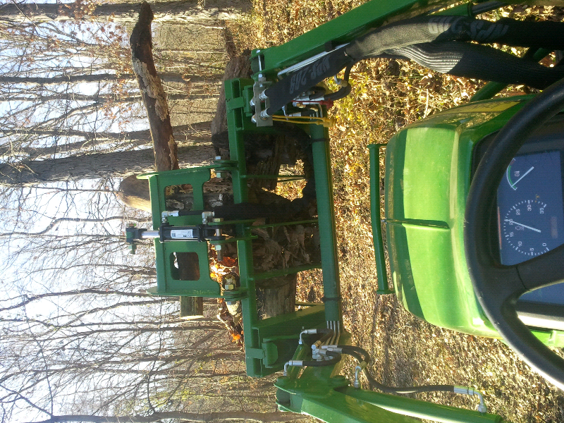

Swick1 I'm looking to adapt a power angle snow plow onto my 2320 with 200CX loader. This Solenoid looks like the way to go to get hydraulics diverted to the power angle cylinder. Is it a 2 way pressure valve? If so I could just divert the bucket curl/dump fluid when needed to change the angle of the blade. That would work great. Or any other advice you may have.
#110

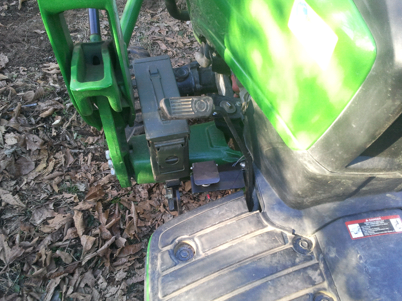

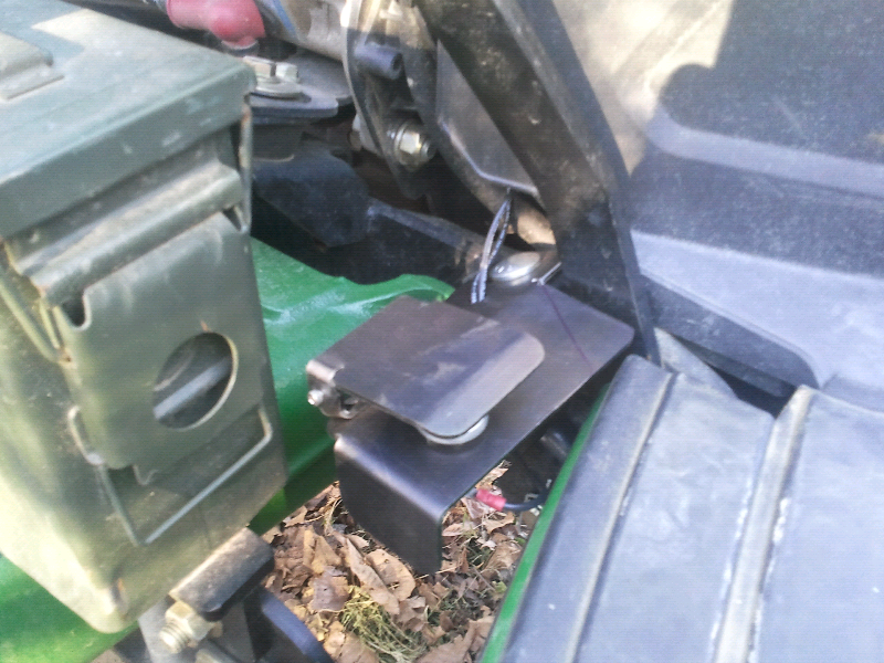

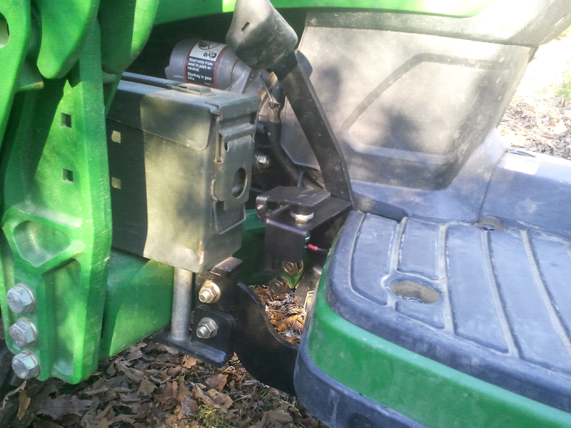

I had the Jd dealer cut the curl hose after I mounted the valve to the loader. They put new ends on it where they cut and hooked it up for me. I installed the two remote hoses myself. I made them out of repair fittings from discount hydraulics.com. they are frontier style disconnects but I would do flat face next time. Jd dealer had the covers for the hydraulic quick disconnects. I installed a foot pedal to switch between controlling bucket curl and the grapple. It works well but I had to make my own bracket to hold the switch. I love my diverter setup. I want to make some more implements that use the hydraulics like a stump puller and a shear / jaw crusher.

Just now seeing your grapple build really nice job! Do you remember what footswitch you used, I am thinking of one for a similar project but hadn't seen one I liked..

Its a sealed remote start switch from autozone/ oreilly auto parts.
   / grapple hydraulic setup 1026r #113
Swick1 do you have any pictures of the solenoid mount? Did you end up mounting it on the loader arm? If so I would guess you have an electrical quick connect for when/if the loader is removed. The starter switch is a good idea.
