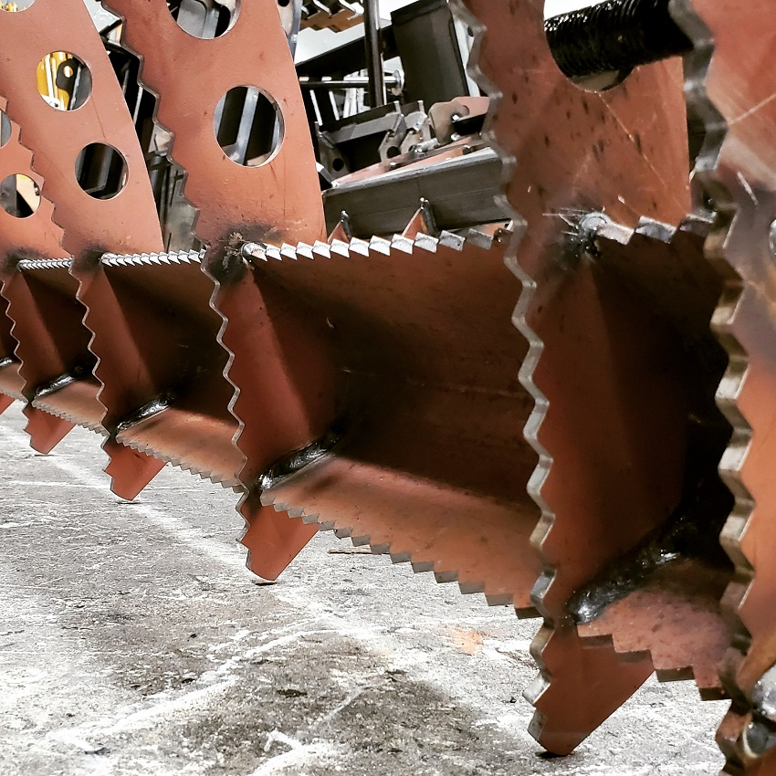

Little things equate to very big things, and EA is all about the little things. Here's a unique feature you'll find on our Wicked 55 and Wicked 60 root rake grapples...
The Wickeder lid, which you may hear mentioned in conversation on social media, has a serrated horizontal channel spanning entirely across the leading portion of the lid, which greatly increases the lid's ability to rake loose material into a pile, or groom and smooth soil for seeding. Raking backwards, even if it is loose material, is something that most other manufacturers do not recommend, which totally defeats a valuable feature in which a true root rake grapple is designed for. WICKED is a TRUE root rake grapple.
Travis

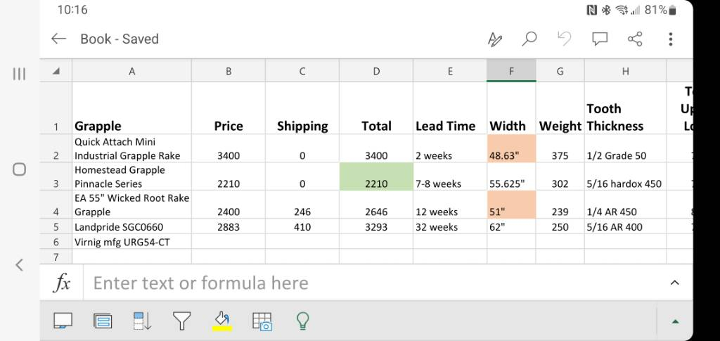

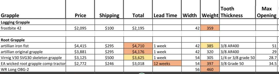

This forum is great! I was leaning towards a QA product (below) and got several recommendations on other products. I am leaning toward Homestead or EA for a grapple for my L3901. Any opinions on these products below? Any recommendations on other brands? Mostly for limb and log ( 25"dbh oak) clean up. These are all claw grapples. Thanks for the help. View attachment 771746
For clarification, Wicked 55 *lid* is 51" wide. The grapple is 55".

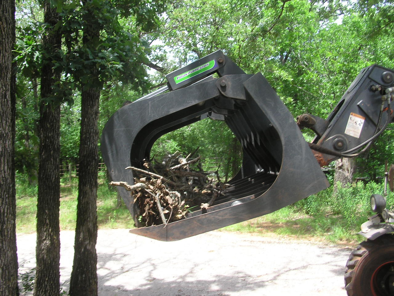

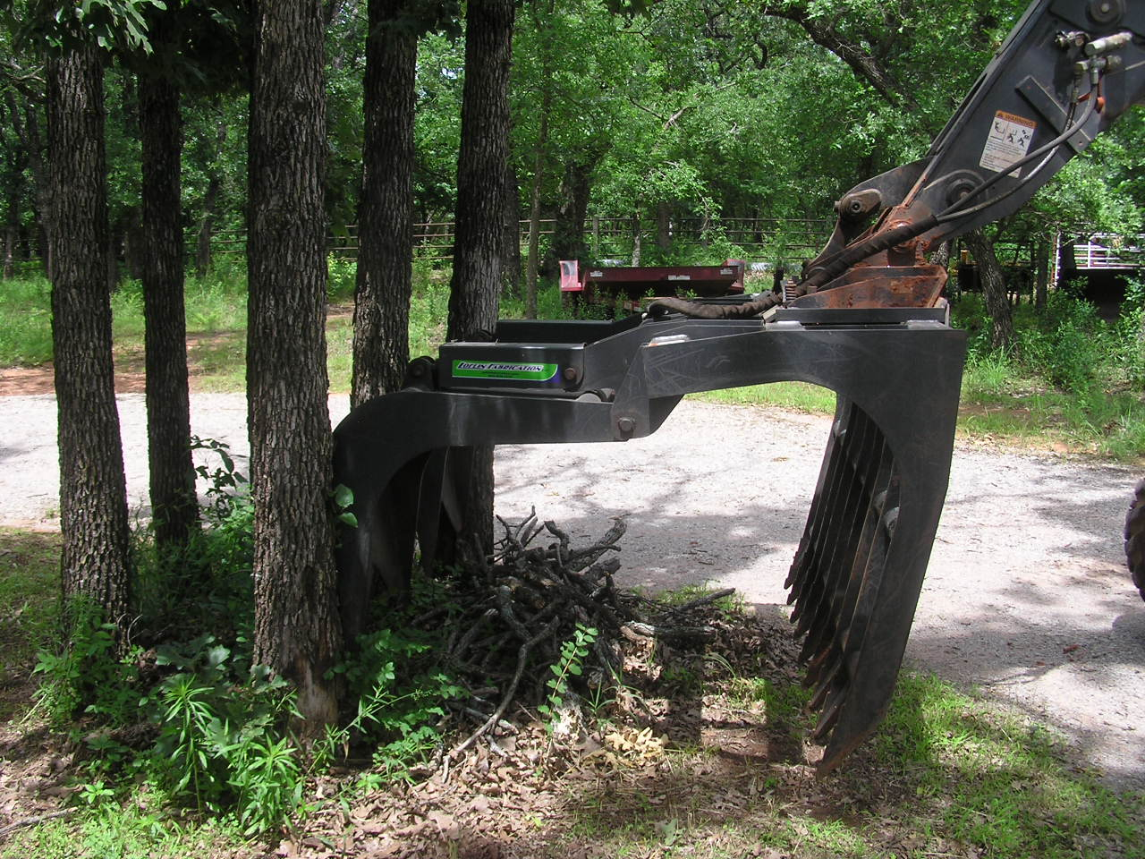

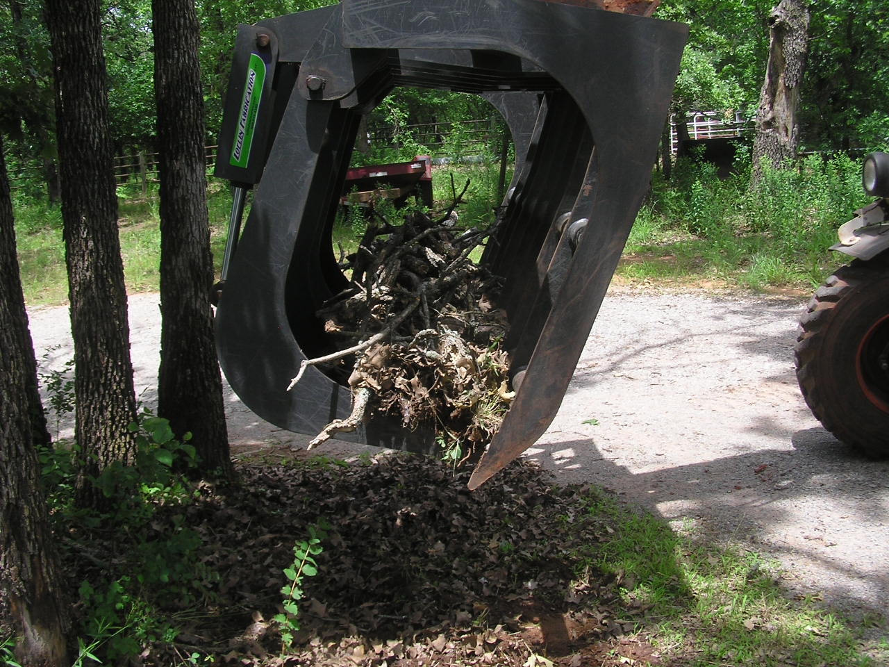

Also looking at a dual lid design with longer tines on the bottom.
I have had both basic styles and that is the best style for my uses here in central Oklahoma.
I can rake with the lids:
