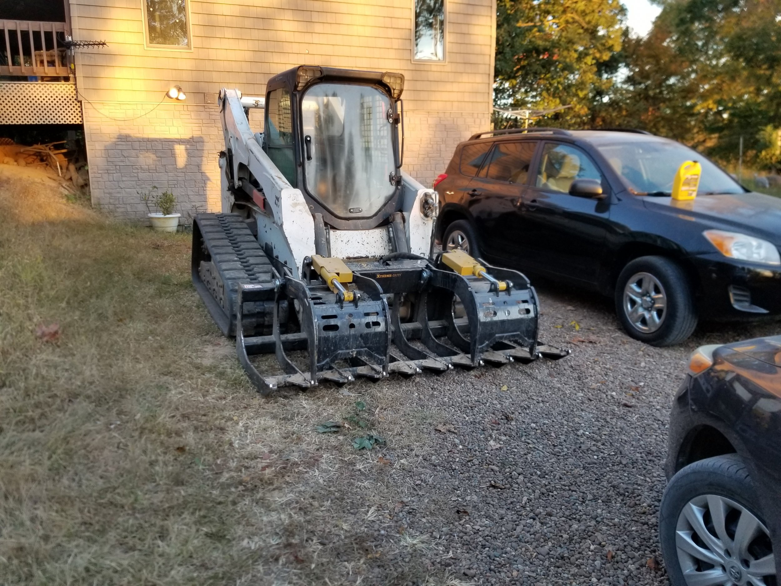

I bought a Construction Attachments Inc grapple for my skid steer, I don't think there is a better made grapple out there. Downside is its expensive with about six week lead time. I bought this one because I wanted something my T870 couldn't tear up. I really like it, very sturdy build, large cylinder, grease points everywhere it can use them.

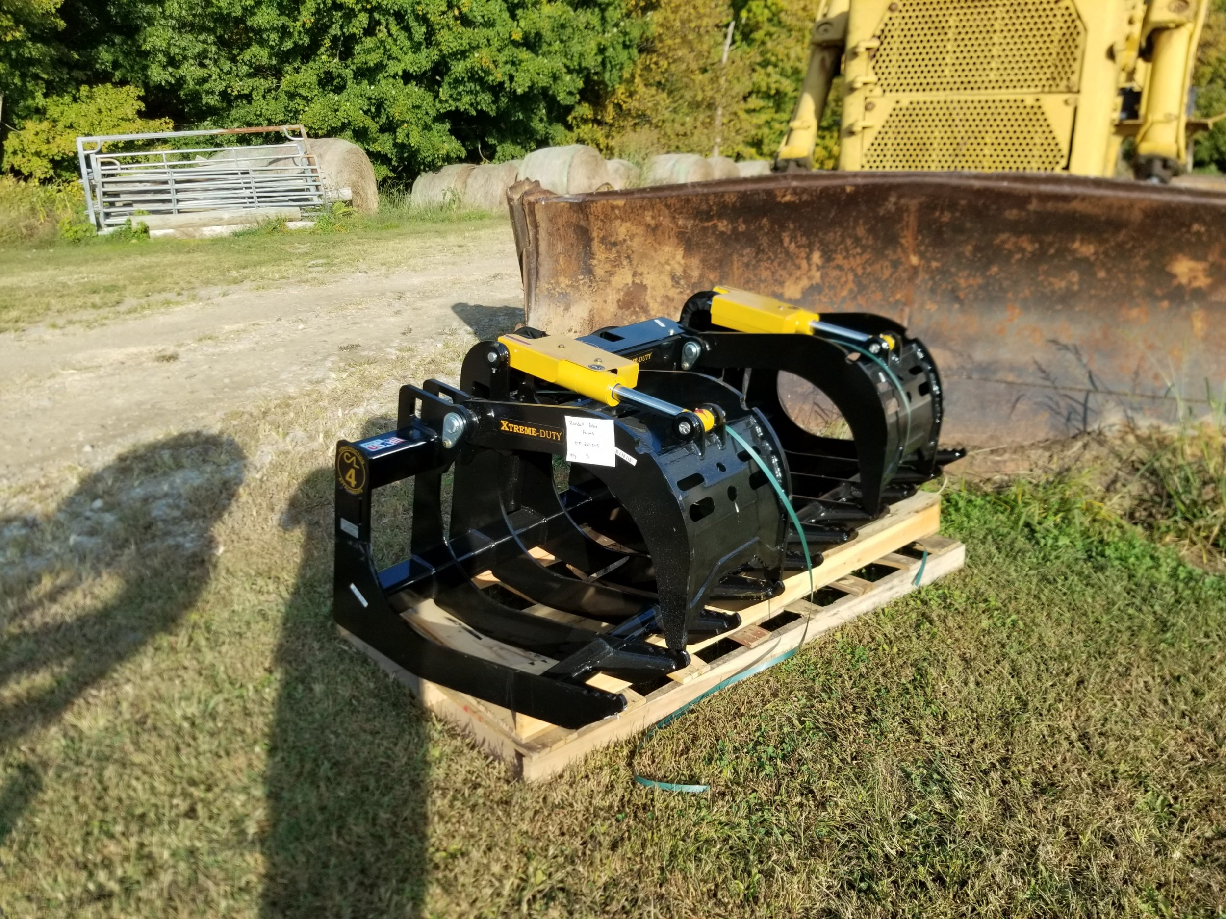

I got a Virnig 54 on a B2301. I have moved quite a few logs and brush piles with good results. Wanted the EA 55 but couldnt wait.
Looks from pic you have a V30 URG54 grapple. How is your B2301 handling the 250 lb grapple and how are you ballasting the back end? I am looking at the same grapple or 60" (300 lb) and appreciate your firsthand experience. Thank you.

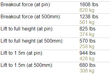

Well, it depends what you're trying to do. If you're trying to load something heavy over the side of a dump trailer it's going to be pathetic. If you are trying to hold something a little above waist height for chainsaw work, or place on an open deck trailer etc, a 1025r could still lift a fairly heavy object to that height even with a 250lb grapple on it. I snipped this from TractorData:
Figure a grapple can hold 'a log' closer to the pins than a bucket can, so you're looking at something between the (at pin) and (at 500mm) numbers. My comfortable chainsaw height is less than 1.5M so you're looking at something between the breakout (ground level) and 1.5m numbers. So to lift a log say 3-4ft off the ground in the grapple, you'd have probably around 1000lbs to play with even considering the grapple weight. My Kubota BF300 loader has a very similar lift to full height spec and i've lifted almost 1200lbs (not counting the bucket!) to unload from a truck bed, for example.
