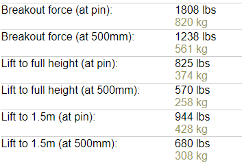

Your loader does not have much lift capacity. Think about that when looking at options.
Not a problem with brush but logs can get heavy. A 16" 12 foot long oak will weigh about 1000 lbs. Your loader can lift about 1200 lbs.
Good point. This is now my number one concern. I have narrowed my purchase down for a long bottom grapple. I am 80% with the Virnig SGV30 CT in 54" or 60" (305/320 pounds) or the EA 54" root grapple. (400 pounds). The Virnig is 1/4" steel and EA is 3/8" steel, grade 50. I think the EA lids are closer to the outsides which I prefer. But at almost 100 pounds difference...that is putting the Virnig up front.

That data is not accurate for my tractor. But the point is well taken. With a compact tractor like the L3901, my lift capacity can be greatly effected by the weight of the grapple. I have a midsota 14" dump that I need to dump over the sides. So getting stuff up to a decent height is a valid consideration.
