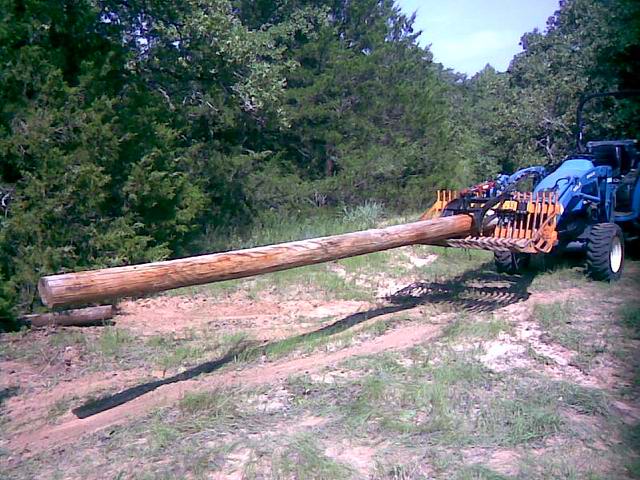

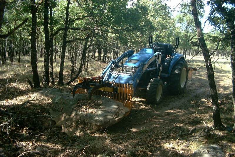

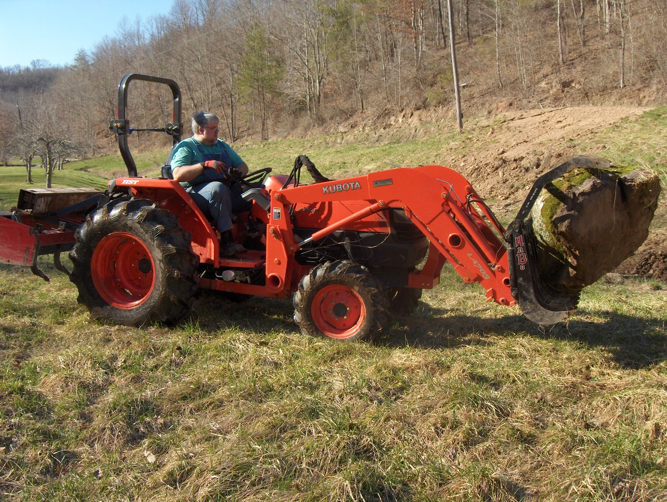

Hey Jim...what do you think that rock weighed?
My guess is about 1500 lb. I could curl the bucket enough to just get the rock clear of the ground, but there was no way for me to lift it. With the grapple/bucket weight of 750 lb, the rock far exceeded my lift capacity of 1600# to 1700#, but I had enough breakout force to just tip it up so that I didn't have to drag it on it's bottom for the 1/4 mile move to my yard. A big rock like that is just like having something heavy on the tips of forks. It rapidly overpowers a loader. If the weight is centered over the pins on the loader arms, it's much easier to lift. BTW, it was a soft limestone rock and not too dense/heavy. Had it been granite, I would probably still be struggling with it.:laughing:

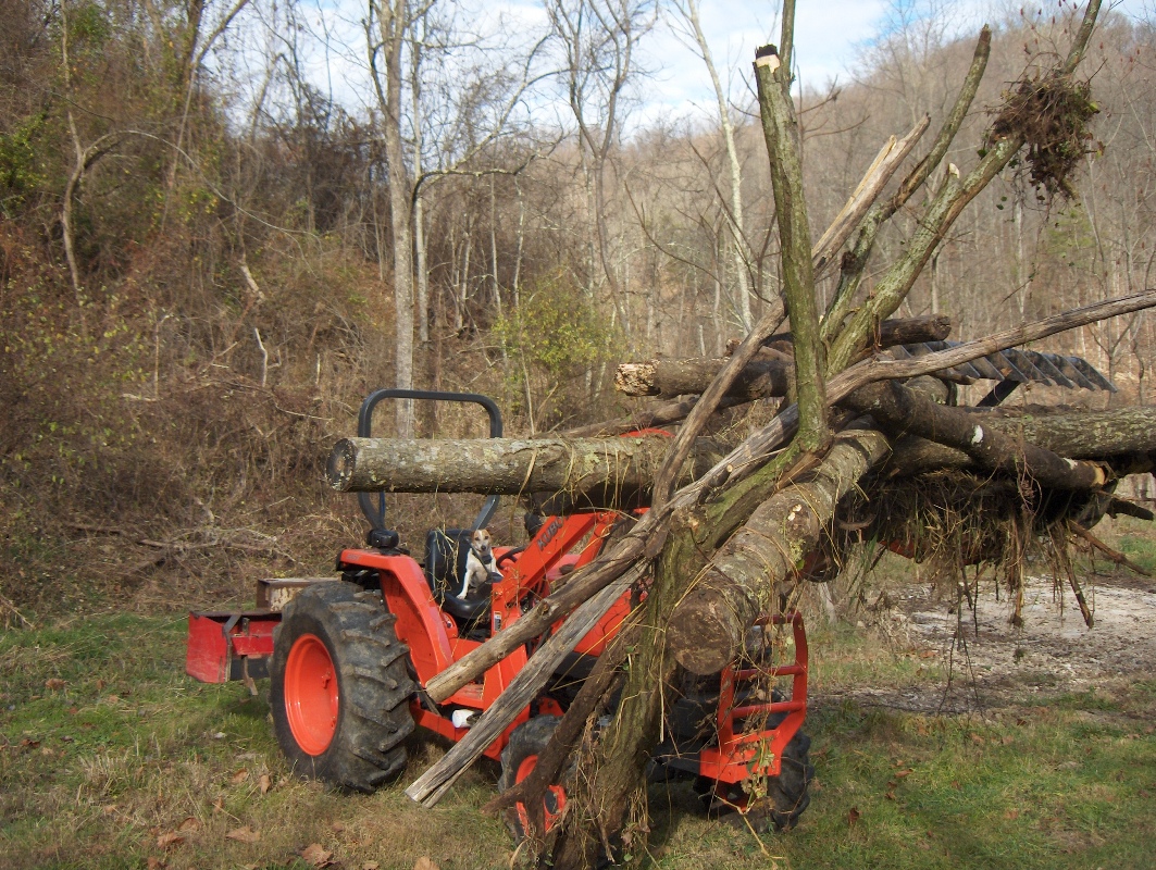

Here on TBN Grapple Land I do not have a Markham I bought a Anbo grapple rake and I love it. Now dont get me wrong Markham is about the best deal going on a new grapple. I got a good used price on the Anbo and it and it is a 66" wide and the cylinders are in the back and protected. I have it on a L4400HST and I will say it works well but if I were to buy it new I would get the narrower width for the reasons already stated. Here is a few pics for a look see. Each style has their merits and I like the ability to tilt the rake forward and pull the brush back into a pile. I cant lay thing in the bottom tines like a flat bottom Markham. The Anbo is made out of AR steel and only weighs about 400# and that fits well with the LA703A loader.

Ha, looks like your little buddy there is enjoying the seat-time fun!
edit: Just saw your other thread about how he hops up there so much, heh.
/ Grapple width #35
That Jack my Jack Russel Terrier, he thinks the tractor is his and he just shares it with me. He has free run of the garage and the tractor is his perch that just so happens to cut brush and such.:)
