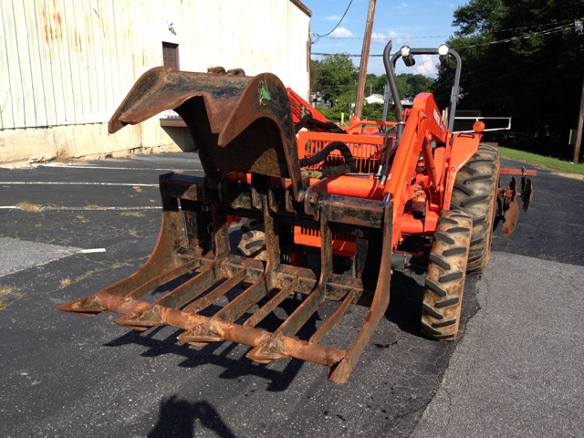

I'm purchasing a new grapple for my Kubota MX5800 for moving logs & brush. I'm prob. going w/ the dual lid EA Wicked Root Grapple V 2.0 What width would you recommend - 60" 66" or 72"?
/ Grapple width? #2
This has been discussed many times. My opinion is based on my extensive use of my grapple on my M6800. I would go narrow, and a single lid is plenty. I use mine very frequently for uprooting trees, scrub bushes, etc. as well as cleaning up fallen trees, chain saw debris, moving large logs. Mine is about 48” wide. I can easily push down a tree up to 8” diameter, then plunge under it to up root it. I do this a lot. A wider grapple, although good for scooping up limbs, isn’t focused enough to dig. Whereas my narrow grapple with a single lid still works great for scooping up and carrying debris. I can gather piles way bigger than I can see around, and the single lid clamps everything down just fine. A narrow grapple is more precise and can focus the power much more effectively, especially when uprooting trees and brush.
That being said, a wide grapple certainly works for scraping up brush, but so does mine. Scooping up cut limbs or logs is simple with either, both narrow or wide. But clearing land of saplings, bushes, privet, or digging up a root ball, the narrow wins every time. IMG_0671.JPG

I have no "junk" brush on my 80 acres. So I went with a very heavy duty Land Pride. Its a rock & root grapple - 60" wide, single lid. I've had it for over five years and its worked out just great.
BTW - consider modifying your grill guard to protect your grill, radiator & battery.
View attachment 592692View attachment 592695
