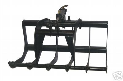

To bend the tines all in one direction must have involved a lateral force. Grapples are designed for up and down straight on forces and not for either twisting or lateral forces. In looking at the LD48 Markham compared to my LD48 Millonzi, I notice a few differences that might make the Markham a tad less resistant to a lateral force. First, the Millonzi has six tines whereas the Markham as only 5. Also, the Markham tines are built like an "L" which means there is a pretty long stretch of the tine that is supported only by the elbow of the L all the way at the back of the tine. A lateral force at the tip of the grapple would put a lot of leverage on that vulnerable elbow area. The Millonzi has a more cupped tine design with thicker (taller, both grapples are 3/8 mild steel) root at the corner. I don't know if that makes a difference but intuitively it seems like it would offer more resistance to lateral force. See photos (Millonzi on ends, Markham in middle).
Still, it seems most likely that an inadvertent lateral or twisting force was applied to the grapple. I've never seen a story on TBN of a grapple breaking or being damaged by straight on or up and down forces.
Again, I am not an engineer but I did spend the night in a Holiday Inn Express.:eek:
