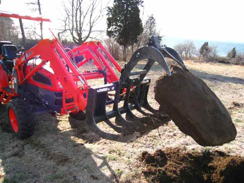

I was not even an amateur auto mechanic much less knowledgable about hydraulics or tractor attachments when I purchased a light duty grapple and then figured out how to get it attached and powered. TBN resources are great for this task and you should not worry about whether you can do that. You will need to make some basic decisions about where you want the hydraulic power to come from (remotes vs valves) and you can read for weeks on TBN about the various considerations. Your tractor dealer can easily get things on the new tractor set up once you decide how you want it done (really a budget issue more than anything else if you want my interpretation of the various options). Connecting the last few hoses is duck soup and again there will be plenty of help via TBN. I think I (and many others here) could talk a blind nun through that part. Bottom line: don't be scared of hydraulics, the knowledge you need to attach a grapple is pretty easy to handle for a novice.
Regarding attachment of the grapple you really just need to decide if you want a standard "Bobcat/skidsteer" adapter on your tractor (I assume that is a JD option) or just ask Markham to build you a JD quickattach mount grapple.
Regarding the grapple, I would suggest you save money and just get the 48 inch standard duty version. I have an even lighter duty 48 inch grapple from a now extinct company (Millonzi) which has stood up to serious abuse over the past three years with a tractor/loader (Kioti DK40se/KL401) that is about the same power/weight as what you are purchasing. Use the grapple correctly and it will easily stand up to whatever your loader is capable of.
