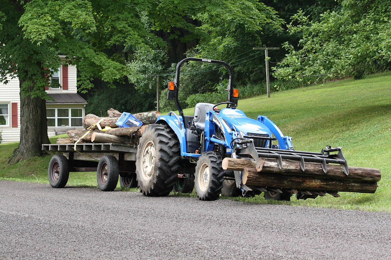

I have a WR Long RBG2-60 grapple for use on a Kubota L4310. Not a lot of use, but it's very handy for moving small boulders ~ limit 1,200 lb. Brush gathering is good, log loading - less so.
I expected the holding power to be greater, but the upper arm doesn't have a lot of holding power - could be redesigned, IMO. I also looked at an ANBO, but couldn't justify the price extra.
I have this same grapple and 95% of its use has been loading logs and my experience with it has been excellent for this task. If you don't keep the rpm up it will lack power but that is normal.
As you see with the attached photo I stack logs onto an old hay wagon then grasp about three or four (depending on the size) in the grapple and drive them about a quarter mile up the road before unloading them. I can stack and unload from the wagon one at a time and not damage the wood wagon bed.
