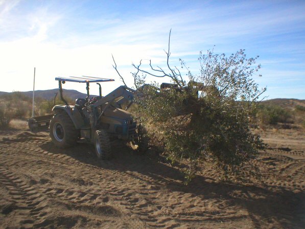

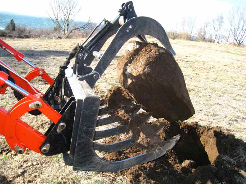

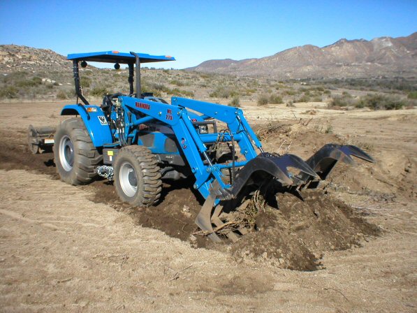

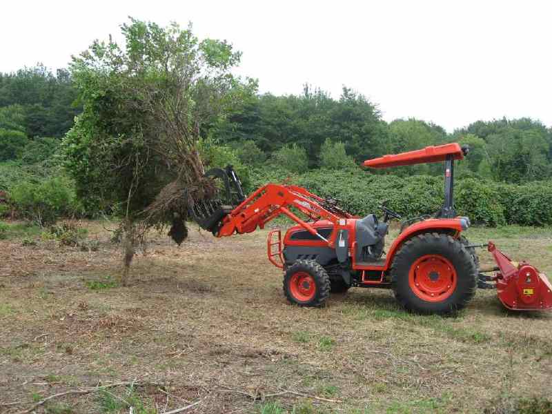

Just my 2 cents worth here, but I have a little bit bigger tractor than most here at TBN and I use the Skid Steer loader Root Grapple Heavy Duty. Have had no problems with it. Very reasonably priced and will take a beating. In the 1st pic, I am sifting through the dirt with the front edge of the grapple about 6-8 inches in the ground, and as you can see, I also use it for moving bushes like a lot of others do also. Check them out before you buy. ;)
Good luck with what ever you get.

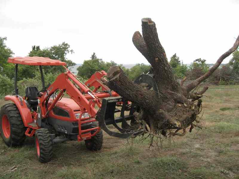

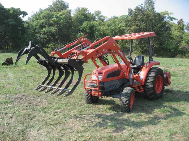

That is why I pointed you to Markham. The other manufacturers of what are sometimes called "light duty" grapples like Long and Millonzi (RIP:() make (made) similar open bottom grapples in the 48 inch size that work very well with CUTs. The open bottom grapples are apparently much easier to manufacture so are always less money than the clam shell type (you are calling them root rakes but that term is used for both styles). The clamshells are also almost always heavier (not a good thing generally) for a given size.

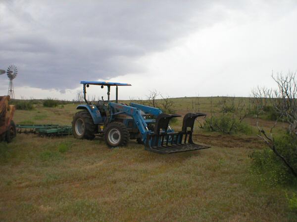

One general bit of advice: be careful not to confuse grapples intended for commercial use on big skidsteers with what would work best on a CUT. Even your 42hp tractor with 852kg lift at mid bucket is light duty compared to what the skidsteer grapples are designed to handle. Again, my 41hp Kioti DK40se has over 2700lbs lift at PP and the Millonzi 48 inch "light duty" grapple has no complaints. I lift the rear of the tractor with ballast off the ground routinely trying to pry out stumps and the grapple shrugs it off.
