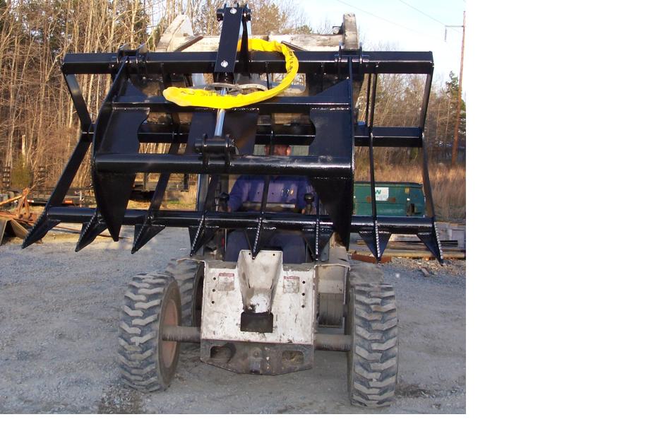

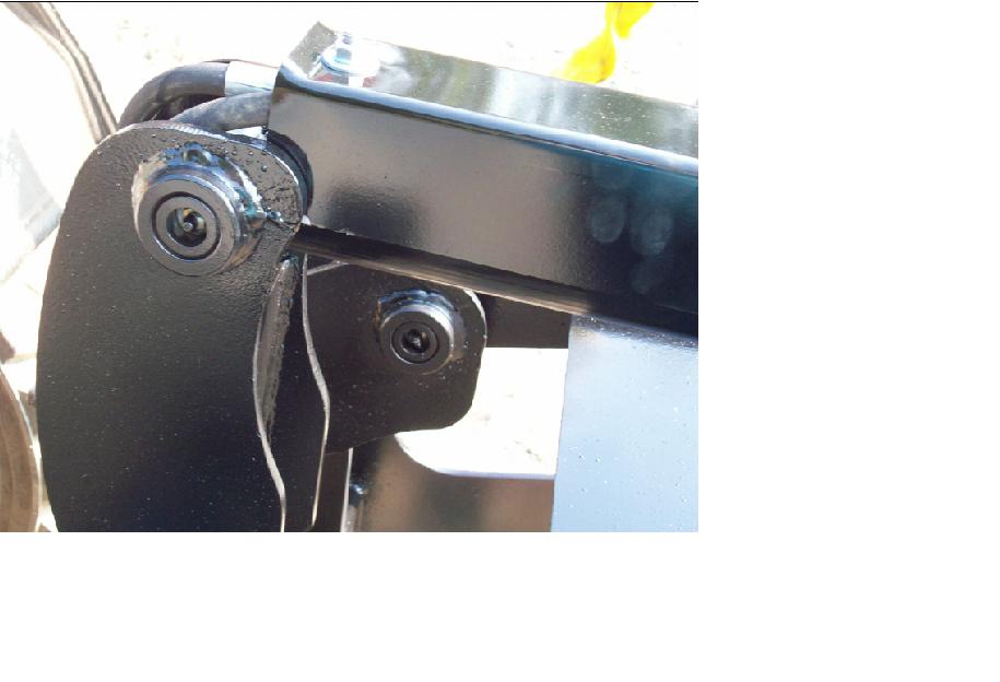

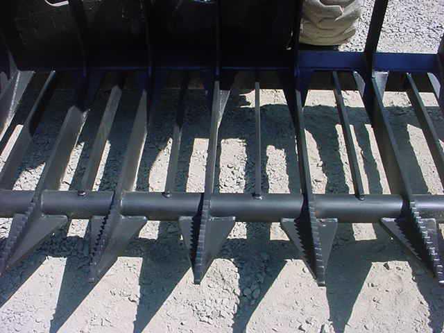

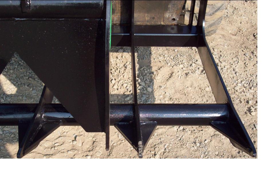

Thought I'd post some pictures (or at least I hope I will) of the Markham Light weight grapple. I hope this helps some of you to get a picture fix.
This is of the single tine unit. The single tine is about 30" wide as I remember from my conversation with Mrs. Markham. They will also make this with two narrower top tines of about 15 or 16" in width. They will also add extra spacers, as you can see in one of the pictures. The spacers cut the gap between the tines from 9" to 4.5". While I ordered the 60" unit they also make a 48" unit. Their prices were great.
I check multiple dealers for the WR Long unit and each had a different price for the 56" unit which has two top tines. All the costs I received were greater than Markham's.

Make sure they dont use Skid Steer style Quick Disconnect, but Agricultural. Unless your tractor has the SS style QD's.
