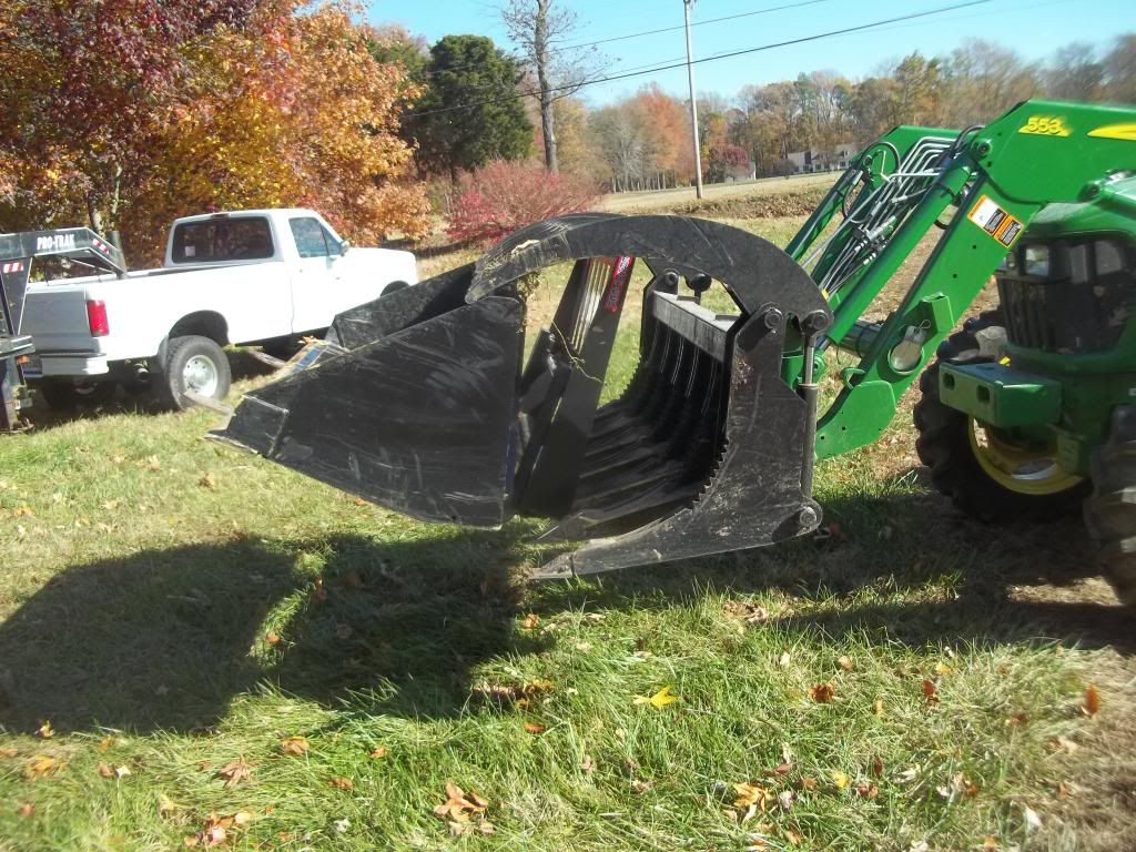

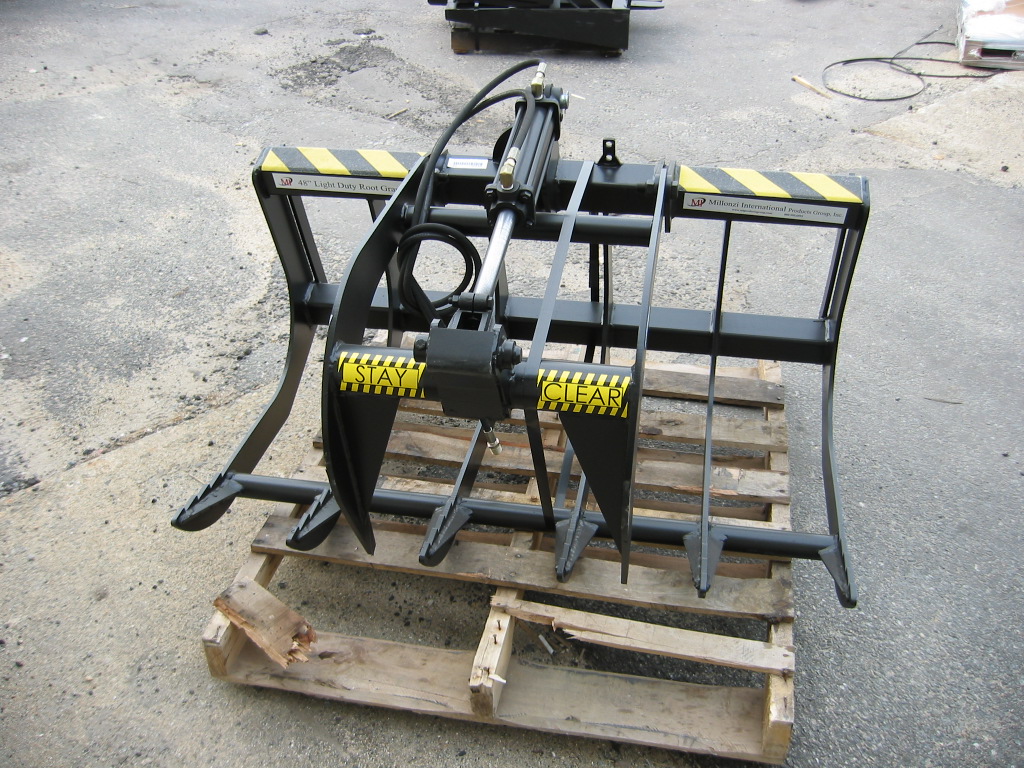

I have a 3rd function valve on its way to me, Should be installed by next weekend. Now the hunt for a grapple is on. My use will be primarily moving brush and downed trees under 9" diameter. I have numerous buckets and have looked at the weld on or bolt on thumbs. Also looked at Tomahawk brands that seem to be light duty builds. I think I would like a skeleton bucket with its own grapple but they ate spendy. My tractor is a L3700 SU. Any suggestions would be appreciated.
My tractor is bigger than yours and has a more powerful loader. I am perfectly happy with a 48" single lid light duty grapple. Right now the nicest such grapple IMO is made by Everything Attachments, they call it their 50" for compact tractors and it is the smallest they make. I think it is the same one Koua has and his tractor is about the same size as yours. It isn't the cheapest one out there and companies like Titan make something similar but less carefully engineered for less. Just make sure that the structural tubing is 0.25" thick as some cheapo grapples are made with 0.125 thick wall and that is prone to failure.

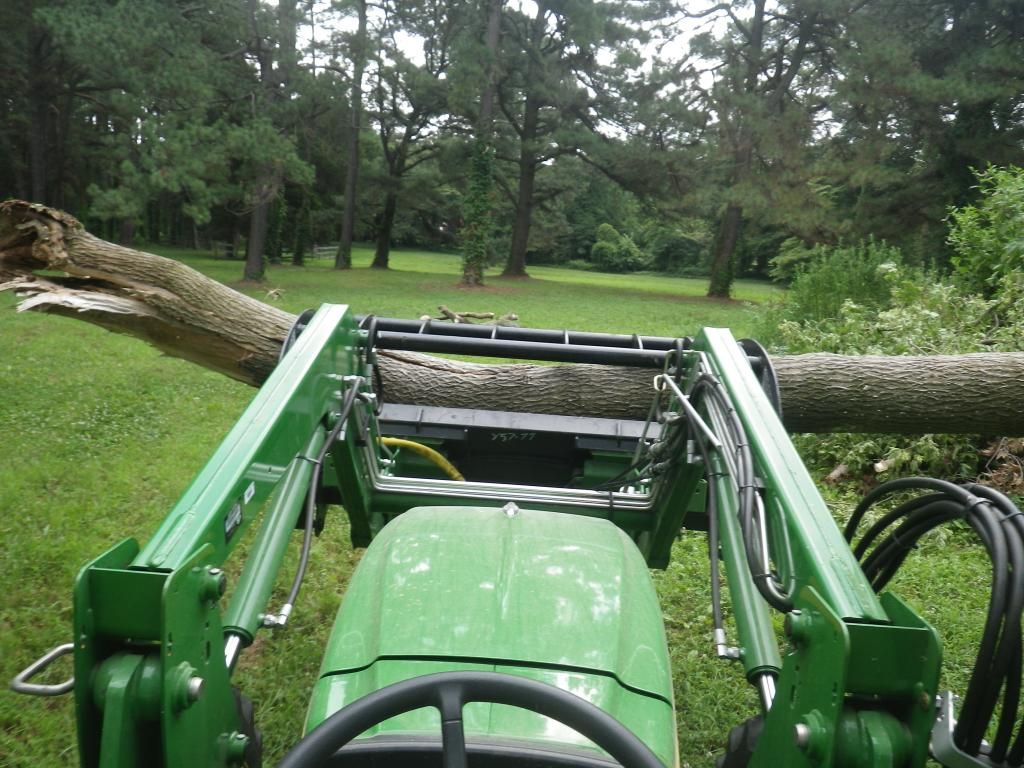

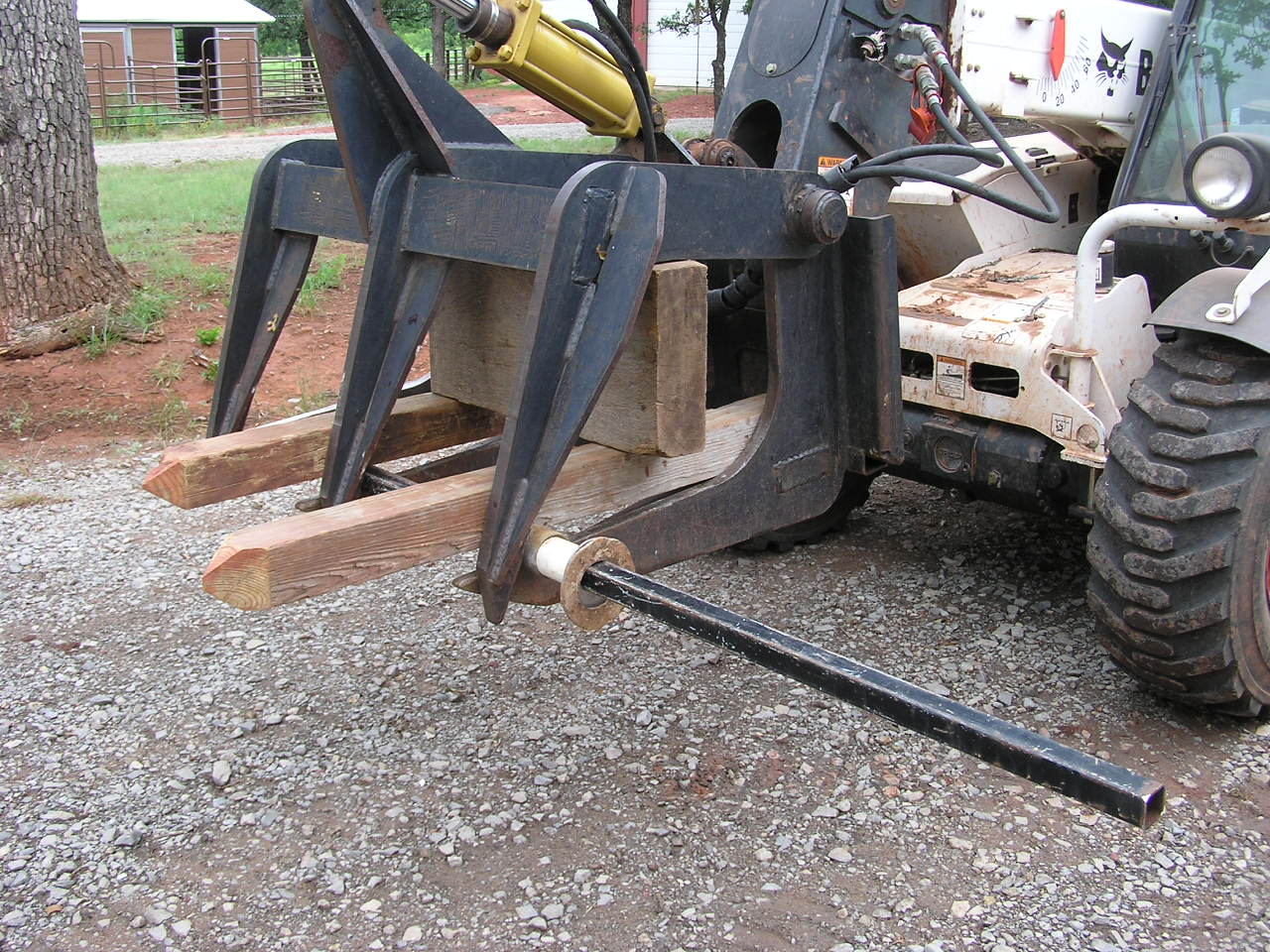

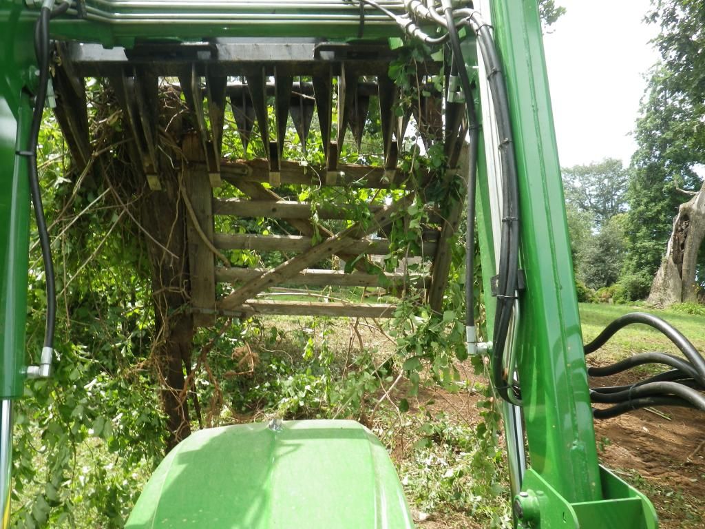

As I noted earlier, I have used both rear remotes and a diverter valve. I'd personally not use the diverter again. Not so much because it doesn't work (it does) but because it simply isn't a $500-600 improvement over simply using the rear remotes. I'd rather have an extra implement for that money.
If I were rolling in dough, I would consider the third function valve as a convenience but again, I might decide that it isn't worth two extra implements.
If you can drive a 4 on the floor, use the rear remotes so long as on your tractor the lever is in a handy position to drop your hand to from the FEL joystick. If you must have a button to push, I'd suggest pondering what other tractor toys you could add for the $800-1000 that a third function will cost you and then decide.

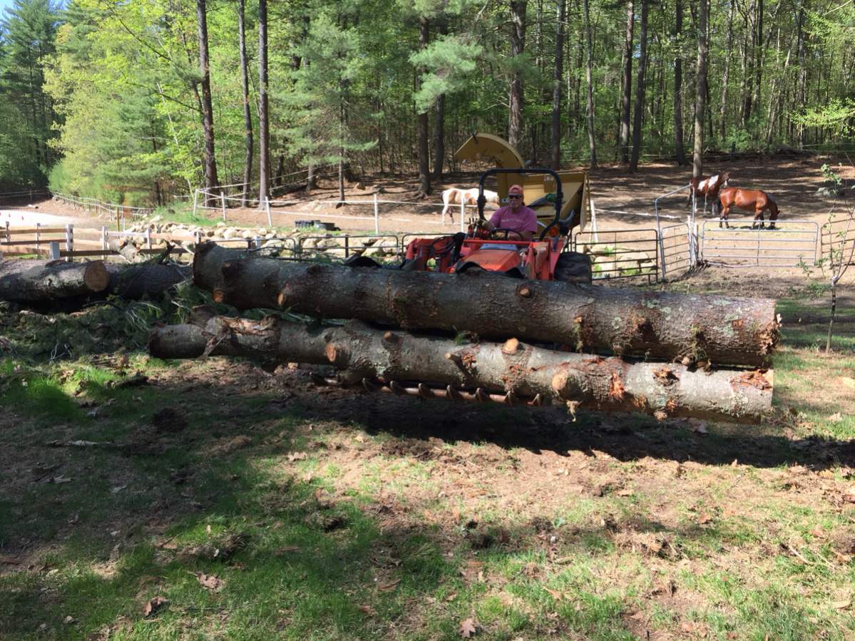

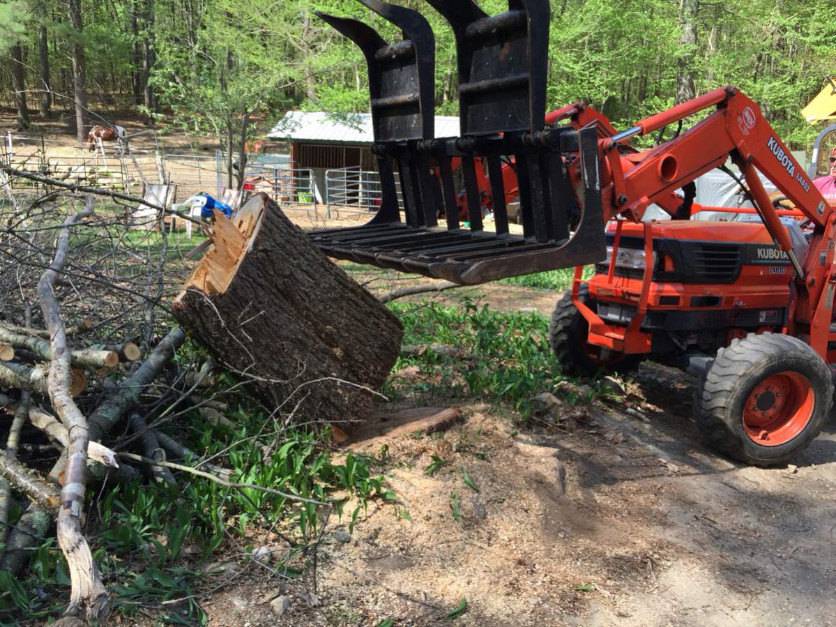

Here are some of the extra implements I have that could have been spent on a fancy valve. Tree boom, forks and ripper tooth for my BH. Each one has saved me WAY more time than any button on a joystick.

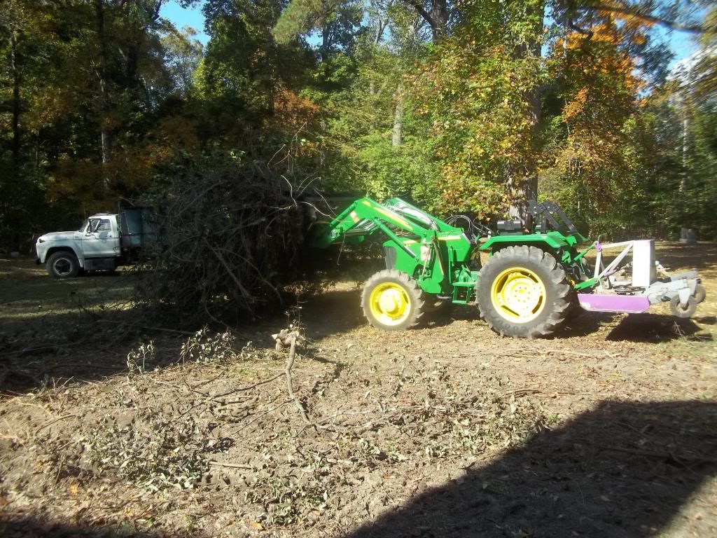

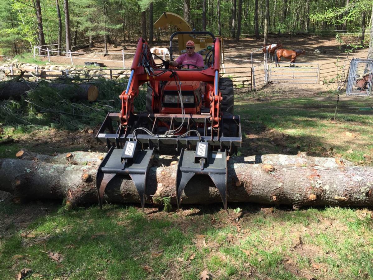

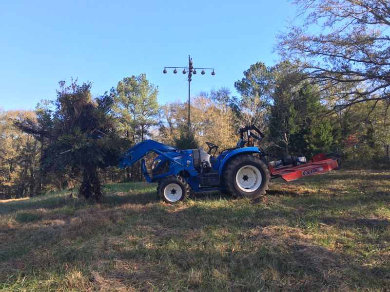

Got in a little seat time moving around some brush piles today :)
/ Grappling fun - A Picture Thread.... #515

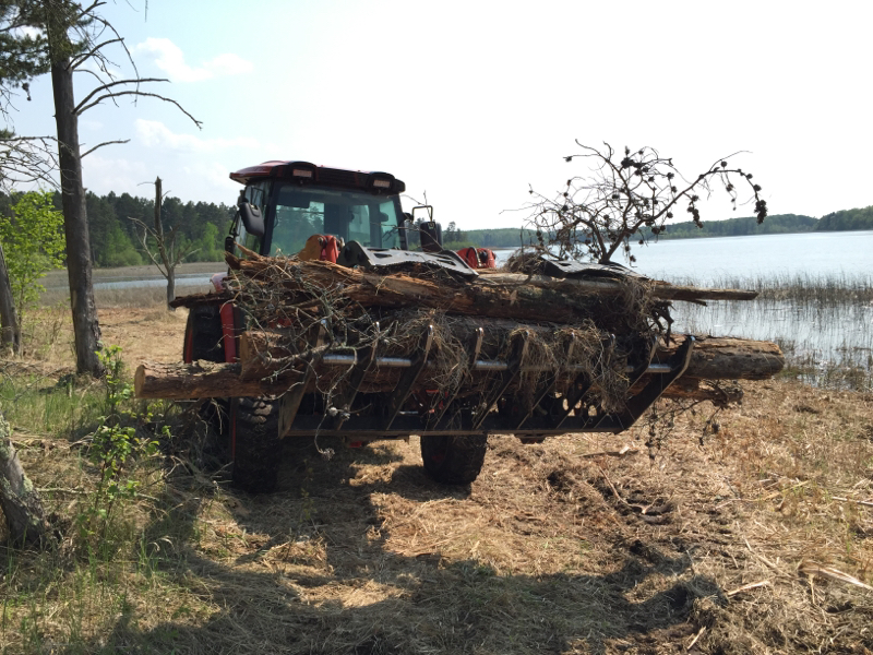

<img src="http://www.tractorbynet.com/forums/files/attachments/448594-grappling-fun-picture-thread-image-3137597-jpg"/>
Fine to lift that high when static but lower that load before moving. Hit a bad hole while moving and you could go over with the load that high.
A big load of brush can easily interfere with vision when driving. When driving in a field, I tend to stop every hundred feet or so, raise the load, check what's ahead then lower and drive a bit more.

Had it lifted for photographic effect only.. :p
