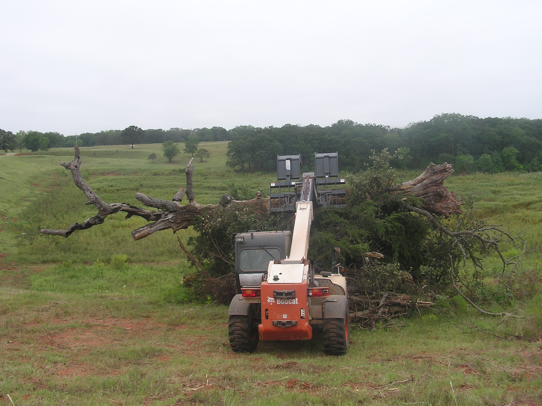

A big load of brush can easily interfere with vision when driving. When driving in a field, I tend to stop every hundred feet or so, raise the load, check what's ahead then lower and drive a bit more.
I often drive backwards with big loads, for the reason you mention plus so that any trailing limbs hanging down don't get under the wheels and pull the load out of the grapple.

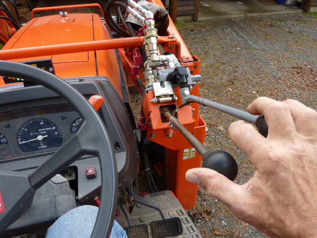

yep, makes sense, thanks. so the only issue would be the constant switching back and forth. I can see where it would be nice to have dump/curl available all the time like setting a log on a mill or something. now to figure out the cost difference...
If you can do some basic plumbing you can add a diverter or third function valve yourself instead of buying an expensive kit.
I added a manual (vs electric) third function valve in 2011 for about $250 total. So I have one control for the FEL and one for the grapple. Both are active all the time and controllable with one hand.
Edit: Before I added the valve I ran the grapple off of one of the rear remotes which worked fine. But I wanted to free up the rear remote for a TnT cylinder.

Even with 11gpm, I don't have enough flow to do two moves with any kind of speed unless I jack the throttle way up and even then it's not fast enough to think I'd be better off with a 3rd valve vs the diverter. We're talking tractors, not skidsteers that have ample flow for dynamic loader moves. True third function sounds great on paper, but the real world is another matter.

Before I added the valve I ran the grapple off of one of the rear remotes which worked fine. But I wanted to free up the rear remote for a TnT cylinder. gg
Good point Gordon. That would certainly be the number one disadvantage to using the the rear remote.
I added 4 rear remotes to my tractor thinking that way I would always have one extra, even if using top and tilt.
Now, I often have them all in use, and at times need to disconnect the side link to free up that port.
I could use 6 if I had them.

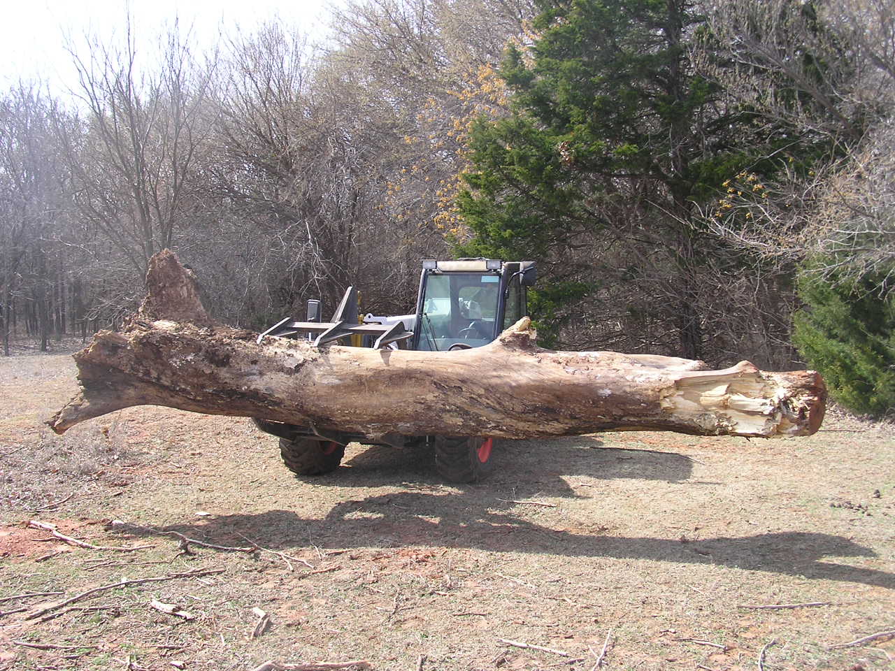

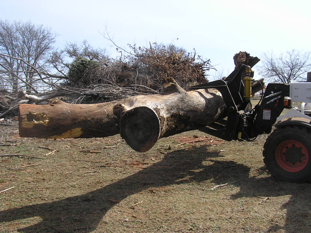

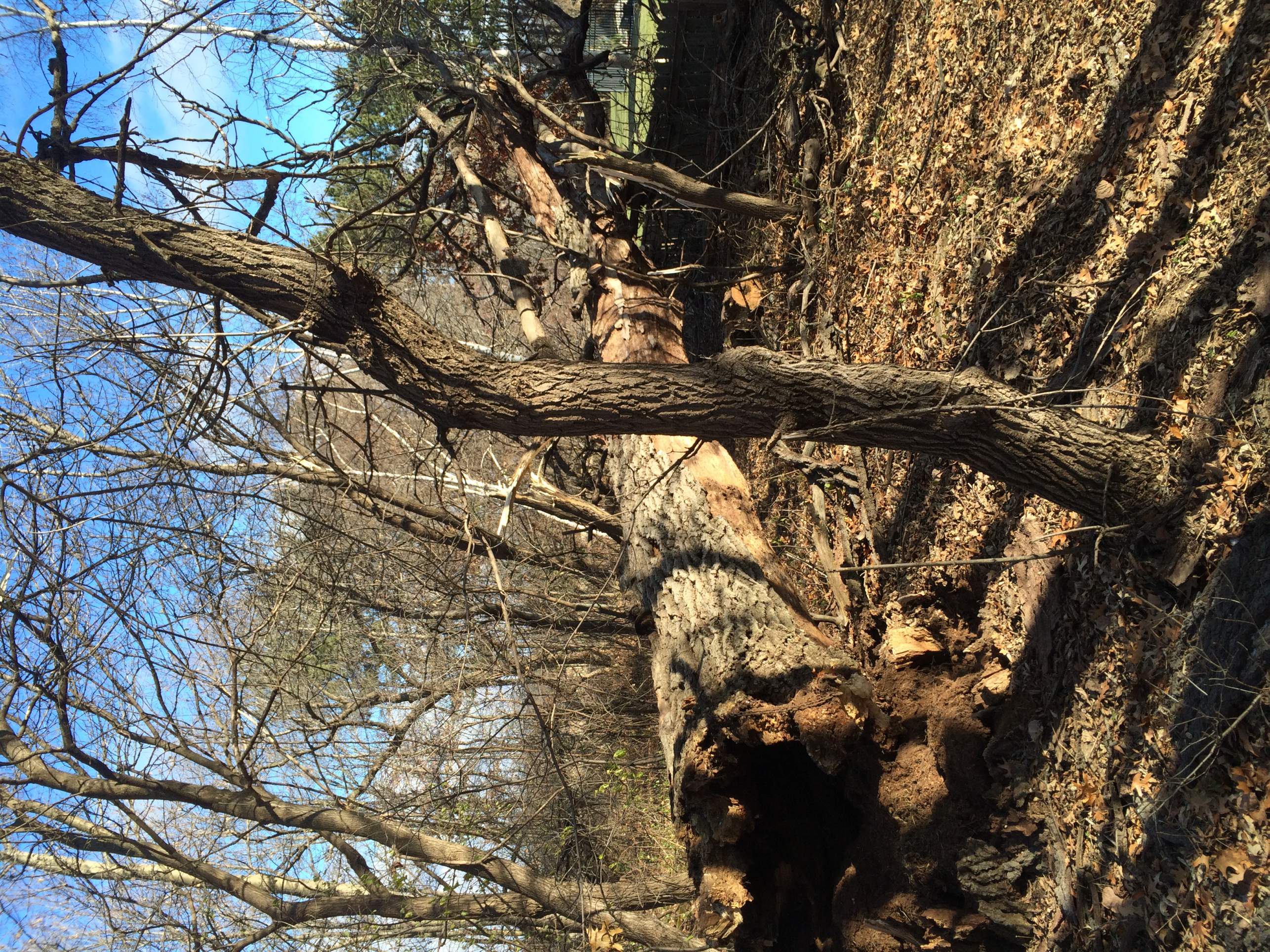

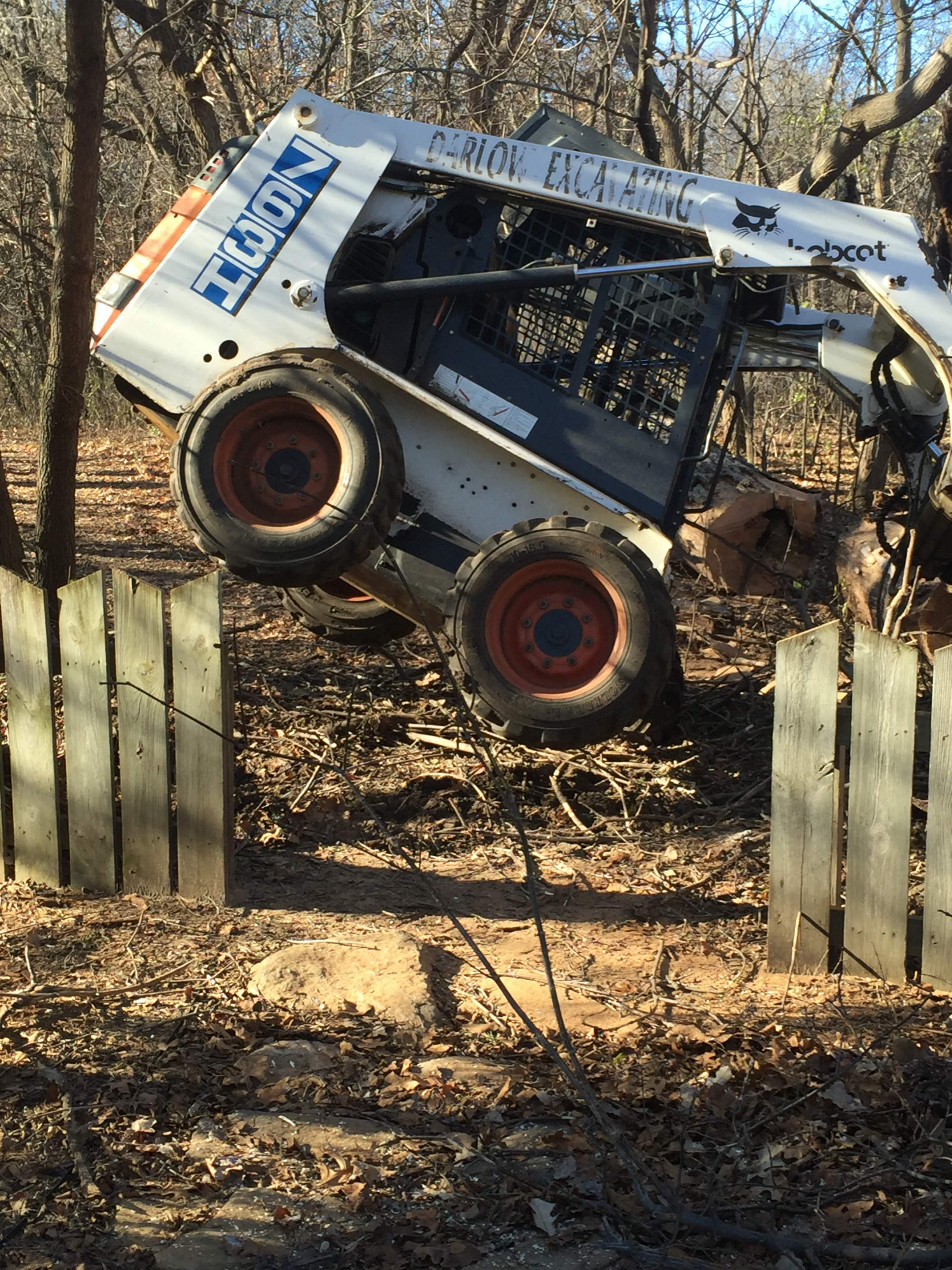

What happens when you try and pick up a tree that is too heavy.
/ Grappling fun - A Picture Thread.... #537
WHAT the ……..:laughing:
Is the front left tire of that machine on the ground? Looks like one of those "here, hold my beer and watch this" deals.
LOL! Yes, the front left tire is the only one on the ground. It was a huge tree and it was straddling a fence that I didn't want destroyed. I was trying to hold the tree in the air before I cut the limbs that were taking the weight of the tree. I was hoping the skid would keep the tree from dropping. Well, the tree was too heavy! LOL!
/ Grappling fun - A Picture Thread.... #539
Haven't found one too heavy. It would have to weigh over 4500 pounds. >
This one would have been close. Over 40 inches on the both ends and 11 feet long.
