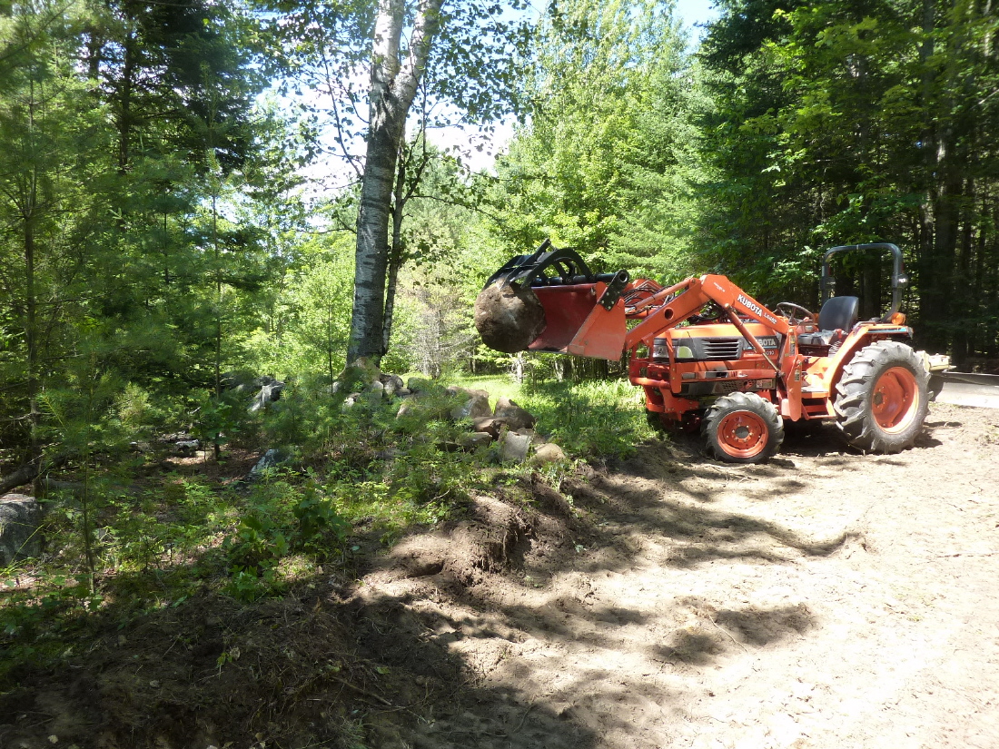

I understand how you load the first round but doesn't it fall out when you open the dual lids to load the second round??---------------------
I loaded 4 rocks with the dual lid and only got out of the cab to take pictures:
Drove under the first two.
Side view, first two.
Drove around to get #3.
Extended the boom.
Closed the lids and picked it up.
Curled up and opened the lids.
Curled down, opened the lids and extended the boom some more.
Lids down and curl up with #4.
Took them to the rock pile.

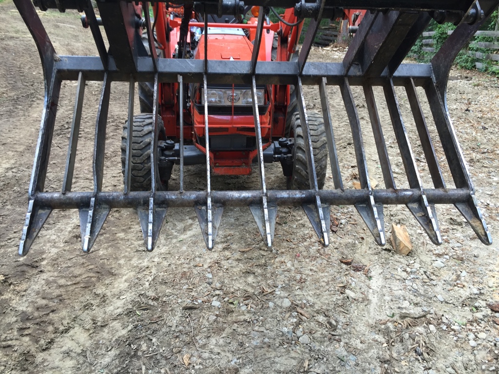

That's what I had an issue with, the firewood splits falling between the 9" time spacing.
I pick up grapple loads of split wood to move them, sometimes loose but when I'm carrying it a long ways I'll take the time to stack it on.
I welded more tines onto my grapple because of the falling firewood, and now it's very rare that I
Lose a piece. I ran out of flat bar so didn't do the middle yet.
I can fit quite a bit of firewood on there when I take the time to stack it, and I stack it high using the grapple lids as support.
I may have to add some tines to mine. It would be nice to have them removable like the light duty EA grapple.
