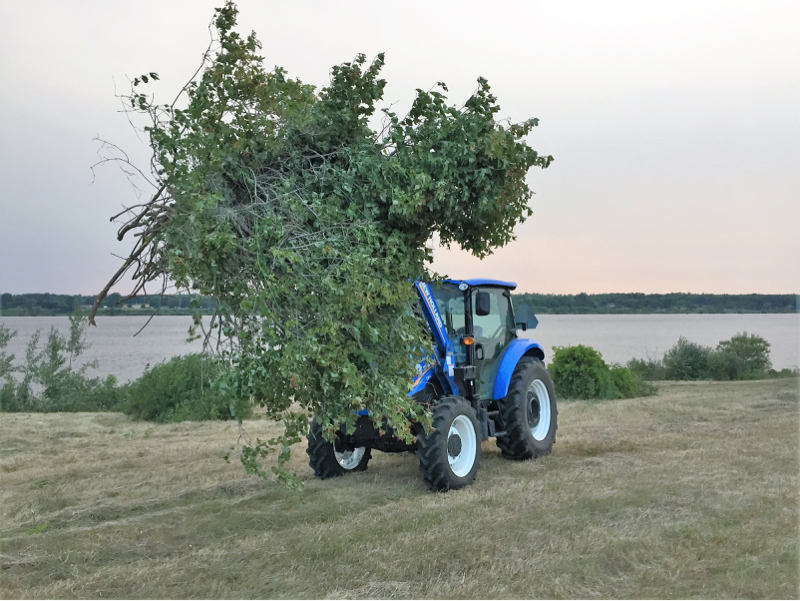

Trimmed the trees and tore up some brush. What a difference a grapple makes.

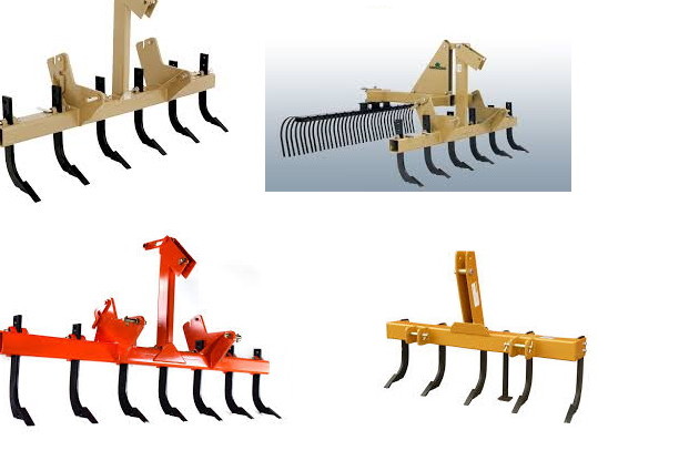

This is what comes to mind for a CUT rear attachment for getting roots out of the ground.

Interesting. Not a very common implement. I guess I would just use my box blade with tines extended and without the main blade in contact with the soil to do the same thing. That or just use a root grapple. I am having a hard time envisioning a large area with surface roots that need ripping out. I certainly have fields where I know there are briar roots etc under the turf but I deal with them by mowing regularly so they eventually die off. Trouble with trying to rip out the roots is that if you leave just a fragment of root behind some plants will just regrow anyways.

The difference between those and a box blade is the scarifiers can go much deeper, if your tractor can pull it.
I like the one with the piggyback rake, if you can use either one by adjusting the top link instead of having to change implements.
