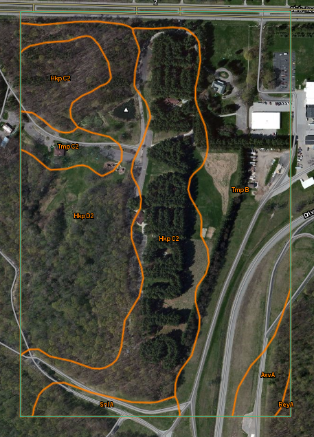

Moss you and I are in the same County. WHere do I get this map?
I was given a book by a friend of mine that is a forester. He's the one that reforested our property. Very handy.
Today, its all on line.
First, go here:
Web Soil Survey - Home
Click the big, green START WSS button.
On the Area Of Interest tab (AOI), find your piece of property.
On the toolbar you'll see two AOI buttons. Ones for making a rectangle, the other is for making a polygon. Choose one of those buttons and draw a box or polygon around your property.
Once you've defined your Area Of Interest, click the tab at the top labeled SOIL MAP and there you go! It should show all the soil types in your AOI.
For example, I'm sure you're familiar with this local area.... :laughing:

Then there'll be a legend to the left describing the soil types in your AOI like this...

I will say, though, that this electronic map does not match my old book. While the defined areas are very similar, the soil types for my property in the book are tyner, fox (the one with the gravel), and adrian muck, while this electronic map shows mine as coloma, oshtemo, gilford, tracy, and antung. The book told me the fox area would have gravel right under it, and it did. This electronic version says the gravel will be at least 48" down, and its more like just below the topsoil.
Anyhow..... its still a great resource for anyone in the country to use. If in doubt, dig a test hole. :)
