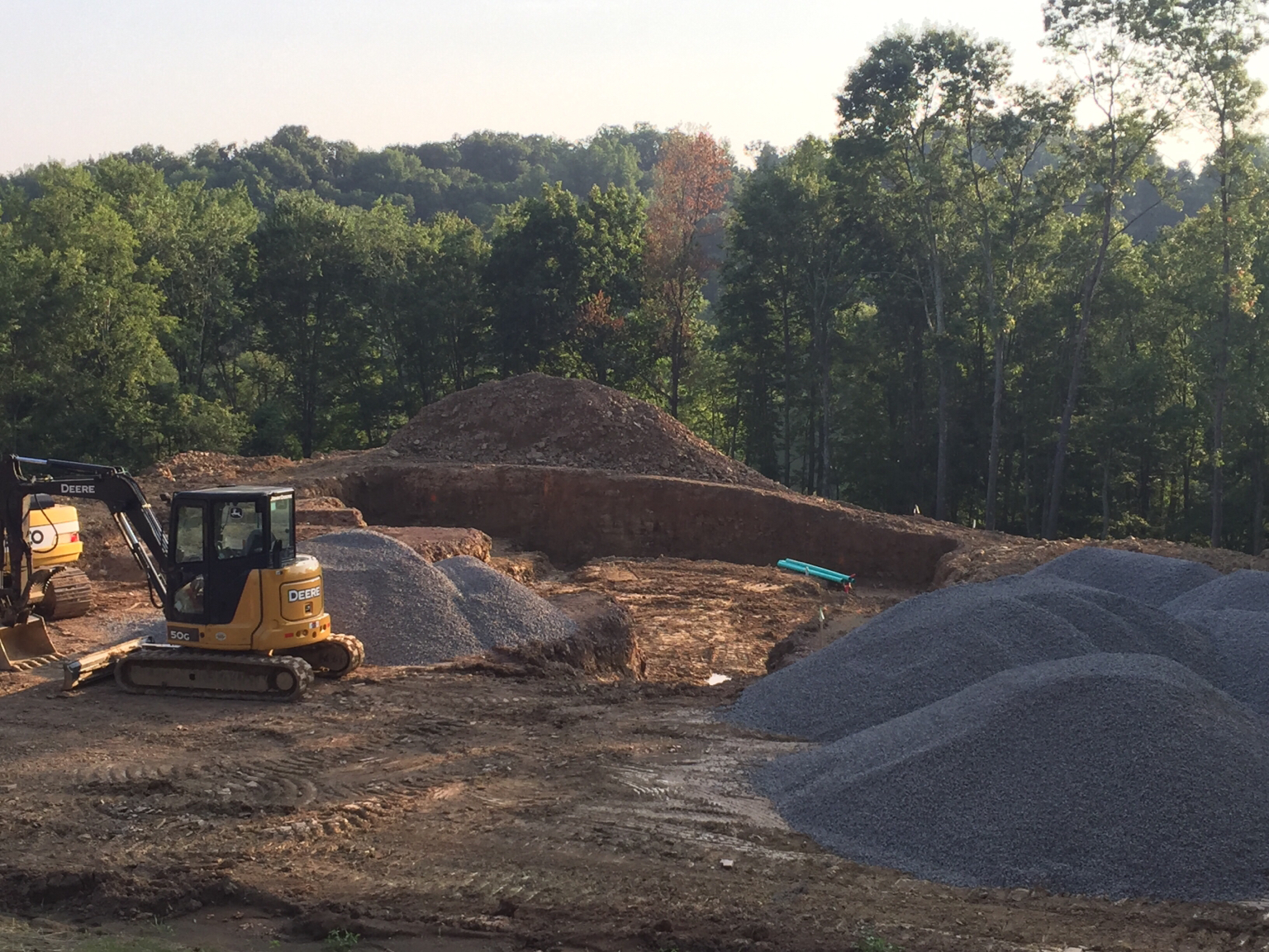

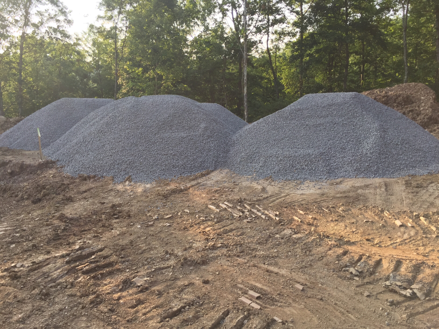

Here are what 25 ton piles of 57s look like. I would say the base is 10-12 feet in diameter and about 5ft tall. Crusher run is more compact. And yes it does look like much more in the truck.
   / Gravel road install- diy with no spread by dump truck? #44
