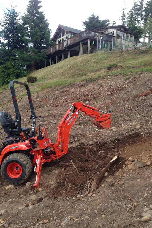

Okay, OP here again. Thanks for all the comments, especially those who comprehended my original post where I mentioned a 6ft wide path. The truck is delivering 10yards 3/4 crushed clean tomorrow to either the upper or lower end of my property and I have to haul it from there, so I have to decide on dump site by morning. Again, if I go down (and it is steep) I am worried about slipping and the limited amount I can carry keeping the bucket low and the angle. Seems like way to many loads and I will constantly be spilling before I get to the path. Going up seems safer and more efficient but not sure the big truck can make it across neighbors property without crushing a 12in drainage/culvert pipe. Here are a couple pics to give you an idea. Going over to talk to him now.
