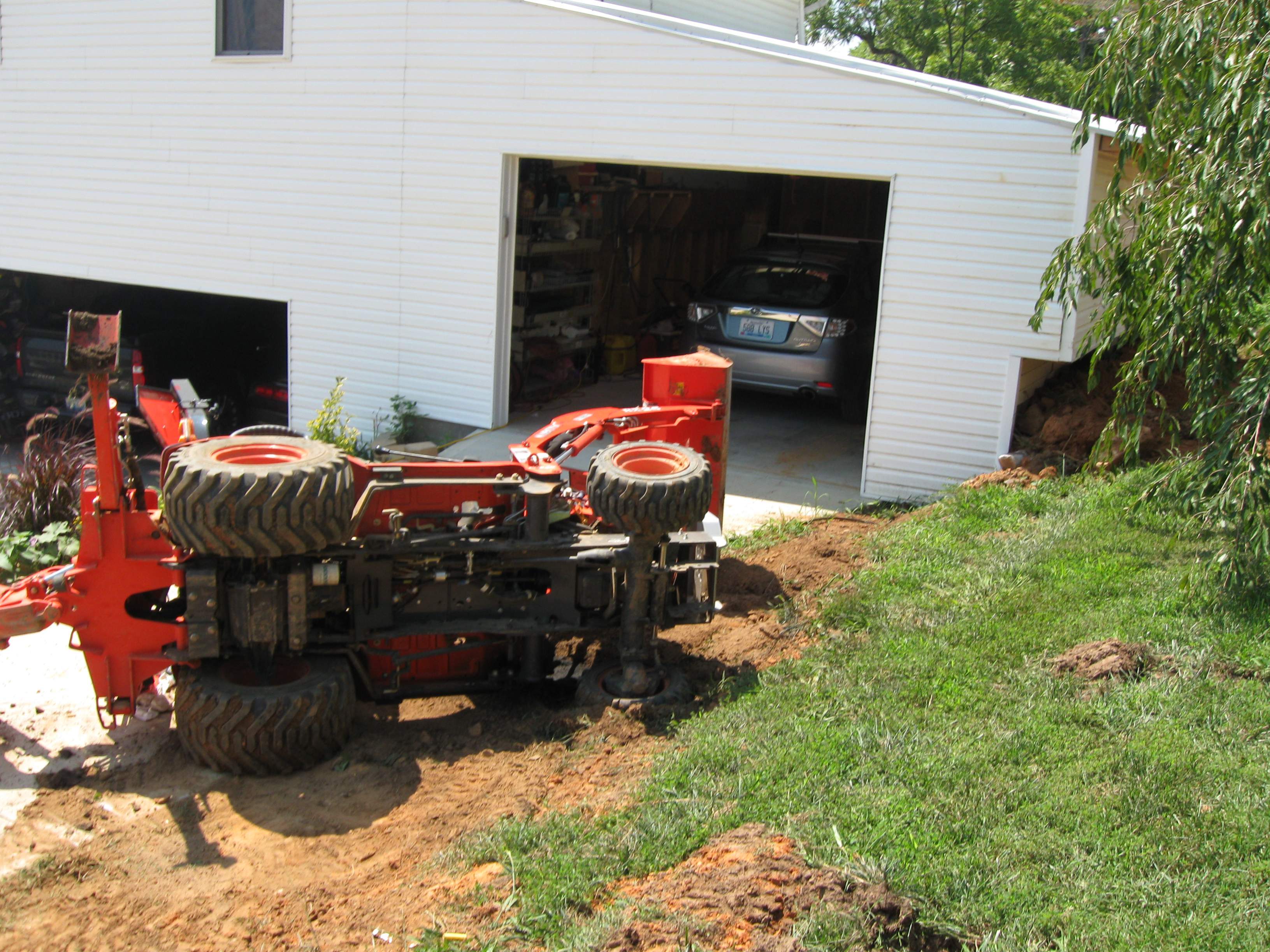

I'm going to post a pic that I mentioned to you earlier and hopefully you'll NEVER see this side of yours at this angle. Print a copy to look at if you ever get cocky:cool: which is different than confident and careful.:thumbsup:
Believe me... this thought is constantly on my mind! My entire landscaping plan is revolving around how I can shape my yard so I have access to it all with the tractor safely.

John,
If that was you, what were you doing just before it rolled?
I had added another one car garage up the hill on the side of the 2 car garage. Where the drive was cut into the slope there was a 1' high straight up cut up near the door which became a sloped bank on back from the door. I decided I wanted the entire bank to be sloped for easier/better/safer mowing instead of the front part having the drop down section. Pulled tractor forward to the cut section and dropped bucket down, curled edge of front bucket to cut the edge off the straight up and down section and was backing up while rounding off the straight edge and it (the BX25) just laid over on its side in less than a half second. Surprised?:eek: Yes, I was surprised. I had done "basically" the same thing many, many times before. Apparently the angle of the slope and the lifting front end had to little dirt under the low side (none)of the bucket which just laid it over. The BH was in it's normal locked in position at the time. I've done the same or almost same thing (cutting edge down to a slope) with the FEL many times before but usually has been with a different tractor with no BH. The BH definitely makes it more prone to go over. I've almost turned it over a couple of times before but knew I was pushing the envelope of safety but this time it "just happened" and yes, it was my doings and failing to "be careful" or consider what I was doing before I did it with a better understanding of plane geometry which I almost failed in High School.
Almost turned it over one time crossing the steep crest of a hill and was so close that my weight was balancing the tractor from going over. I was so close I started to jump then decided to try and save it by turning slowly, carefully and turned the BH around to the upper side of the hill and extending it and pushing the foot/stabilizer down on the lower side of the hill then pulling the back end of the tractor around with the BH bucket. Unlike when I did turn it over I realized my precarious position as it was unfolding. When I did turn it over......it just went over.
