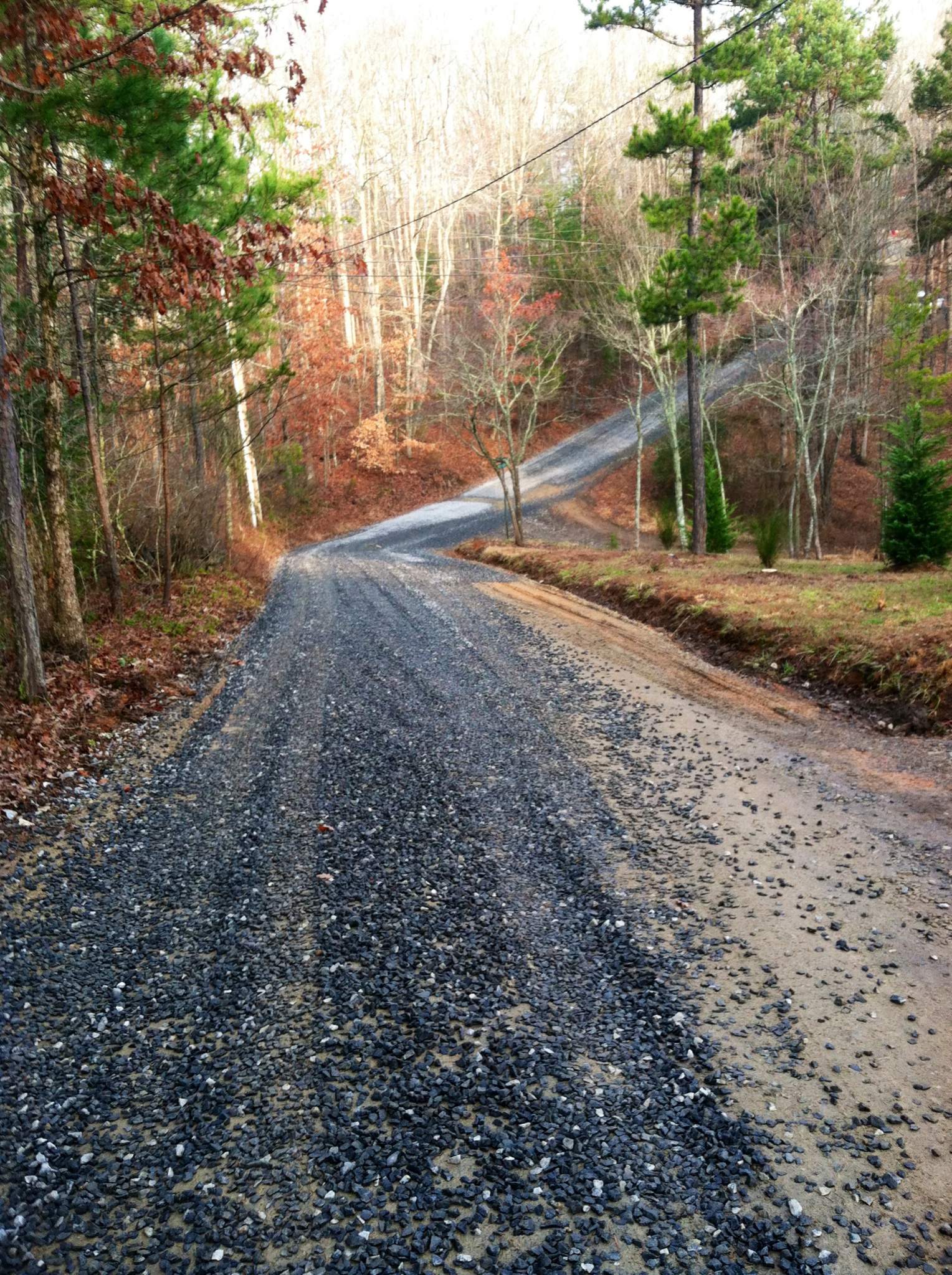

Hope this photo goes through because our road is steeper and we had the truck spread the load from bottom up as the bed raised. Driver was great and it took another 6 hours of box and blade grading to get the desired road.
First load was what we call crush and run abd the next load was 1 1/4" gravel (18 tons of each)

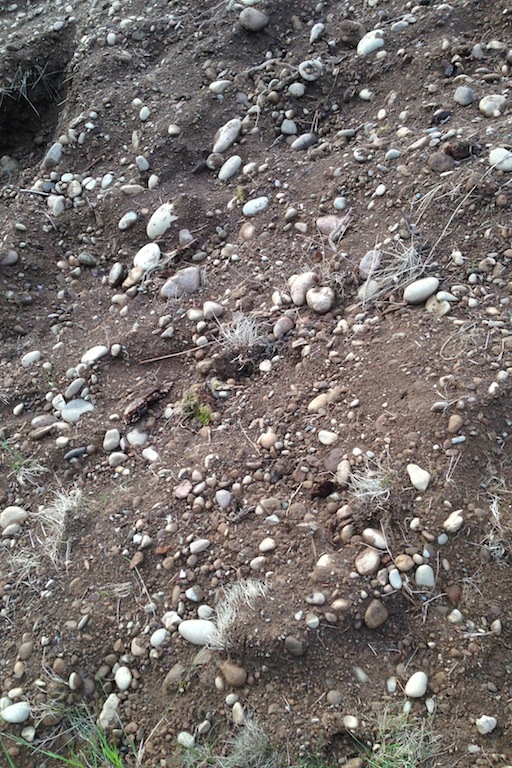

Hi Ron, you know this soil and you are right on. Here are the specifics. Almost the entire path is of the glacial till variety. Sandy, rocky and a few up to 6in boulders. Really haven't run into anything bigger but a lot of baseball to softball sized rock smoothed over the million year process of landscaping before I got here! :D I do have a short stretch of 'snotty' clay and it happens to be where an underground spring decided to surface for air. The good thing is that it is only about an 10 ft stretch and is on the only flat section of my path. I plan to cut down in and add some 4in drainage pipe and extra gravel to get that water going downhill where it will dissipate. Here are a few pics for those of you not familiar with our typical PNW hilly soil.

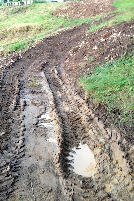

Here is a better pic of why I want access from both ends. Picture doesn't really explain everything but better than just words. The foreground is about half way up but the background sort of gives you an idea of how steep it is at the top.

The only advice I can offer is to not place all the stone one time. Place enough to just cover and allow it to work in before placing the next batch. You'll probably discover that some spots require more stone than others and by layering, you can find out where they are. Seepage of ground water will create these spots.
Dirt roads are not about dirt, they are all about water. If you create a chute from top to bottom and get a couple of inches of rain in a hurry, you'll discover the truth in this. The cure amounts to creating water breaks and road angles that help take water to the downhill shoulder instead of allowing the entire load to careen down your road and drainage ditches. Erosion is not your friend, or anyone else's below your property.
