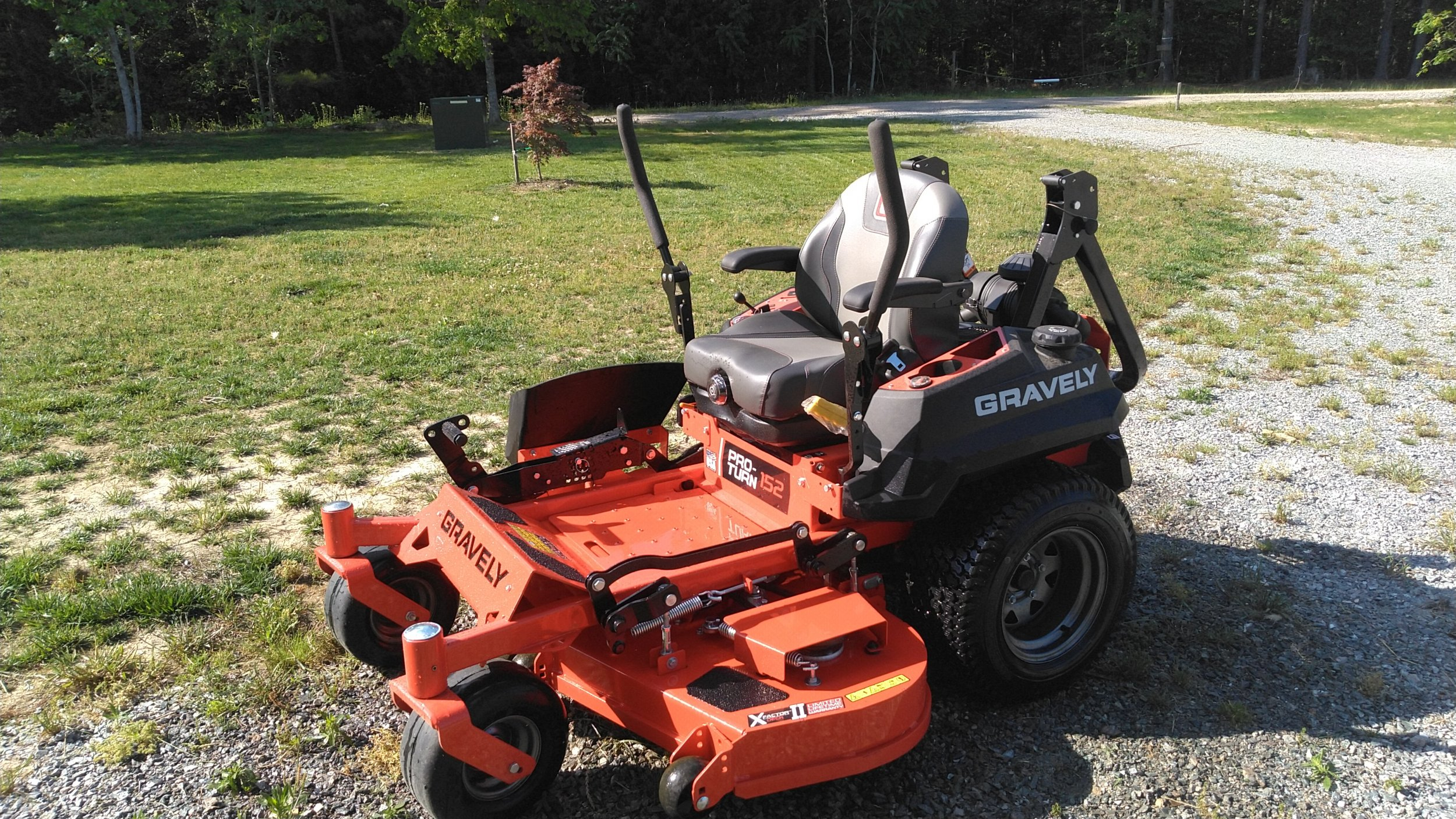

The main reason I upgraded to the commercial pro-turn was the seat and comfort. My older gravely had the similar seat to yours. When I looked at your model and drove it I knew I would still get beat around some. I had 2 herniated discs and surgery and do not want to mess it up again.
The updated seat would probably be 1 grand. Just guessing though.

You have a suspension seat. First thing I would do is check your tire pressure (to high will make for a rougher ride)
I run my zero turn tires at 8 or 9 PSI to help the ride.
DK35vince, the model that was purchased (zt 60hd) does not come with the suspension seat. The picture above is my mower.
I meant ZX 60. sorry about that

The seat isn't gravely specific besides the fabric. Last time I looked you could get them for 550-600. Might get one for the excavator. Just look for a suspension seats with the clear weight setting Dial on the front. Many high end mowers use that same one.

I think I will call tomorrow and see how much it costs. It’s that or I will have to get tons of dirt to fill all the imperfections that I discovered in the yard. It seems funny but I thought it was rather smooth until now.
I would prefer to order it from the dealer, that way everything should fit without too much trouble. I have limited ability working with tools and think it’s best to avoid having to redesign things to get them to fit. I have watched my husband make things fit that were designed for other things and am sure the tools are here but I would not have a prayer at it if it doesn’t come with directions.

Shows a low profile suspension seat in the brochure.
I see what you are saying. I am thinking of my seat being more of a suspension seat with the weight setting on it. Sorry for the confusion.

The low profile suspension seats tension can also be turned up or down for different operator weights. (I have one on my tractor and they do work OK)

I did adjust it a few times now. The suspension seems to work nice on real bumps, holes that surprise you like the one my dog dug this morning. However it seems if set too soft it bottoms out but adjusted just right for the holes and then going fast over the smaller quick or short bumps or imperfections It seems the seat itself could use just a bit more cushion. Maybe it’s me being old and finicky or just that I am too light? I wiegh about 110lbs soaking wet.
My understanding is the other seat has more cushion in the seat itself which might be better for my light wieght..
Maybe a test ride on a model with one on before I order it?
Just to confirm my thoughts.

Thanks, I somehow missed this! Maybe the tires are overinflated? I have heard my husband talk about tires being overinflated on tractors when on the lots but it never crossed my mind with this.
Now to find his air gauge and try this?

For the first it seems my sister put air in the tires both front and rear to 25 psi thinking they were low and only looking at the specification for the max pressure in the front. ( I dont know what possessed her to do this, guess she was just bored while I was in town getting fuel)
Cleaning everything tonight was easy, just used the compressed air line that reaches into the driveway and blew everything away. The flip up floor and pop off covers made everything easy.
I might still look into buying the upgraded seat but will actually test drive one with it on before deciding. At least now I know what to look for and won’t be afraid to really test drive one to see if it’s worth it.

The ride was much better with the air pressure in the tires down as suggested and I think I found a happy adjustment for the seat that allows full speed in most of the yard. The exception being some spots our dogs dug holes that need taken care of. I am going to have to fill them in and level those areas out again.
