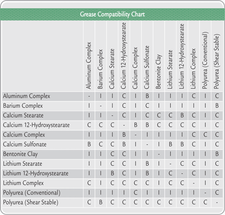

Only problem I have with polyurea is that it is incompatible with so many other greases. So it could lead to problems if you are not careful
/ New tractor Grease Question #11
You’re looking at the wrong polyurea. Look one line lower. Shear stable (Kubota and John Deere are) actually is comparable with more different grease than anything else. Another reason I use them.
You're right, I was wrong. This is the shear stable polyurea.
I'm gonna leave the chart I think it's still helpful.
/ New tractor Grease Question #14
The chart is helpful, thanks!
