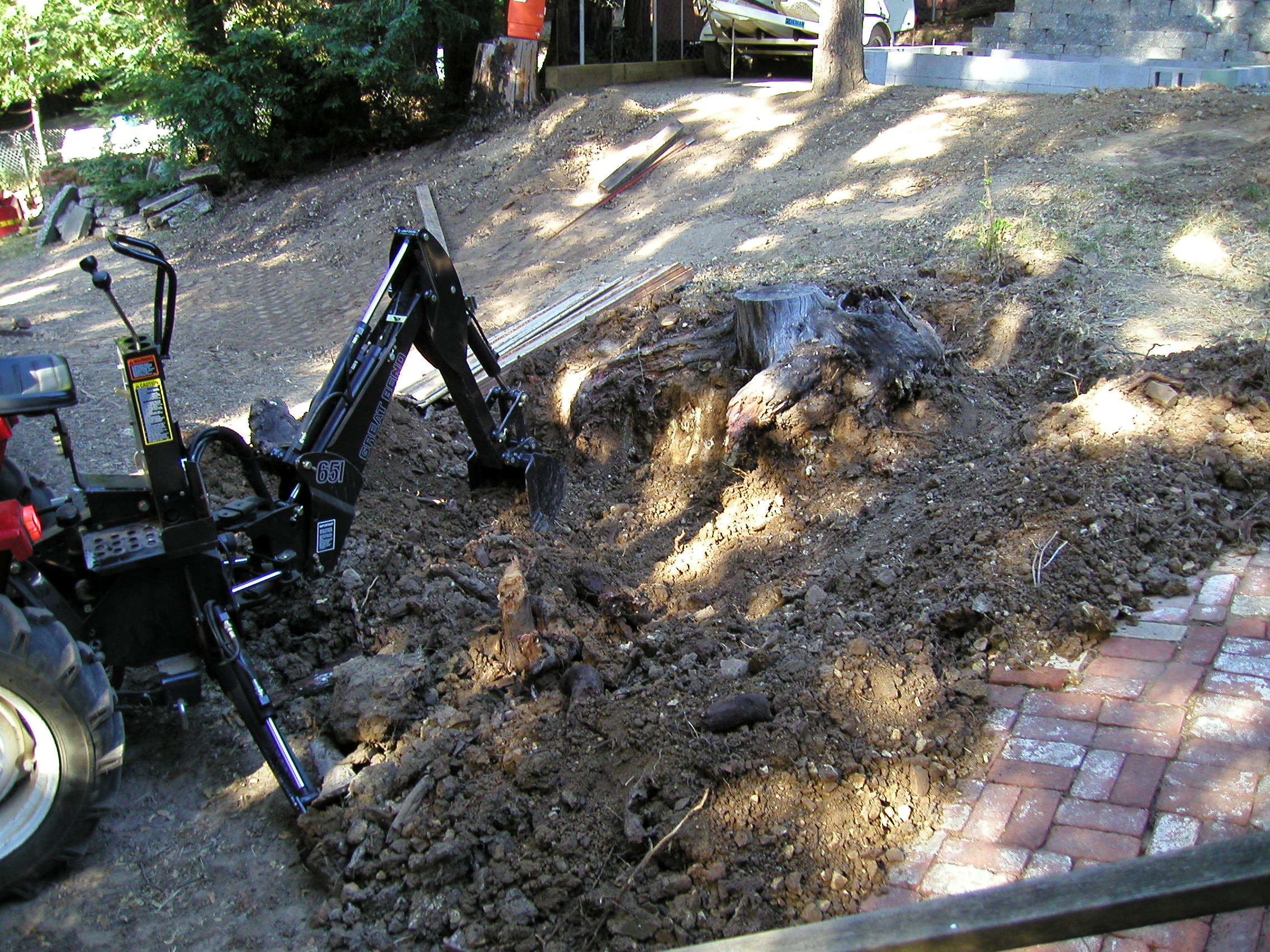

I have a 1999 NorTrac NT254 with Great Bend Loader and Backhoe.

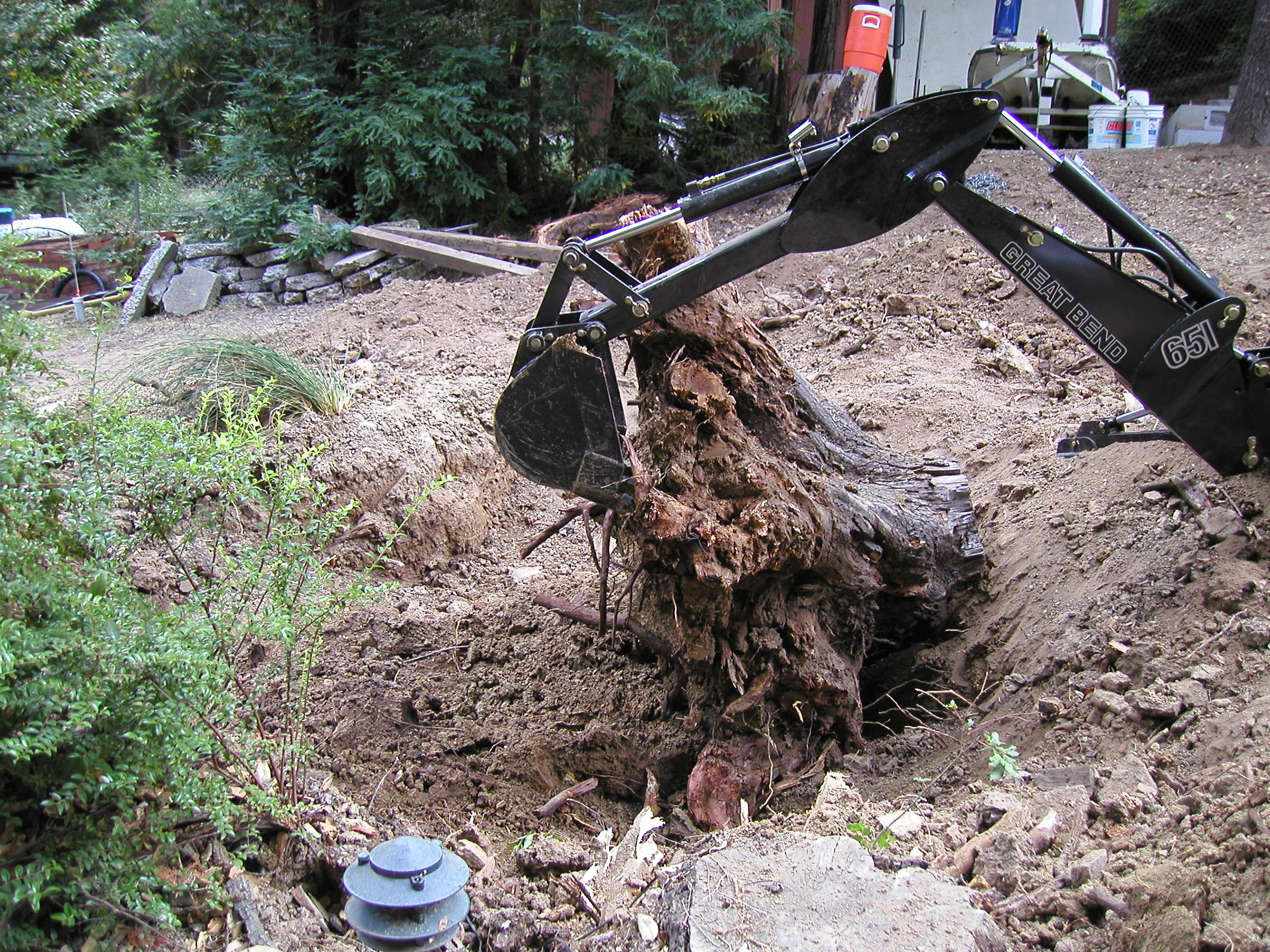

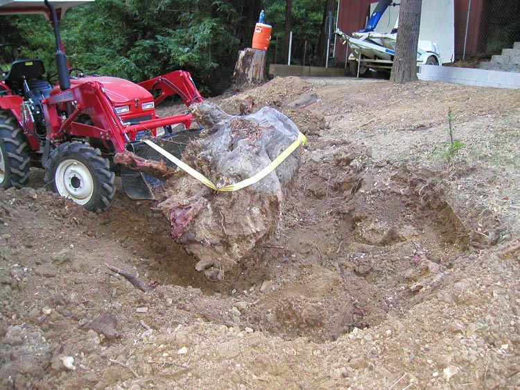

While completely overloading the Backhoe trying to break a stump free (I know, I know), the bucket cylinder shaft bent 90 degrees. This is the cylinder that curls/crowds the bucket.
Today I called Northern Tool and was told that Great Bend has been bought out by Bush Hog. Northern Tool had a slightly different cylinder that "should work" for about $500. I wanted the exact cylinder so I called Bush Hog and was quite surprised to find out they want just under $1900 (yes, nineteen hundred) for a replacement cylinder.
So now I am looking into having a new 4140 chrome shaft machined and welded to fit my existing cylinder.
I will also need to source new seals. Any suggestions are welcome.
Thanks,
Gene :^)

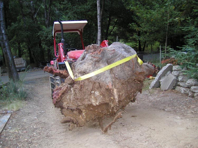

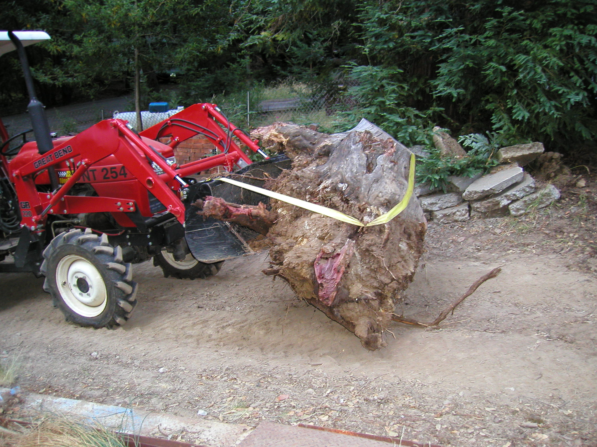

PS: Photos of a previous stump, not the culprit that got me this time.

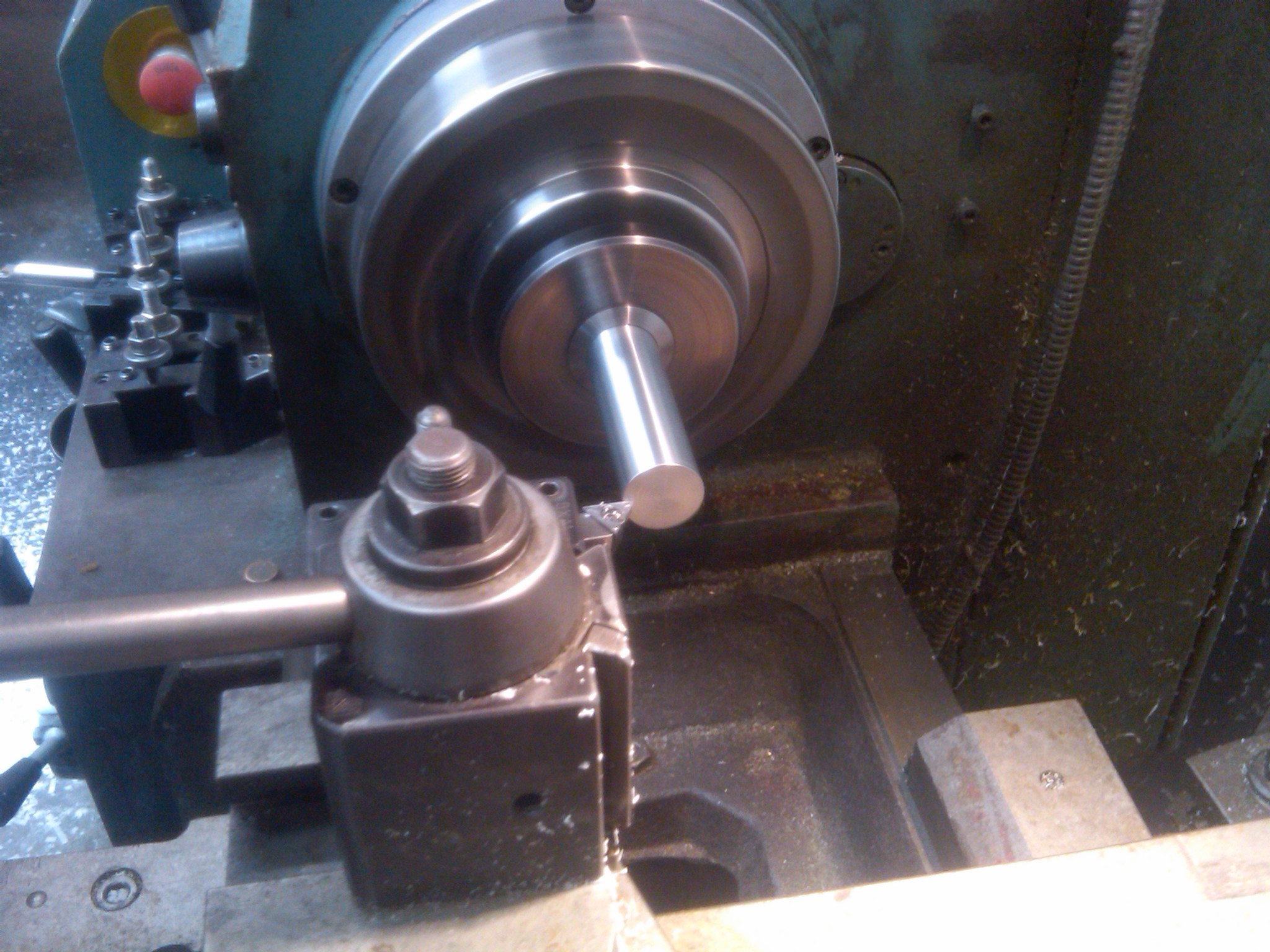

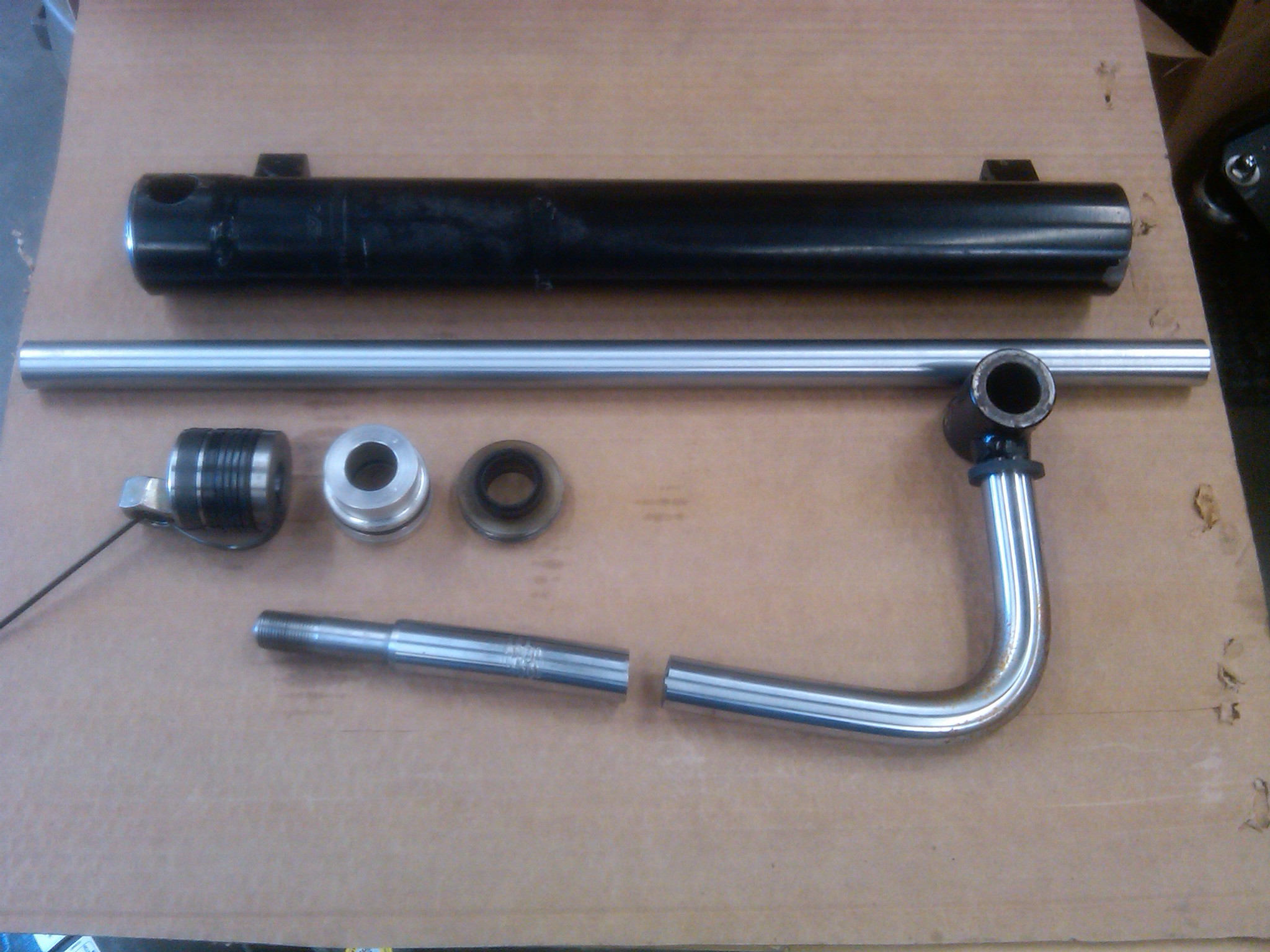

The machinist at my work turned down a new shaft for me. I will put it together tonight and weld on the end tomorrow. I'll update on how it goes.
Pictured is the cylinder all apart. I had to cut the bent shaft to get it apart so ignore the cut section. In the picture is the new piece of 4140 shaft ready to be machined. Then a photo of the new shaft getting machined. And for fun, a photo of a different stump leaving the ground.

Forgot to mention: The cylinder is a bit of a strange one. It is a 14 inch stroke by 2 inch bore but only 20 inches eye to eye when closed.
Most cylinders are 12 or 16 inch stroke. Also, most cylinders larger than 12 inch stroke start at 22 inches or more eye to eye.
Ended up being best to just fix what I have so it fits perfectly and my hoses go right on. The paint matches too :^)

I recommend threading and welding BEFORE assembling the rod, and chroming it.

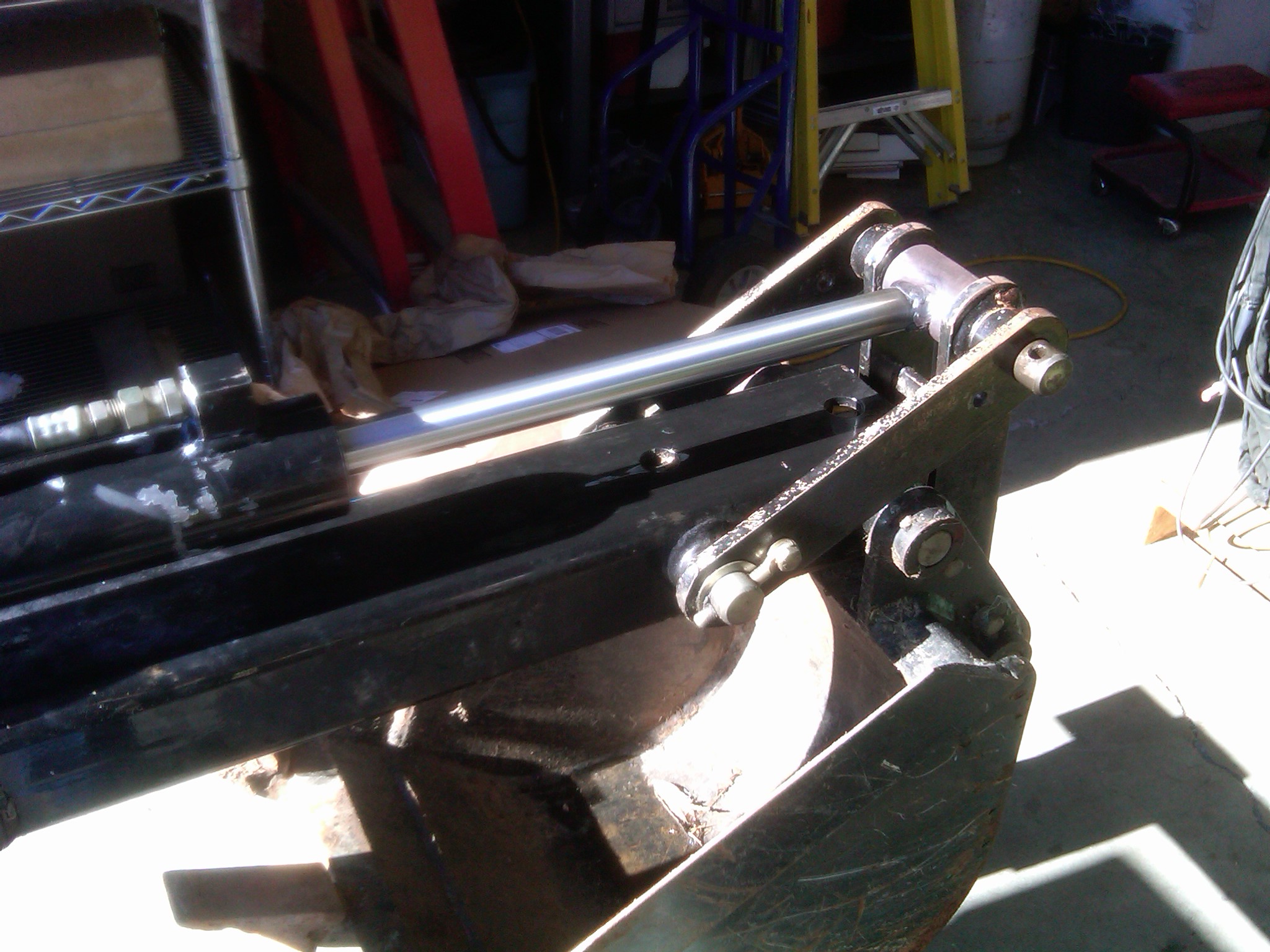

Done!! Well almost done, I still gotta spray some black Rustoleum on the end and bolt up the pin retainers.
Thanks for the support.
Gene :^)
   / Great Bend 651 Backhoe #11
What was your cost at the completion of the repair?
#12
I got lucky having access to a lathe and welder.
Machine work and welding - free.
The 4140 round bar (hardened, quenched, tempered, chromed, precision ground to -.0015) was $65 plus tax for 3 feet (so I have extra).
Ended up re-using the seals since it didn't leak in the first place and they looked great once I took it apart.
Had a can of black Rust-Oleum laying around - free.
Gene :^)

Gene, I think you skipped a step... Unless you like this type repair, put in a pressure gauge and check the pressure that your relief valve is opening at. This is one of the kinds of things that happens when the hydraulic pressure gets up too high. Also since the bend was in the same plane as the pivot, this might have been helped along by the pivot at the end of the rod binding. The cylinder is fuly extended, at it's weakest, under heavy load, and that pivot binding, and applying torque/sideload to the shaft, and over she goes headed for pretzel town...
#16
The pressure relief is most likely ok. I was really overworking the backhoe.
I had the bucket teeth wedged under the stump and the back side of the bucket against the ground, using all three boom cylinders at the same time to lever the bucket (like a prybar). I also reached back and increased engine RPM to boost the hydraulic flow up faster than the relief could release. There was tremendous force and I was not at all surprised it got bent.
The retaining pins that hold the pivot pin at the bent end of the cylinder were also bent from the pivot pin binding and trying to spin.
Need to grease it right before I use it each time.
Gene :^)
   / Great Bend 651 Backhoe #17
You are absolutely correct Ron, and Gene by his own admission validated one of your scenarios. And Gene knows the full output of the pump (gpm @ r/m & psig rating) and the PRV pop pressure and whether it dumps to zero or maintains set pressure by Telekinesis. I tried that once on my lawnmower as an experiment: was there some oil in the engine or not?
   / Great Bend 651 Backhoe #18
Well Bob, you are way ahead of me, I still must rely on dipsticks and gauges:)
Gene, if the PRV is sized and set properly, it should be virtually impossible to do what you did, unless the pivot end really bound up and severely side loaded the rod. The bent pin at the pivot also indicates excessive force applied by the cylnder.
On another note, how are the welds/structure around the top corners of the bucketmost stressed part of the bucket structure) holding up? Thru hard use(stumps) I had to rebuild mine...

The repaired cylinder on my backhoe worked perfectly. I don't feel the need to check the PRV, it bypasses when I get the bucket stuck but still has enough power when I need it. Good enough for me the last 12 years with only one failure at a time I knew I was being rough on it. Also, I now grease it right before each job, the day I bent it I hadn't greased in a while.

Stress and heat will both remove the paint:) The top of my bucket was put together really poorly, with parts not fitted real well before welding, and the welder used to fill in the gaps. The choice of material used also made it virtually impossible to weld it correctly/fully.
Your pivot pin was probably the main cause of your failure then, but it shouldn't have bent.
One thing I discovered while I had my bucket off for it's overhaul/repair, was that two of the pivot bushings that had grease fittings on them were not drilled. Basically the zerk fitting was screwed into a hole with no outlet. I thought perhaps the bushings had rotated, and blocked off the grease fittings, but inspection on the inside showed that there were no holes at all in the bushings. Quickly fixed, but shame on me for not catching that there was never any grease exiting the sides of the bushings when I hit them with the gun...
