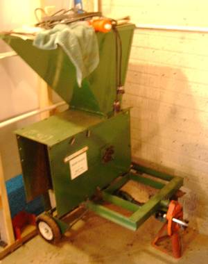

A McKissic TPH-122 would do it. You actually don't need the chipping part. You could get one with hammers only made for a Gravely.
I had one when I had my Gravely. Picture below.

Kemp made one, and there are many out there for sale on Craigslist. A couple buddies of mine who are into vegetable farm marketing use one to shred compost. They are basically a mini hammer mill. They mounted it atop an old corn drag elevator, which would load it right into the loader bucket, saving a lot of manual labor.
I also have one, but it had cross bars with teeth on it, I converted to a shell bean thresher.
Here is a picture of one.
http://www.wfmachines.com/discus/messages/335/149357.jpg
   / Grinder/shredder ideas #17
Not exactly sure where Putnam Co. is located, but here is a Kemp Shredder North of Wheeling. Kemp Electric Chipper -Shredder
It does have the bars, with shredder teeth like mine.

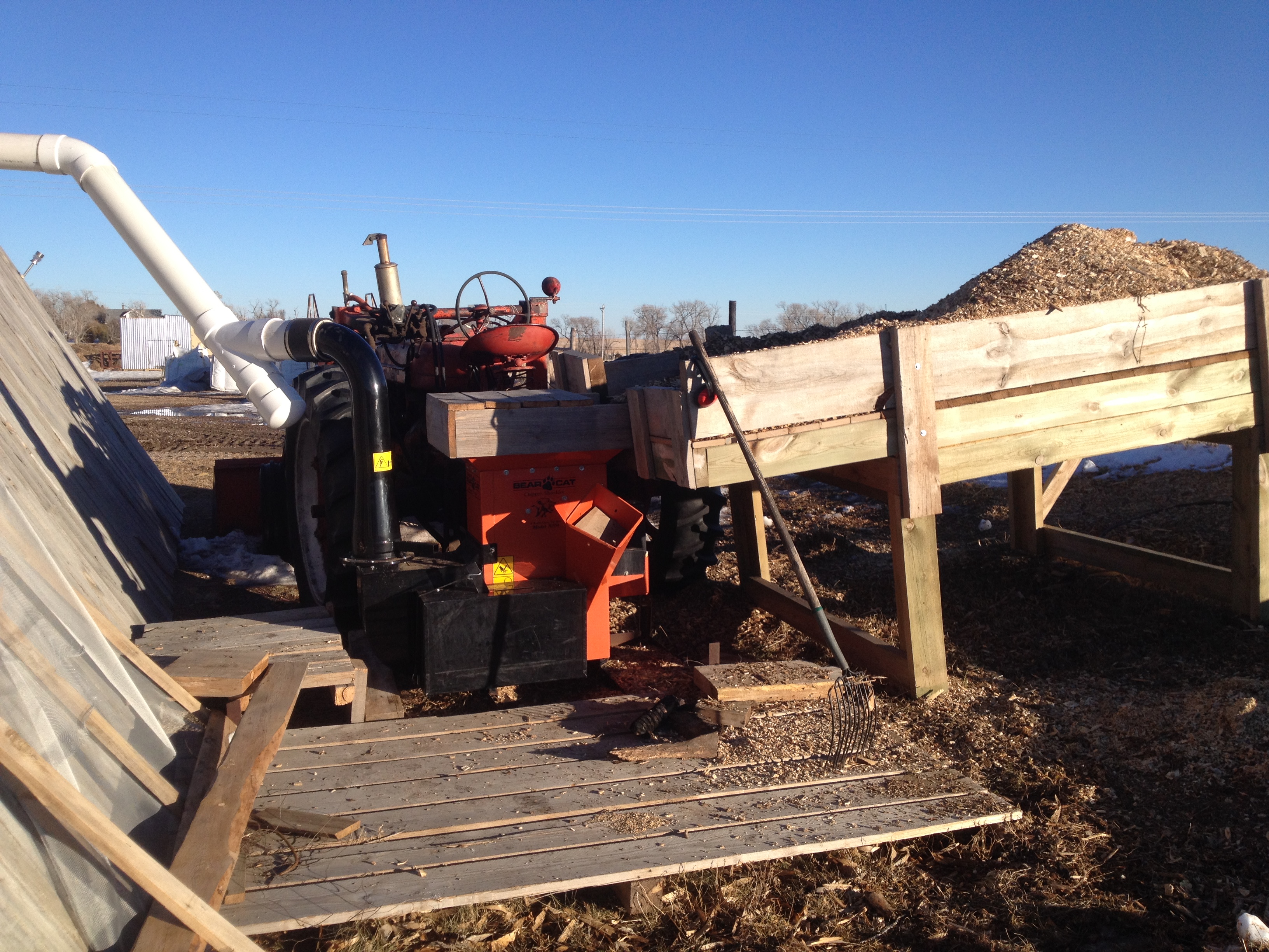

PTO grinder/mixer sounds pretty ideal for what you are doing. Just have to find on at auction as they usually do not bring much around here, at least the old ones.
I hammermill about 10 yards of chips per day using a PTO powered hammermill and blower to push the material into a bin about 50 ft away using 6" pvc pipe. You would easily do what you are after with a similar setup.
I use a table set at an angle to load my chips but in your case you could have your compost and soil on the table and then rake that material in the shredder while you toss in chunks of the coco. Use a small screen and you would get a nice mixing action.
