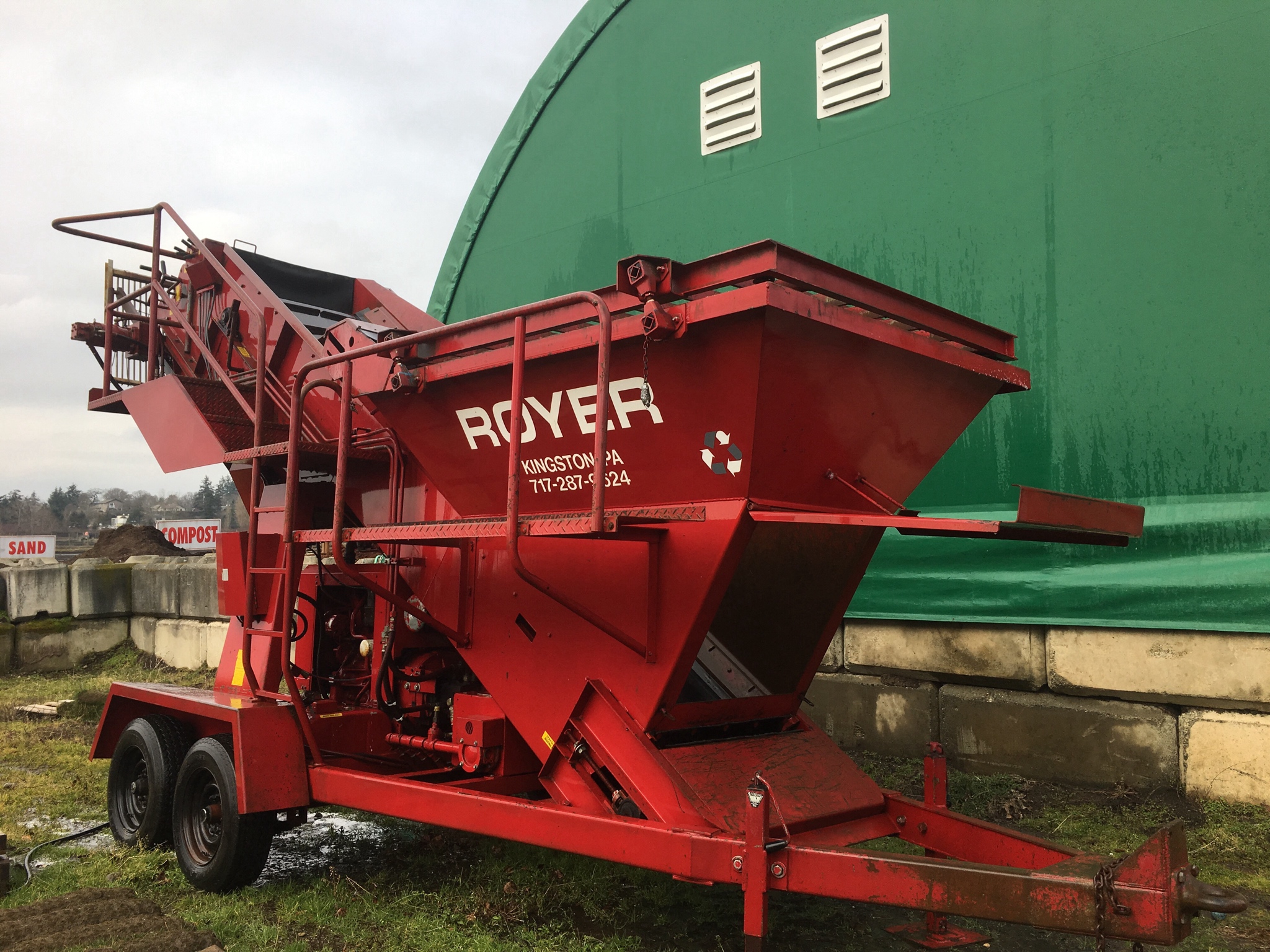

A ROYER shredder mixer would be ideal for your job.
Here's a pic of mine (120 cu yd / hour) but they make them in smaller models for the volume you require.

What a fantastic piece of kit Terry. Is the bottom belt anything aggressive or is it similar to the main belt? watched their videos but didn't really see close in there without it moving. I'll write Santa.

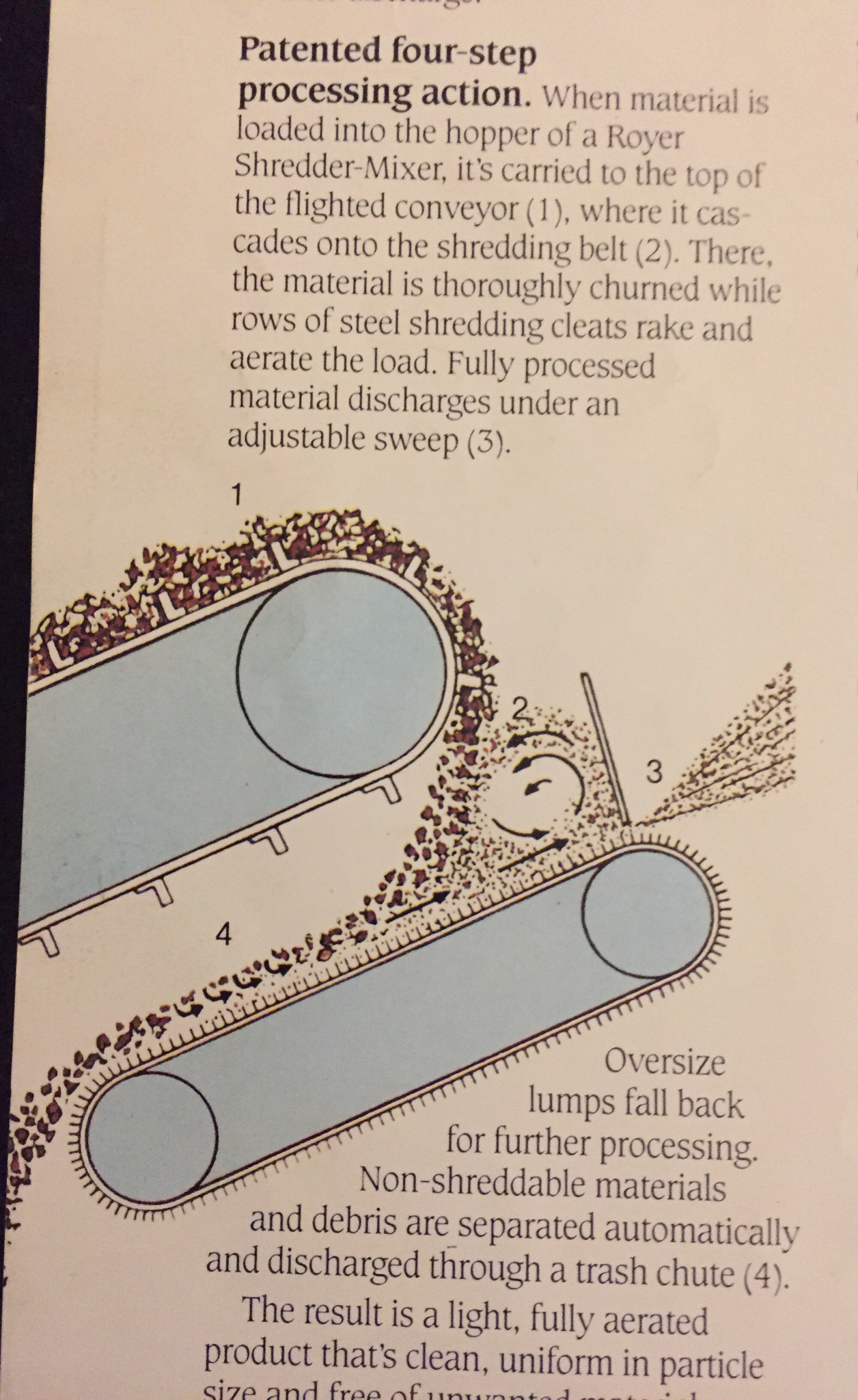

This should explain the process:

Many thanks for that. I'm looking at all sorts of ways to get my compost/barn litter/dungheap into a state that I can fling it around the hillsides here and I think now that I need more than one beater to do that. That's such a neat machine you have.
