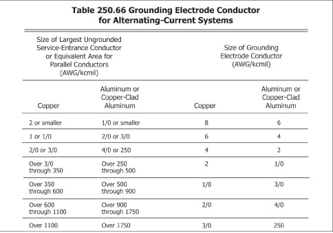

250.34 Portable and Vehicle Mounted Generators
(A) Portable Generators. The frame of a portable generator shall not be required to be connected to a grounding electrode as defined in 250.52 for a system supplied by the generator under the following conditions:
1) The generator supplies only equipment mounted on the generator, cord and plug connected equipment through receptacles mounted on the generator, or both and
2) The normally non current carrying metal parts of the equipment and the equipment grounding conductor terminals of the receptacles are connected to the generator frame.
