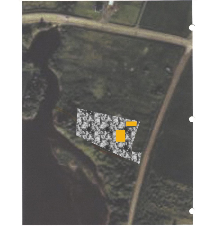

I did what all the rest did, with lots of time spent MBWA (Management By Walking Around), and a lot of plans to review, and a site map based on an aerial photo from the County Office. Then I marked up the site plan/aerial map and drew on where I figured the house and garage would work best, best on slope, sun, drainage, road access (I didn't want to be TOO far from the road due to snow). The attached was my marked-up aerial photo that I marked up. The garage is now there (right where I started out), and the house will be going in nect summer or the one after. I wish you all the best, and keep us informed of your progress!
