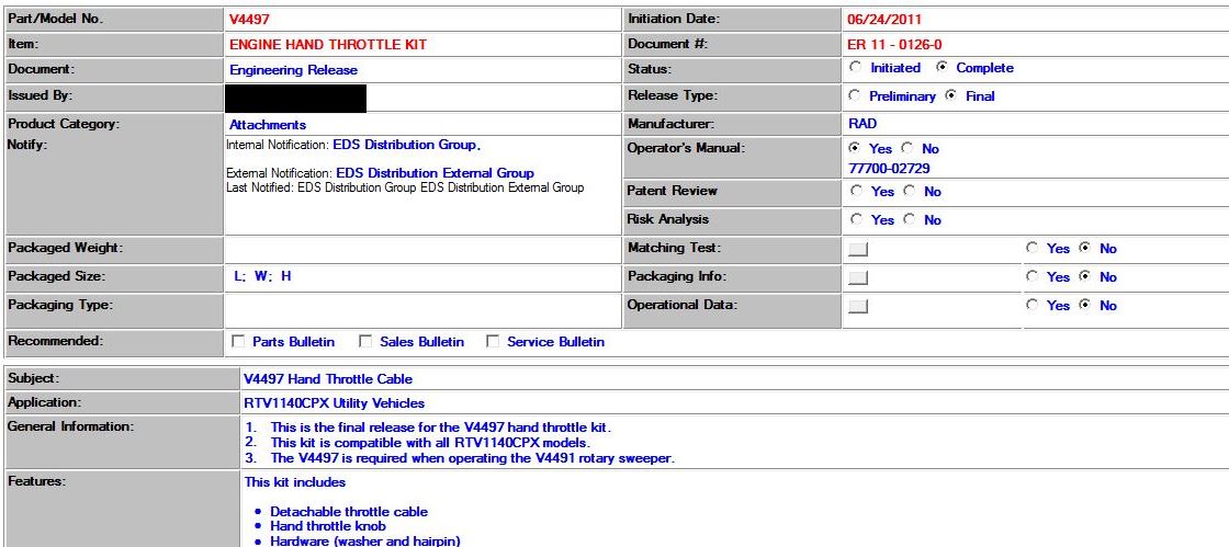

I agree Steve. I am very frustrated right now. I know I'll get it worked out but I can't believe that my local and Messicks are clueless about this. But I figure if Kubota national can't figure it out, where are the local guys going to get help.
Steve, I took the picture of your kit and circled the fork to try to help point them in the direction they should already be going. I really don't why she talks about 2 other Whole Goods kits. V4487 and V4499?
In my first email I said I would like the be able to use a hand throttle for bringing the engine RPM up, without changing the machine speed, for various things like a sweeper.
Miss Ruth sent my inquiry to engineering but I don't think engineering gets it that the V4497 kit that they put together is incomplete. See the photo below engineering's response.
Here is Miss Ruth's reply to my last email:
Mr. XXXX,
Thank you for your continued correspondence with Kubota Customer Satisfaction regarding your RTV-X1140. The kit your purchased includes a detachable throttle cable, hand throttle knob, a washer and a hairpin. We are including an image of the final release engineering notes associated with the V4487. The V4499 kit is compatible with all RTV1140CPX models. This kit is required for use with the V4491 rotary sweeper. It is possible that an attachment, such as the rotary sweeper, has the fork you mentioned. The best way to determine which part you may need and how to obtain one is to contact a dealer.
Regards,
I added bold to the above reply to point out 2 different kits V4487 and V4499.
I feel like Charlie Brown after Lucy moves the football. lol
   / Hand throttle for 2016 RTV X1140? I can't find one....Is it a unicorn? #125
Looks like Engineering needs to get out of the office and look at the kit and the machine. Then maybe they can modify the kit so it works. You need the bracket from my kit and you will be in business, correct?

Steve, I do think the bracket and the associated hardware would make this kit work, yes.

How can I be the only one to encounter this? The engineering note is from 06/24/2011

Good question, I suspect others fabricate a bracket on their own
