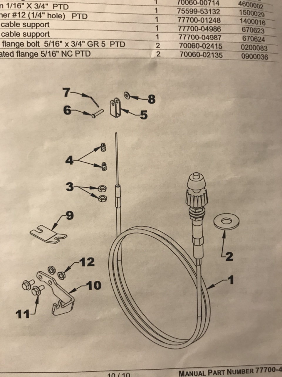

My local Kubota service guy has been a big help with my "little" 40 minute project. He found a tech that was familiar with the hand throttle. The tech said my kit should have come with a double fork to hold the "new" throttle cable.
So now I'm in search of the illusive Kubota double fork bracket.

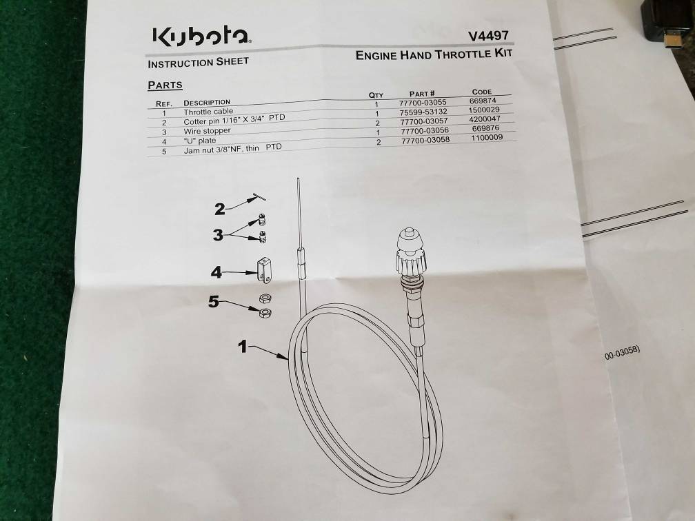

Here's the V4497 parts list.
No bracket listed.
   / Hand throttle for 2016 RTV X1140? I can't find one....Is it a unicorn? #108
You would think that but l think Kubota didn't create a complete kit.
No bracket listed.
It's cra cra but I'll get it figured out eventually. View attachment 543729

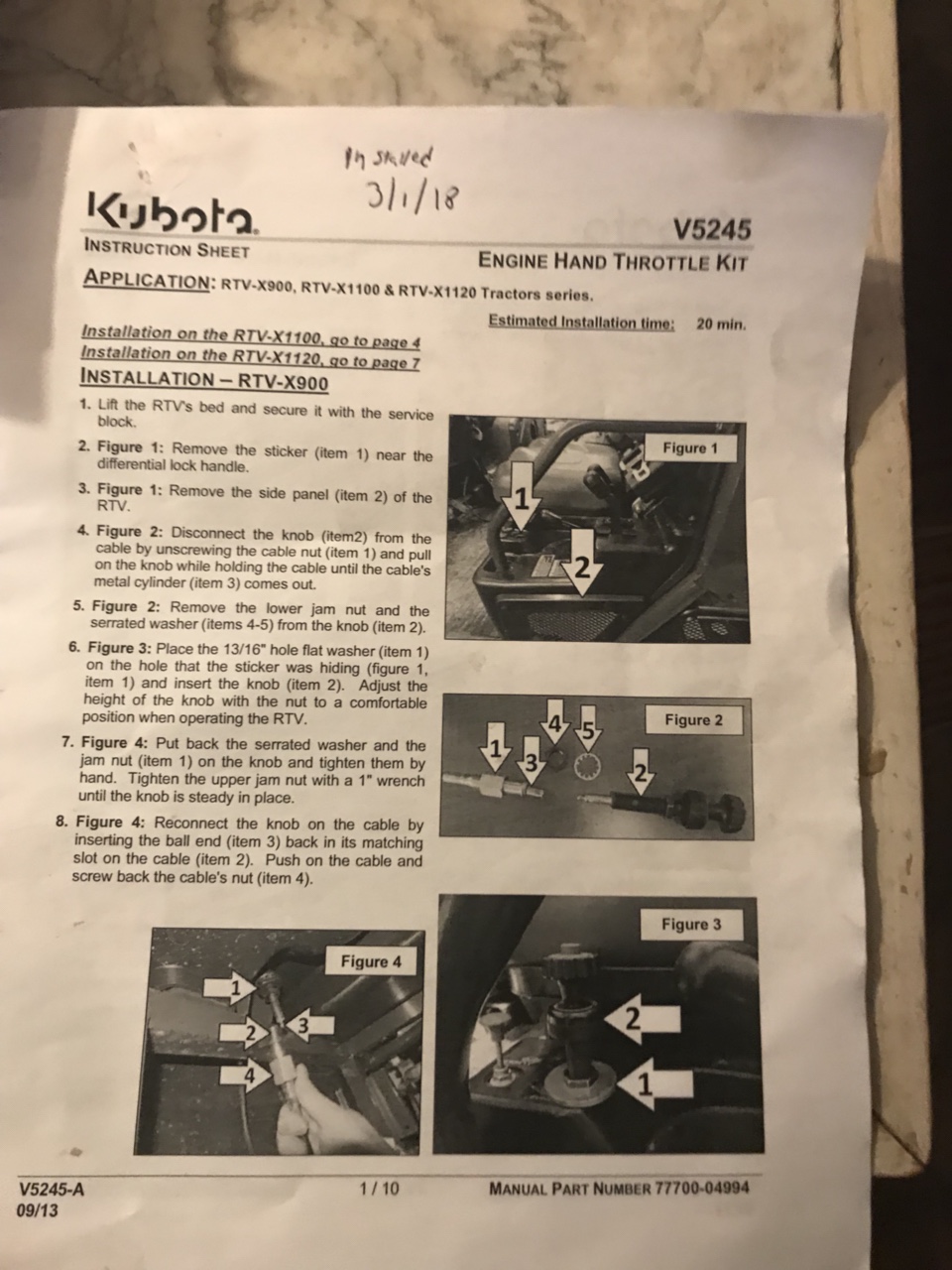

My kit was V5245. It is for the 900,1100c and 1120 D
Here are the contents
#109
Hmmm, l wonder if this kit wasn't ready for prime time?
   / Hand throttle for 2016 RTV X1140? I can't find one....Is it a unicorn? #110
It’s for your 1140? Other than the cable length I can’t see why it would be different.
