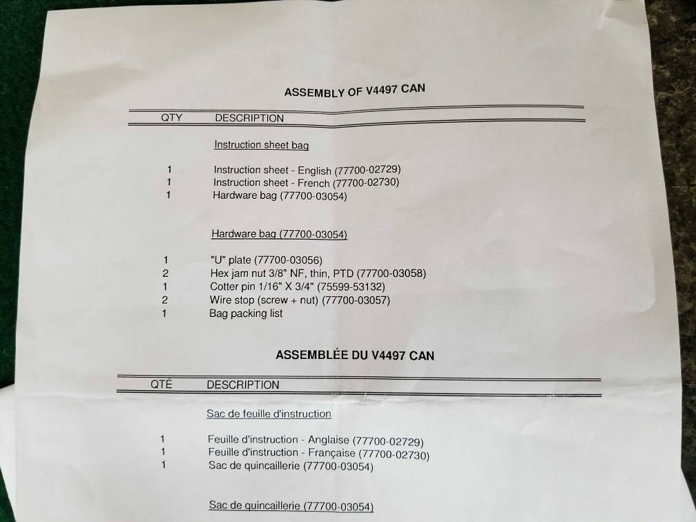

lol they sent me 2 jam nuts. One was fine threads(correct) and one was course threads. (Face in palm)

These are really simple to install and a lot cheaper to fab up yourself. I ordered the cable and made a bracket and works like the original. The last two numbers in the part number is the length of the cable, I used the 06 on the 900, but the 4 seater Kubota might take a longer cable.

Milkman I'm sure you are right. I paid 170 for this kit from Messicks. I figured at 170, l paid for the bracket.
I have 2 full time jobs and 1 of those jobs has me gone 15 days every month. Ain't nobody got time for that. :)
   / Hand throttle for 2016 RTV X1140? I can't find one....Is it a unicorn? #116
You would think that but l think Kubota didn't create a complete kit.
Here's the V4497 parts list.
No bracket listed.
It's cra cra but I'll get it figured out eventually. View attachment 543729
The V4497 number rings a bell for some reason, the early 2007 vintage RTV-1100 came with a simple 1 detent notch remote throttle cable to speed up the engine for the AC in hot weather and there was an upgrade kit out there to go to the multi turn throttle for use with other hydraulic options, so that is why the kit may have no bracket as it was already mounted on the engine for that previous control.
David

David, I've been inside the engine bay for over an hour. I've looked from above, below, left and right. No extra open bracket is in there. It's only got a small area it can live in and operate the throttle lever on the engine.
I was hoping it was going to be that easy.
   / Hand throttle for 2016 RTV X1140? I can't find one....Is it a unicorn? #118
Well your model did not come with a throttle control, my RTV 1100 did have one from the factory and pretty sure you got the upgrade kit for the deluxe throttle control so there was no need for the second bracket.
David
