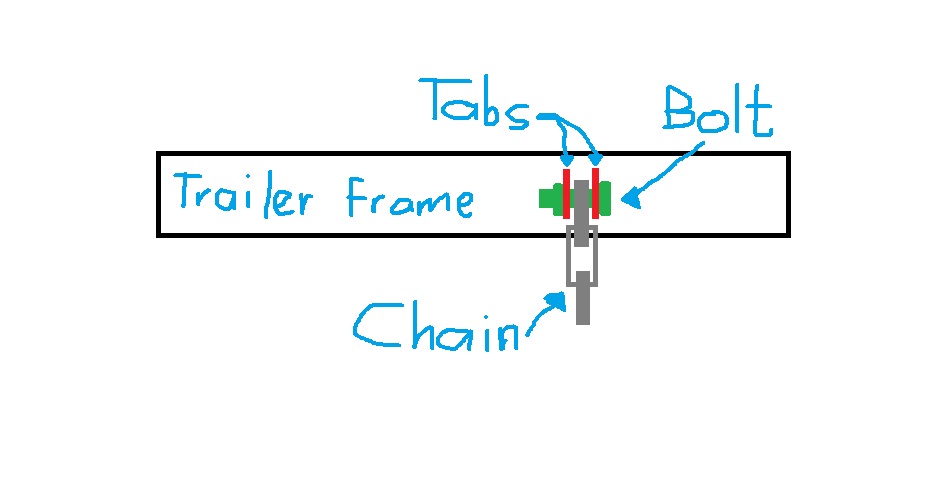

Hmmmmmm, you do have a point. Ours has no play in it but without looking under there you don't really know if the nut is on like it should be or if the bolt is just barely through the chain link and ready to fall out.
Maybe weld two rounded tabs 3/8" appart where the slot is on our trailer with a hole in them and you could put the bolt through the one side, the last chain link, and the the other side? Like this you could see if the nut was still on the bolt and the chain could move.
I made a pretty crude drawing but it should show what I mean.

How do you think that set up would do if the chains were needed? Would it twist those tabs? I wonder if rotating that bolt 90 degrees would be better.

I was thinking it would still have the loop at the bottom of the frame like our horse trailer has so that would make the pull mostly down. If you didn't do the loop then it probly would be better to rotate them so if they were needed it would be a straight pull on them. You could use what ever size plate you wanted but I was thinking either 1/4" or maybe even 3/8" for the tabs.

I like this idea, turned 90 as mentioned even better.
