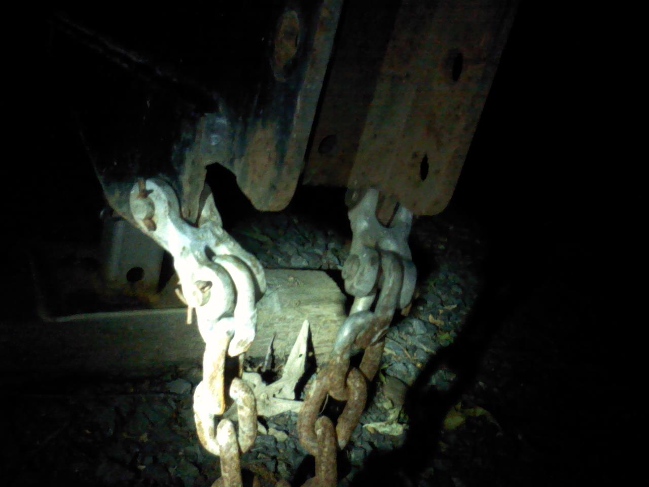

Twisting the chain works, but if you have a low trailer, and you twist them to get them off the ground, and you have to take a sharp corner, you can run out of chain if you have shortened them too much. Plus if you leave them hanging and then load the trailer or get into some whoop de dos you can still drag twisted chains. Plus I can hook up a bungee in a lot less time than you can twist one chain, much less two.
People that haul a lot usually figure out what works, but those that just do it every now and then are the ones I usually see with dragging chains. I would hate to know just how much money U-haul charges for damaged chains caused by dragging, and they are the worse culprits, as they put way too much chain on their trailers for the most inexperienced.
David from jax
Make sure to CROSS your safety chains as well. This actually allows you to twist them up a hair (not too much! Just enough to get them about as high off of the ground as the jack) Plus, it is the law. As long as you have a good 4-6" 'droop' in your chains in most cases, you won't ever get them too tight while turning, even in really tight turns or while backing up.
Hope this helps!
   / Hanging Trailer Chains #22
Never seen that way before, ok for smaller trailers, I wouldn't want it for a 5 ton or up though.
JB.
Actually, i have seen a trailer with the bigger chains mounted this way that come loose when a tow ball broke on a truck. Held 19,500lbs all the way. Seriously strong, as long as you weld it correctly.

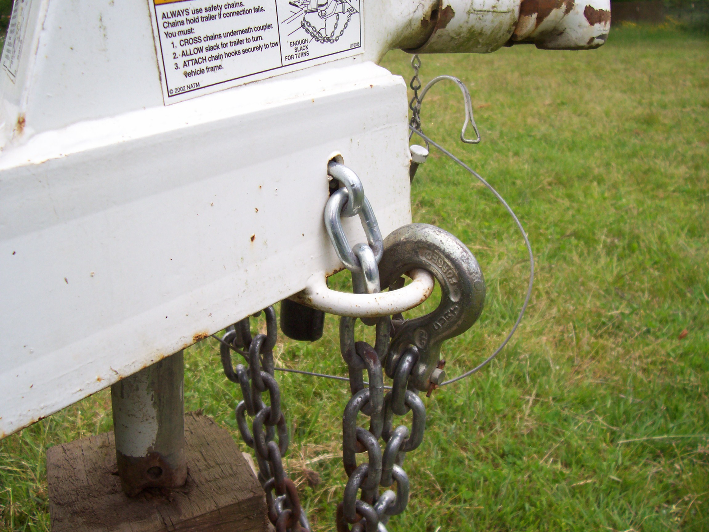

   / Hanging Trailer Chains #26
What they did on our horse trailer is cut a small slot in the frame and stick the last link of the chain (they used 5/16") through.
attachment.php
They then put the biggest bolt that fit through that link and used a nylock nut.
attachment.php
On the bottom of the frame they welded a hoop that the chain goes down through and it makes a great place to hook the chains when the trailer is unhooked.
attachment.php
I like how it works and if I ever build a trailer this is how I would do it. Depending on how thick your frame is I might reinforce it with some 1/8" plate.

   / Hanging Trailer Chains #27
I think this is my favorite idea.
I don't like it, I agree you shouldn't weld the chain, but with the welded loops you can't replace the chain easily. My equipment trailer has the welded loops and I need to replace the chain with a heavier one. now I have to cut it off and I'm back at square one, "what's the best way to hang a chain"
Maybe I could use a threaded repair link or a double clevis on the loop.
The integrity of the welded loop is not the issue for me, it's the permanency of welding a captured link in it.
What they did on our horse trailer is cut a small slot in the frame and stick the last link of the chain (they used 5/16") through.then put the biggest bolt that fit through that link and used a nylock nut.
Ed
Not crazy about this way either, just does not look kosher, plus you can't visually inspect it with out climbing under.
I'd prefer the u-bolt or double clevis. If you build your trailer, I think it would be easier to drill 2 holes for a u-bolt than cut the slot for the link.
JB
   / Hanging Trailer Chains #28
How can that be legal when you're supposed to have two chains? If the link in the keyhole, or the one on either side of it breaks, you have nothing.
I don't know. It was factory built in 2008 and has all kinds of official decals on it to prove it. It has also passed three annual motor vehicle safety inspections, as required here by law.

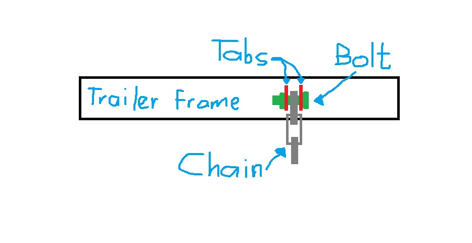

Hmmmmmm, you do have a point. Ours has no play in it but without looking under there you don't really know if the nut is on like it should be or if the bolt is just barely through the chain link and ready to fall out.
Maybe weld two rounded tabs 3/8" appart where the slot is on our trailer with a hole in them and you could put the bolt through the one side, the last chain link, and the the other side? Like this you could see if the nut was still on the bolt and the chain could move.
I made a pretty crude drawing but it should show what I mean.
attachment.php
Ed
attachment.php
Ed
How do you think that set up would do if the chains were needed? Would it twist those tabs? I wonder if rotating that bolt 90 degrees would be better.
   / Hanging Trailer Chains #38
I was thinking it would still have the loop at the bottom of the frame like our horse trailer has so that would make the pull mostly down. If you didn't do the loop then it probly would be better to rotate them so if they were needed it would be a straight pull on them. You could use what ever size plate you wanted but I was thinking either 1/4" or maybe even 3/8" for the tabs.
Ed
