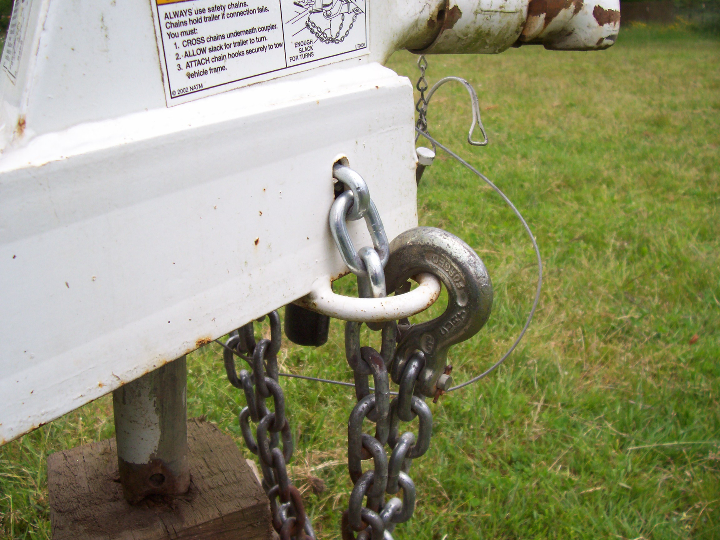

How do you think that set up would do if the chains were needed? Would it twist those tabs? I wonder if rotating that bolt 90 degrees would be better.
How about using 1/4" or even 3/8" thick angle iron for the tabs? That way you cover both axes with one structural shape.
   / Hanging Trailer Chains
#43
Here's what I came up with considering all the input from this thread. Using the angle and the clevises seemed like a good combination. Now I just need to get some chain.
   / Hanging Trailer Chains #44
Looks like it should work. :thumbsup: Now to get the rest of the trailer finished.
