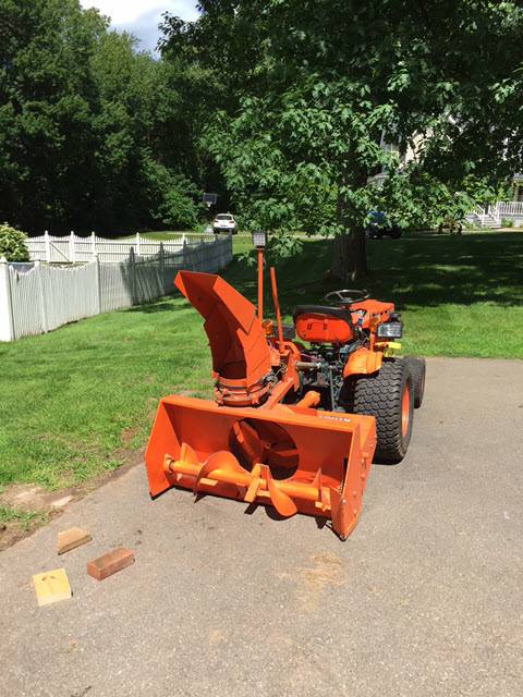

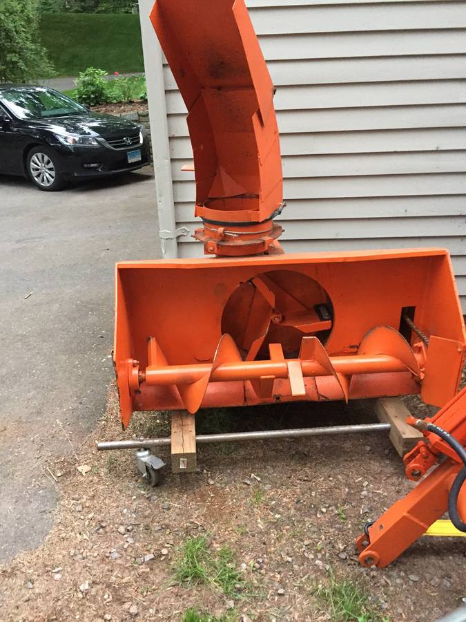

leonz I don't have a big enough trailer to bring my machine,as far as the anchor... I didn't think that I had to put in on the ground, but I will get chains it makes sense.
dave I will try again to attach pics, it just hasn't been working for me.....01313_7NbNNnqWjBQ_1200x900.jpg00q0q_2EO9nzhuboe_1200x900.jpg

dave I will try again to attach pics, it just hasn't been working for me.....View attachment 521958View attachment 521959
That blower looks like a McKee Snowlander. McKee, a Canadian company made blowers for Kubota and others in the 1970;s and 80's and just painted them different colors.
Does it have open gears like these in place of a gearbox just behind the fan.
The three blade fan is a bit of a clue.
Regardless, that blower looks like one that will serve you well.
Dave M7040

Blowers today incorporate an easily added design feature which blocks off a portion of the circular fan opening to restrain the snow as it goes up the chute.
A piece of approx 1/8" steel plate bolted on is the way to do it.
This image is of a brand new blower.
This one is the one you posted photos of.
Dave M7040
