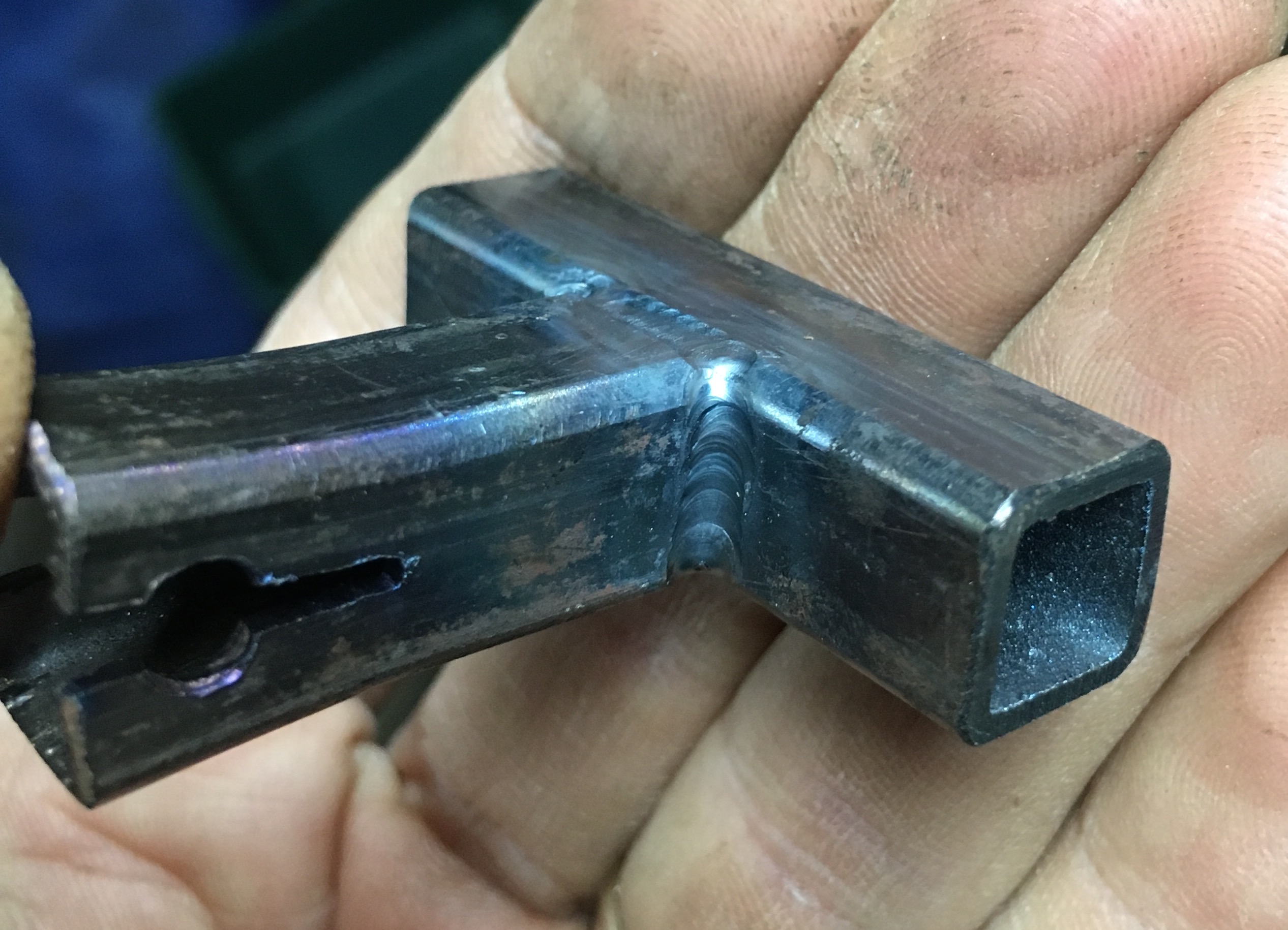

Wheels are from Harbor Freight too. They are 150lbs capacity. They don't come with nuts, you need to get metric M8x1.25 nuts. Didn't occur to me at the time but at 150lbs capacity you can't ride it as you scoot across the shop.:cool:
I made another knob for a friend. This time with the TIG.

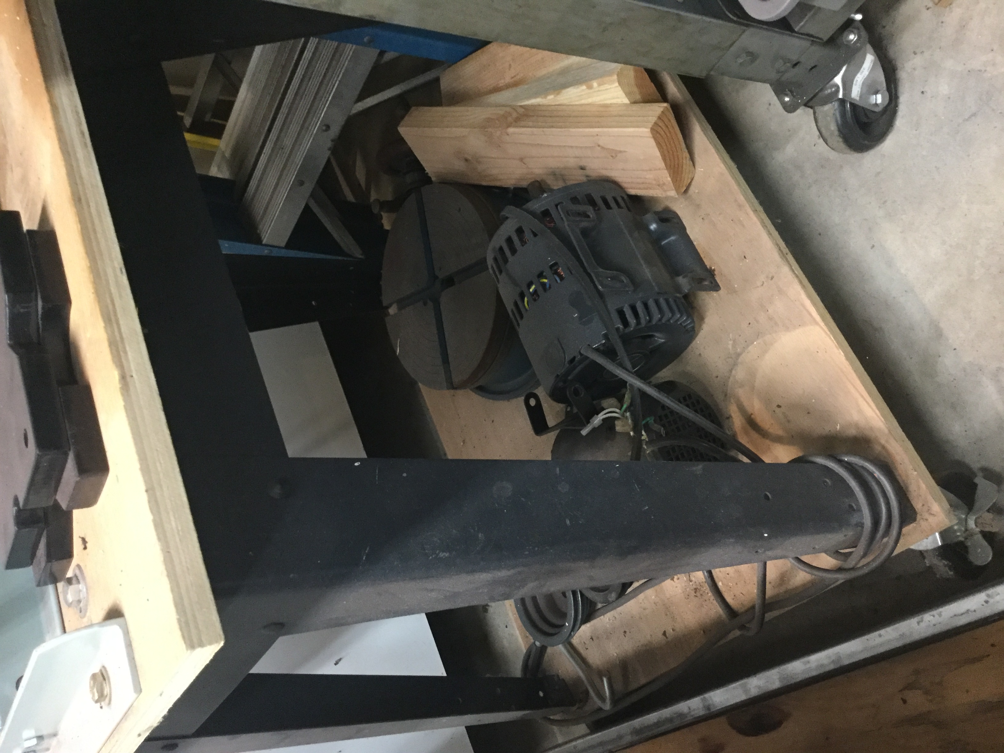

I put old Delta Rockwell or Craftsman tool stands on casters for several bench top tools. They are found around here for $25 or so. Easier than making from scratch. I make the top and bottom shelves from 3/4" 11-ply plywood which is very strong and then can be loaded up with other stuff. Casters are HF.

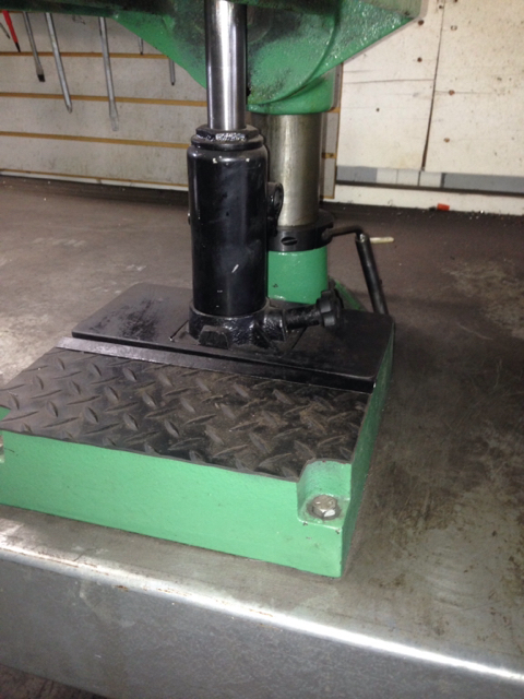

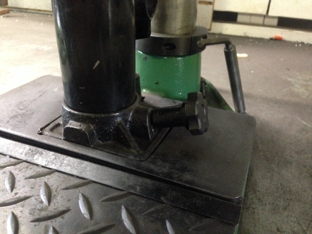

I wish I had thought of that design. I drilled a hole to match the roll pin on the bottle jack valve, and of course the holes didn't line up.
Hole for the OEM roll pin wasn't drilled perpendicular to the axis and of course I didn't notice. Had to 'fine tune it'. A hammer was involved..
