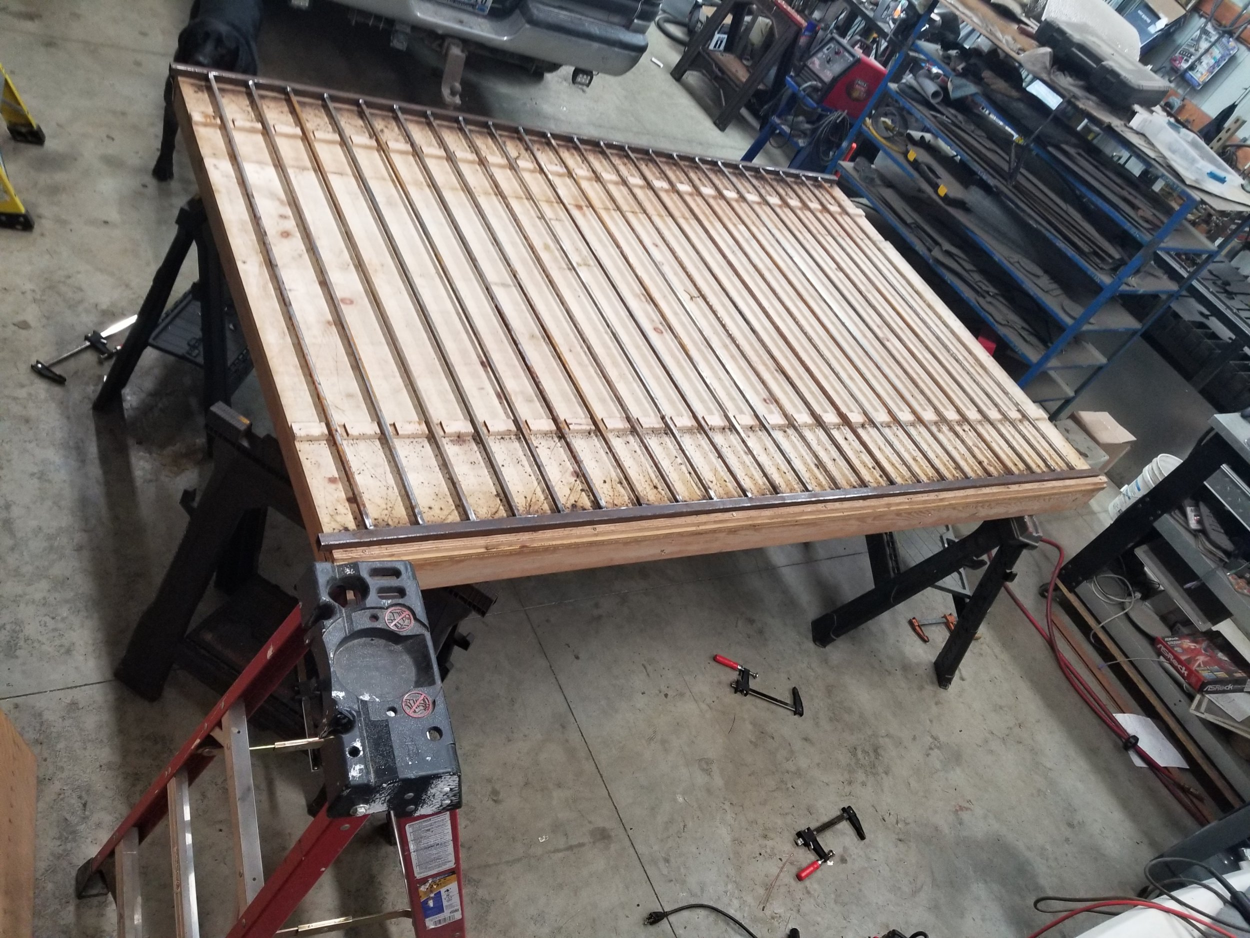

ive never used an inverter welder. I have a mig welder and a miller thunderbolt xl stick welder. I learned many years ago on an old Lincoln tombstone unit, and the miller is so much easier to use. Easy to fine tune the welds. Im thinking of getting a newer mig unit, but honestly just dont do much welding anymore that requires anything more than i have. last year i fabbed up 20 wrought iron fences for a friend. Man, the mig got a work out on that one. 77F7A4B2-B8D0-41FA-90B0-EAFB65C45E7A.jpeg

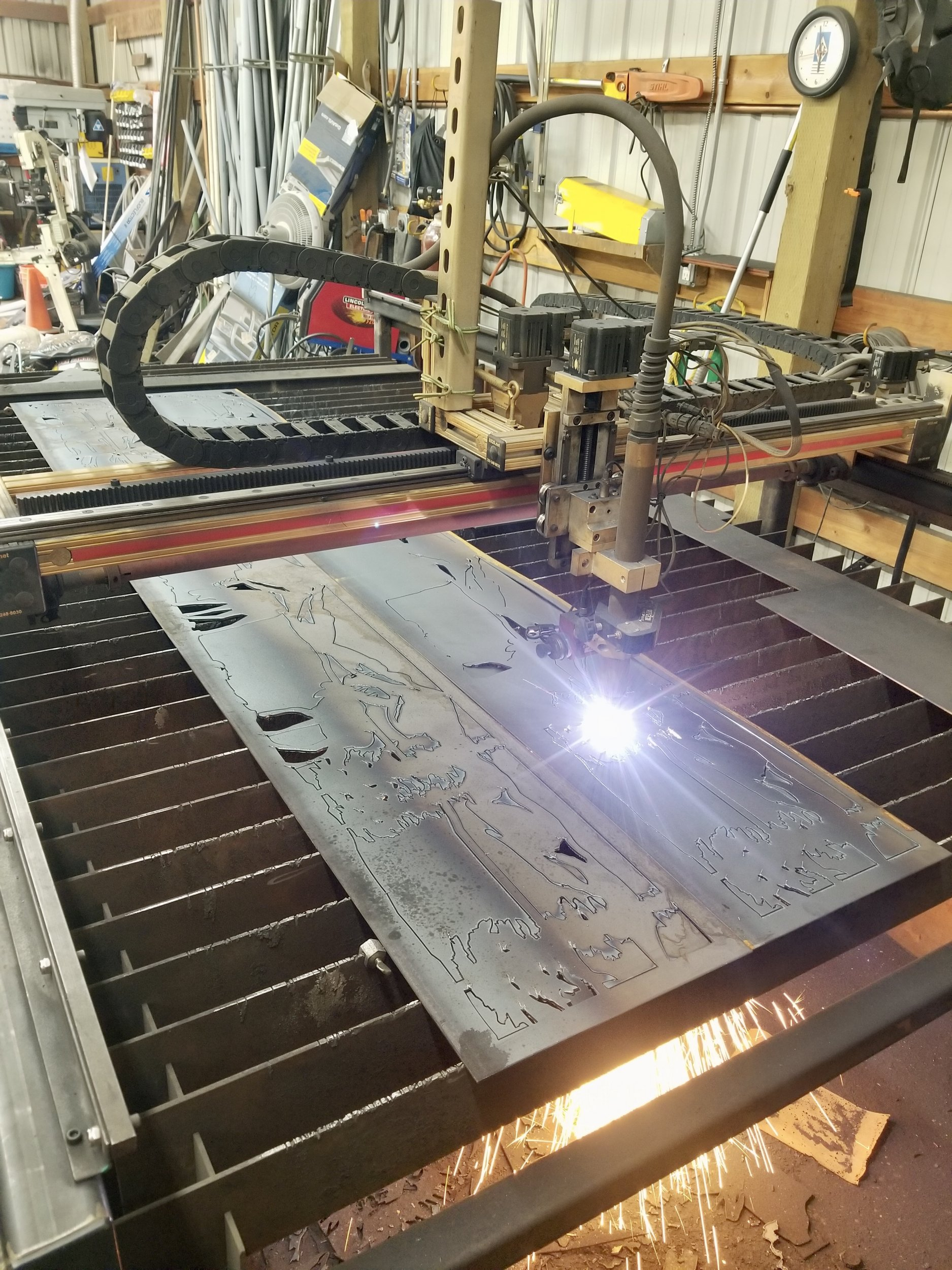

and then he wanted some artwork welded to the tops. So i had to make 20 panels 12” x 8’ to attach to tops.
my problem, while i enjoy doing these jobs, i get bored real fast. Kind of becomes a production line.
