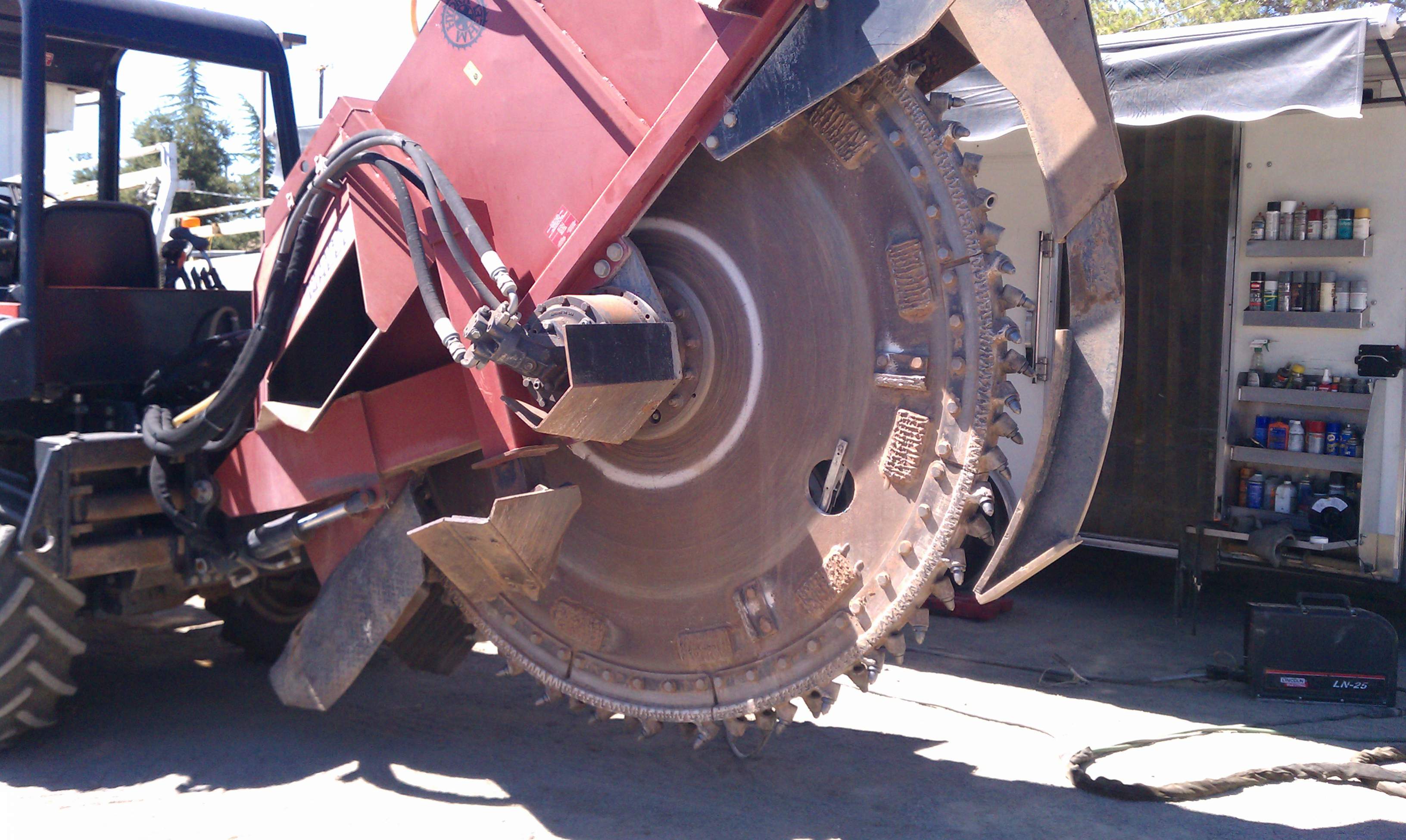

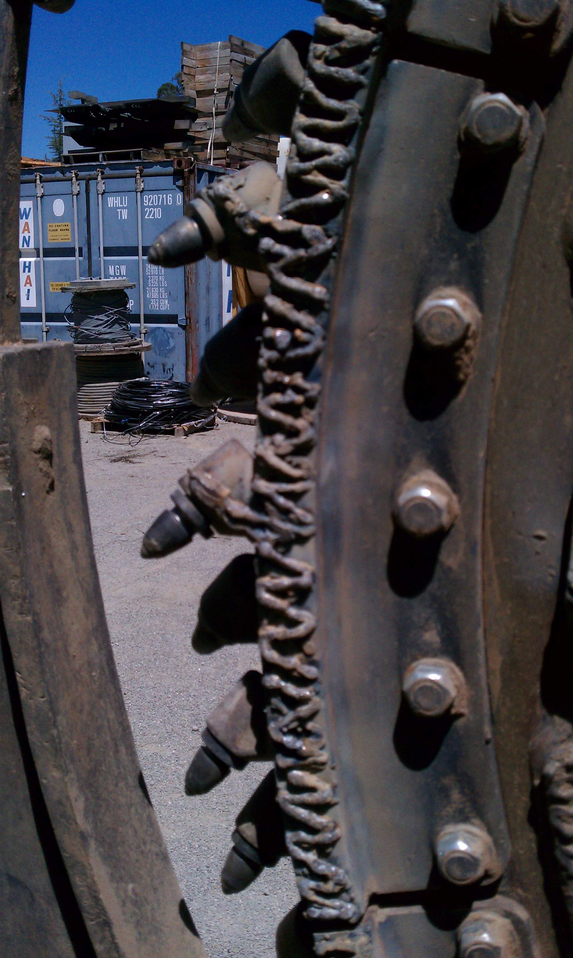

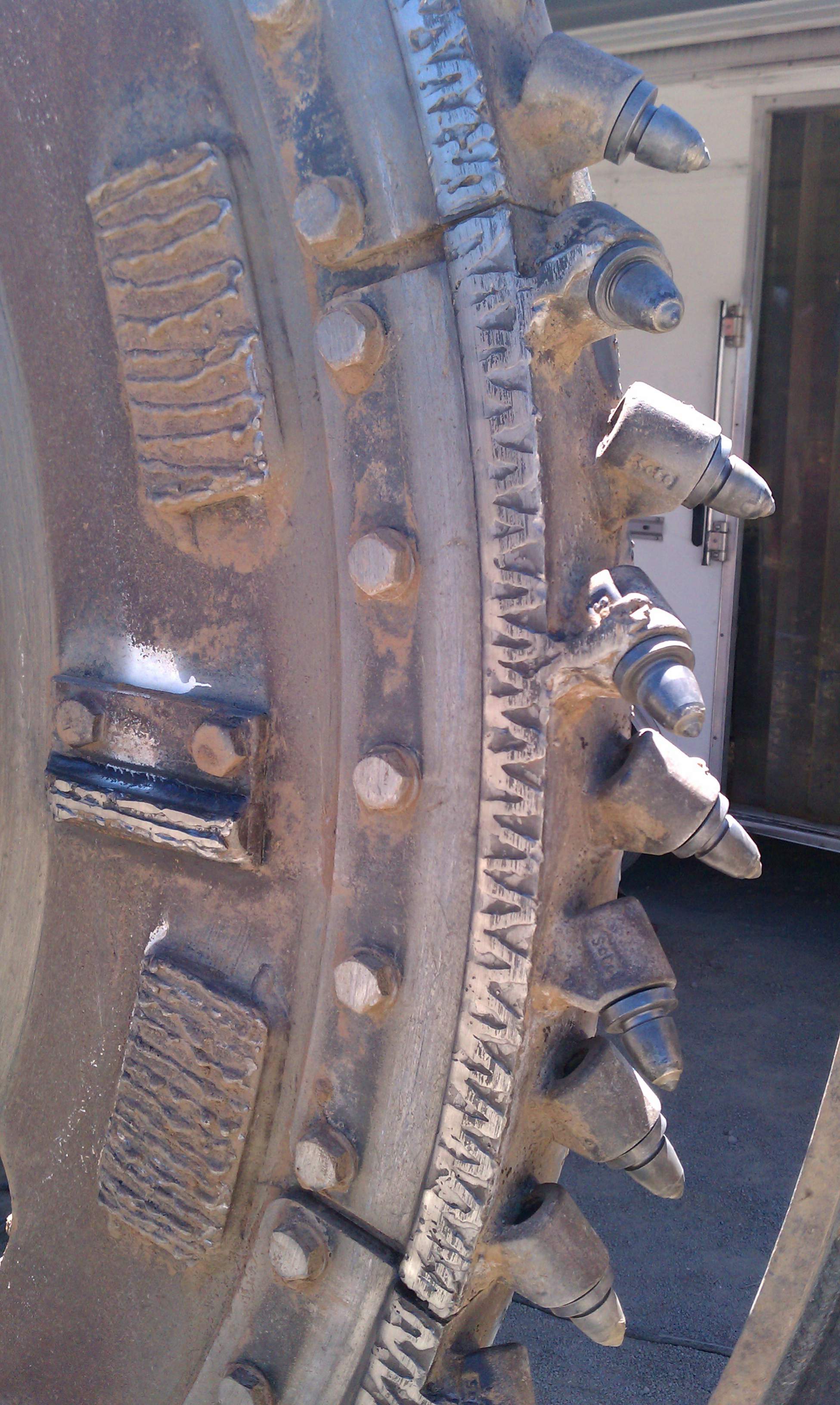

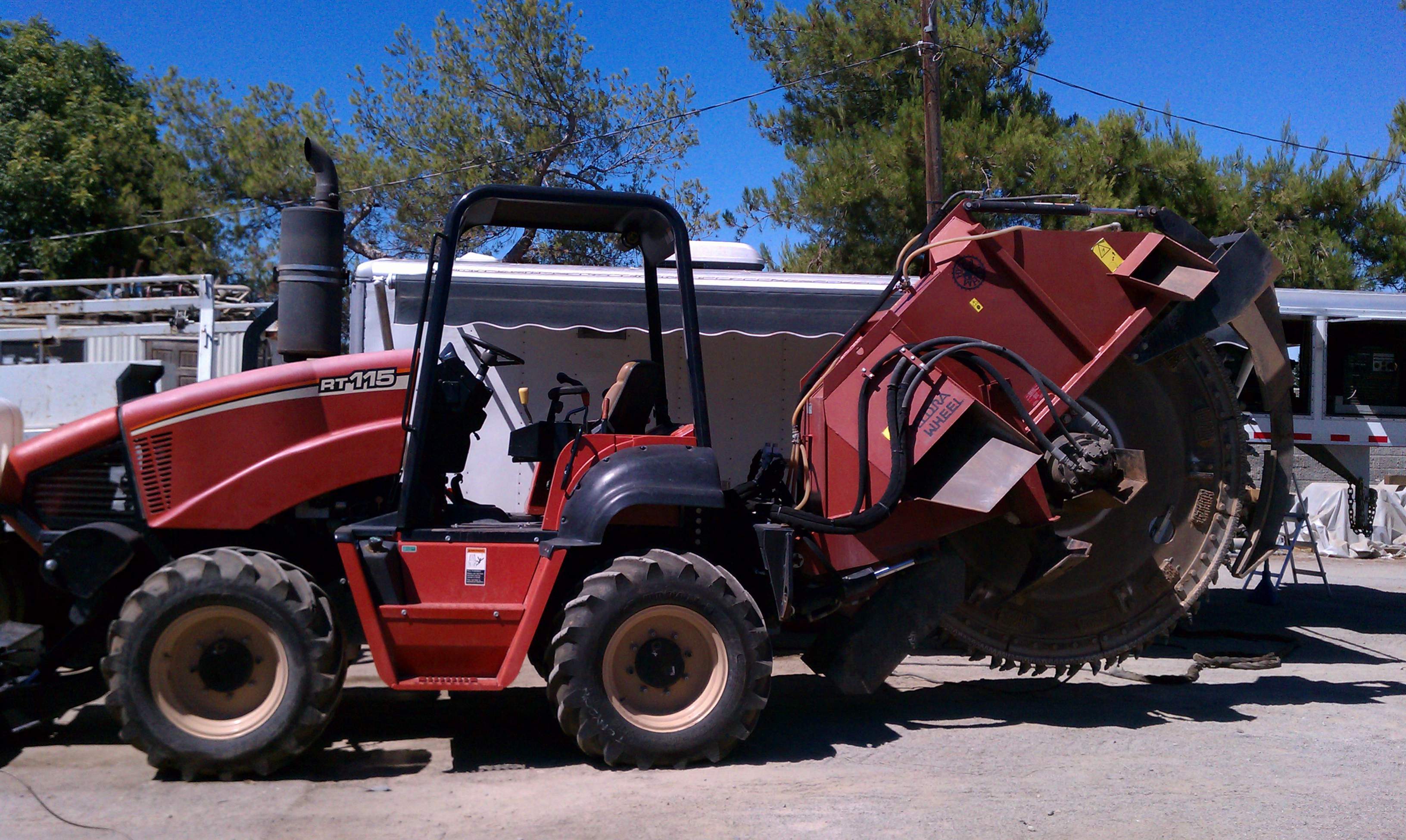

Here are the pics I promised.
The machine is a Ditch Witch RT115
The third pic is of the wheel before I re-hardfaced it. Obviously the last pic is after.
It takes me about 10 minutes per side, per section, and there are 12 sections. So 4 hours of welding plus cleaning it up so I'm not trying to weld sand.

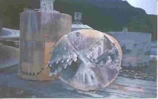

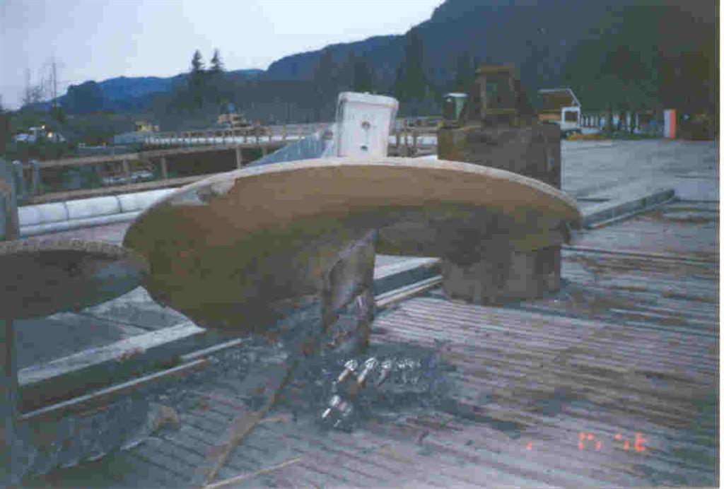

Those carbide teeth sure bring back memories, I've been on several drilling jobs where there were 55-gallon drums full of those things. I've seen more knock down drag out fights over which way to angle them.:laughing:
