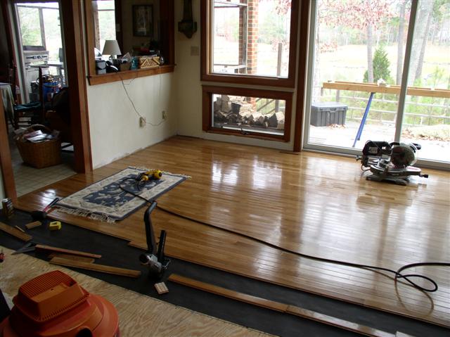

Started this 3 days ago. 3/4 T&G White Oak prefinished at Lowes $2.99 SqFt.
Not bad quality but I've had to cut alot of the end joints square. My hands are too sore to work on it today. I guess the investment in tools may be a factor in which way you go. Get a good flooring air nailer if you go the solid wood route
