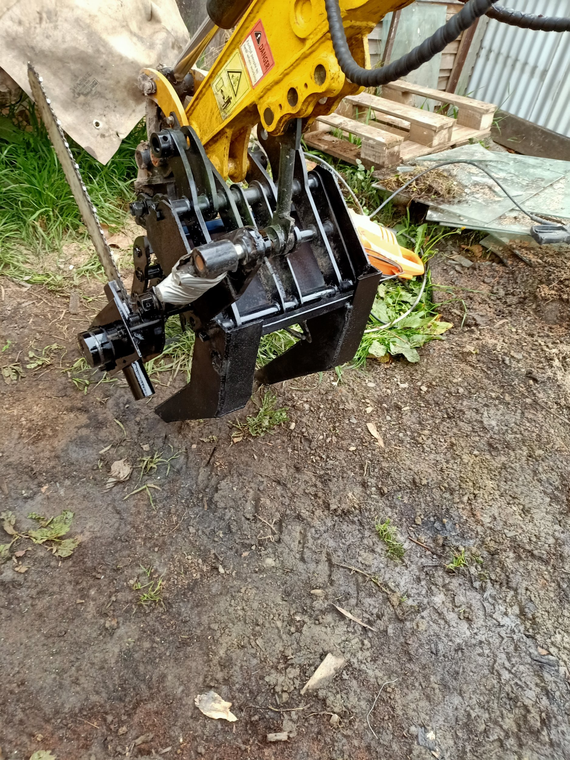

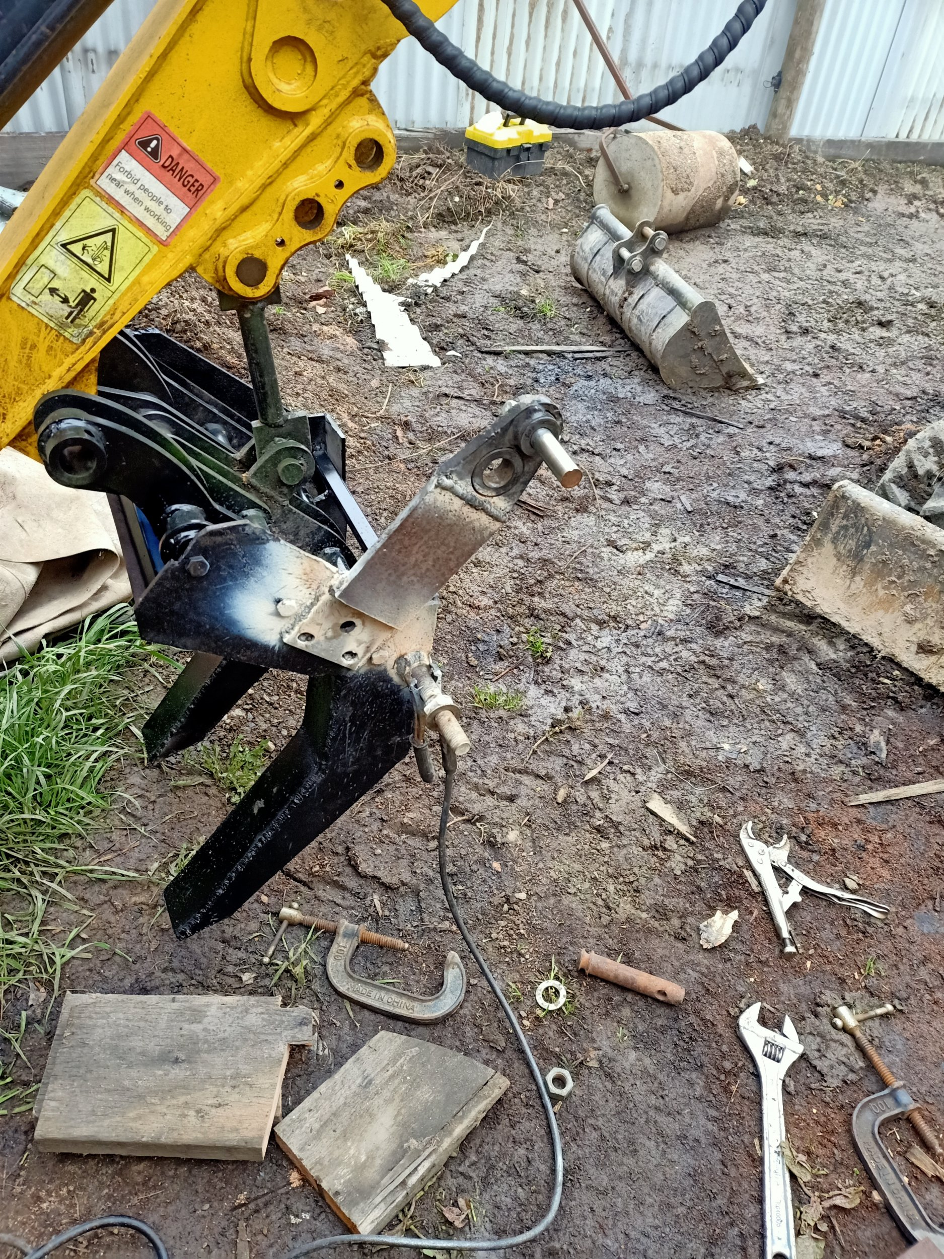

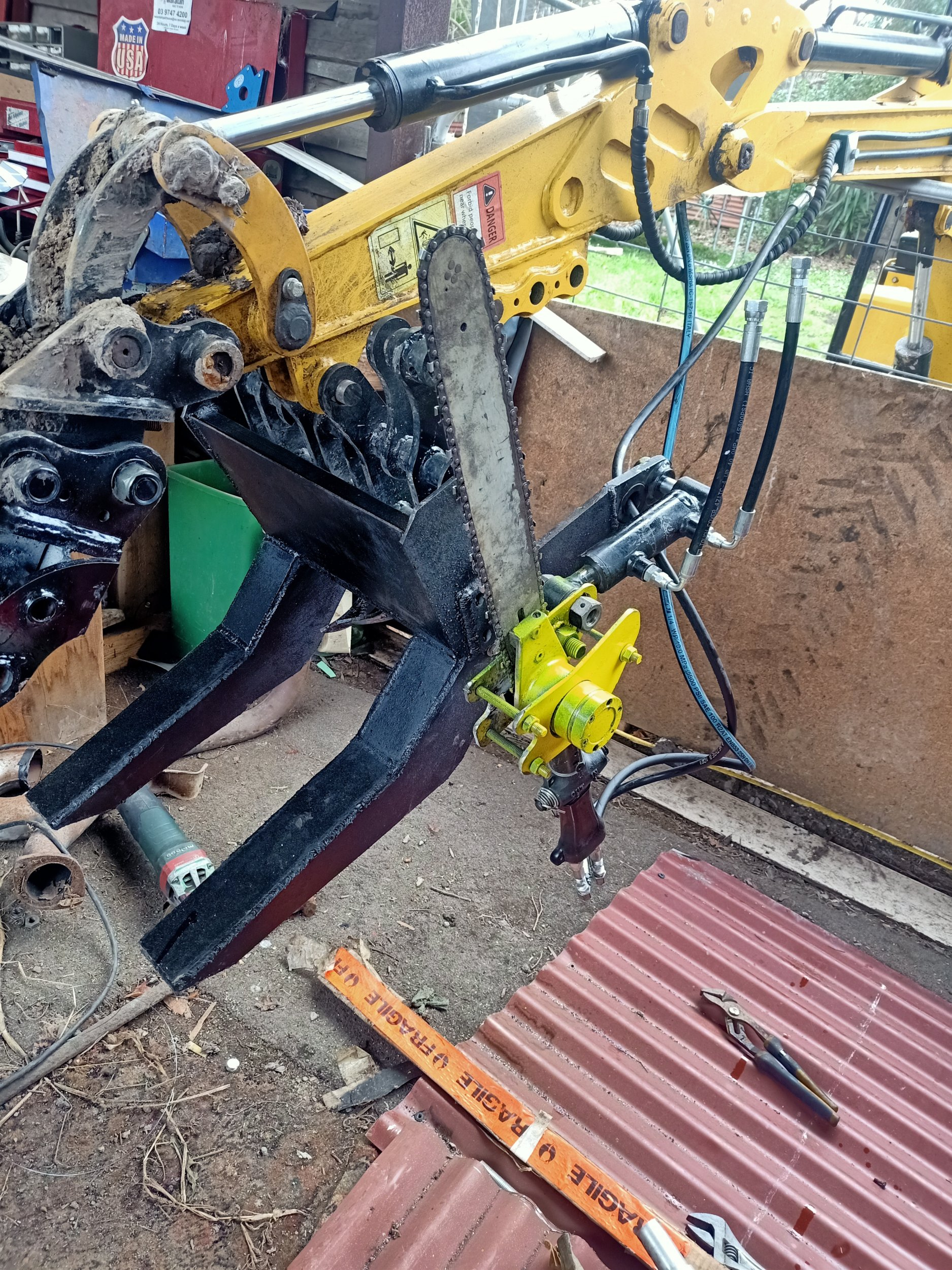

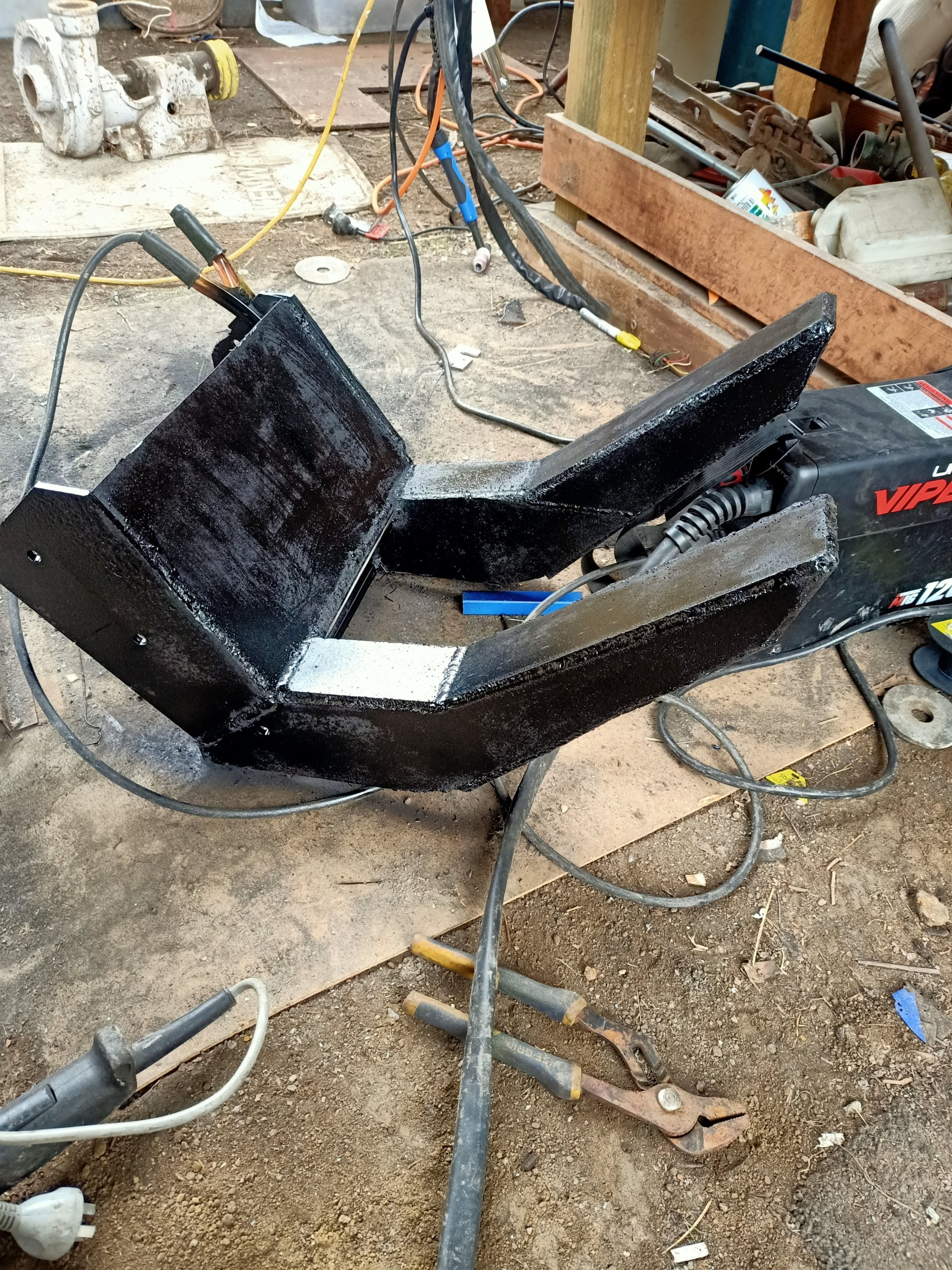

Hi everyone, I made a little more progress today, it's getting closer , once guards and hydraulics are done I'll make a extended linkage for the thumb to get it at the right angle and also fabricate a whole new beak for it similar to a hardwood fork grab 👍👍

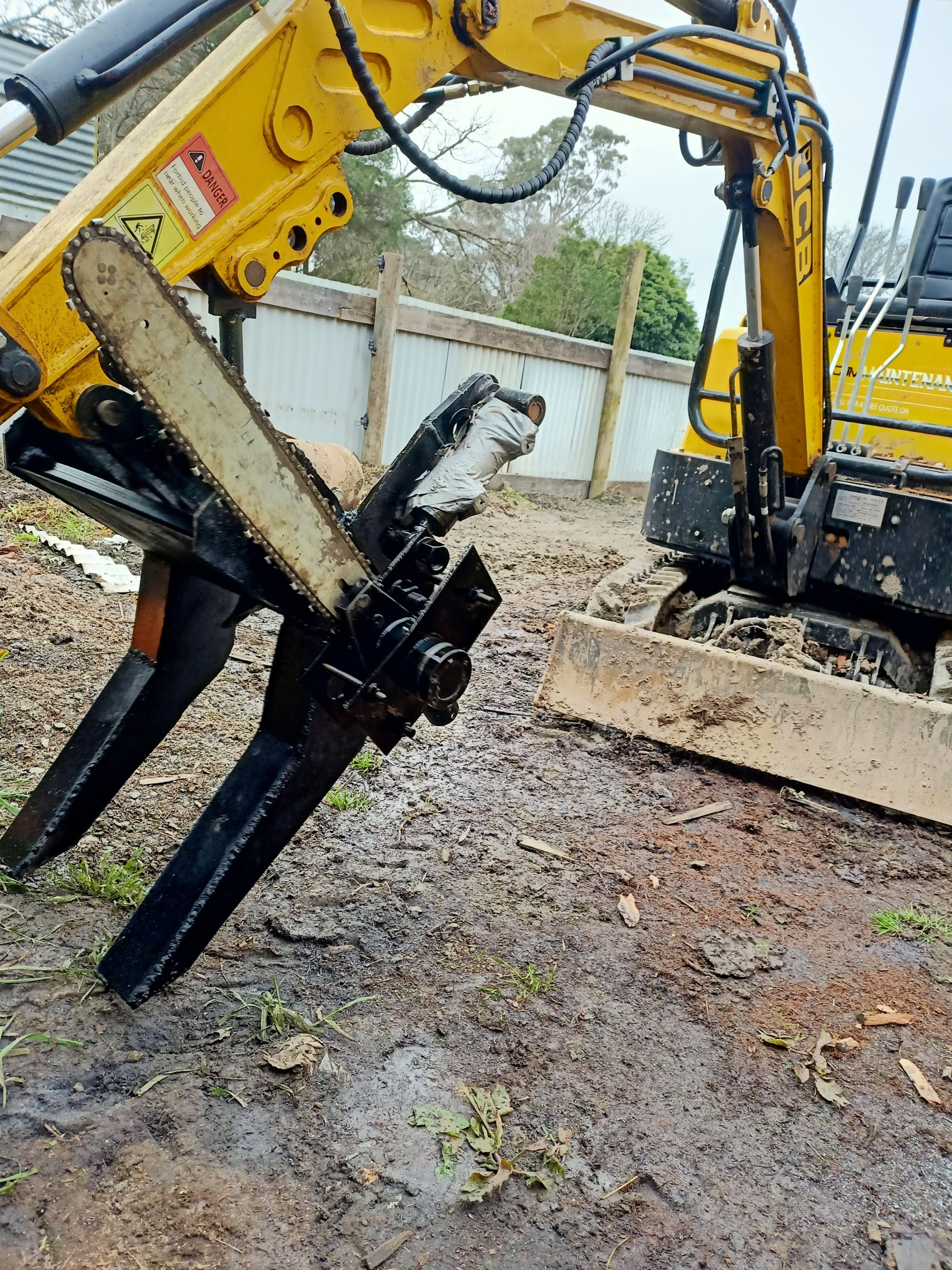

Hi everyone, I gave the saw grab a quick trial run, just gotta set limits and flows then start fabrication of guards, and extend alter the log forks about so saw handle and hoses clear the ground when say is in rest position, video is to large to post so here is my link to the first trial run on YouTube,
Cheers

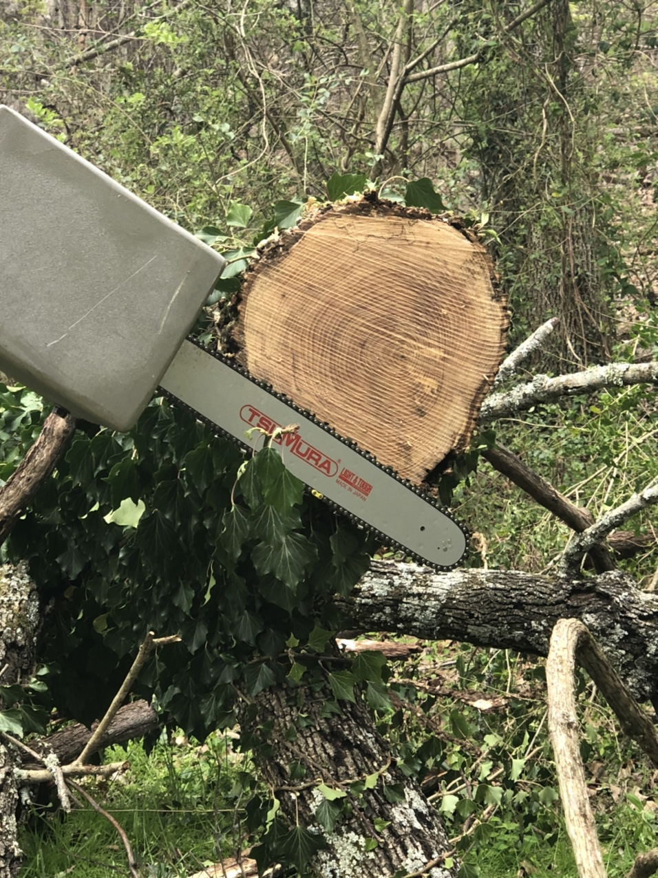

Seems like it works well. It does seem to take a lot of power doesn’t it. The machine I worked on also had a tiny piston putting tension on the bar to keep the chain tight.
   / Has anyone built a hydraulic chainsaw? #36

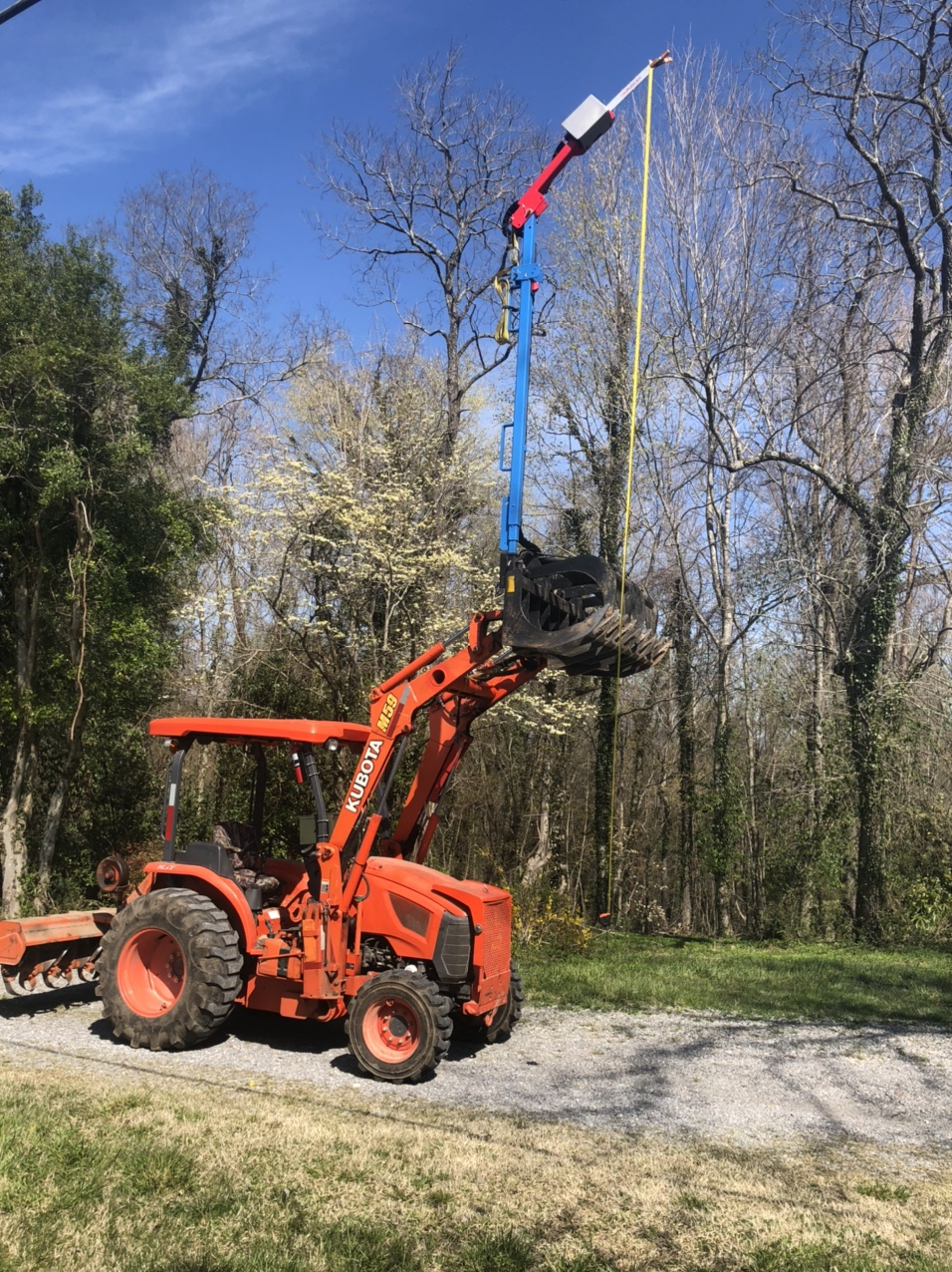

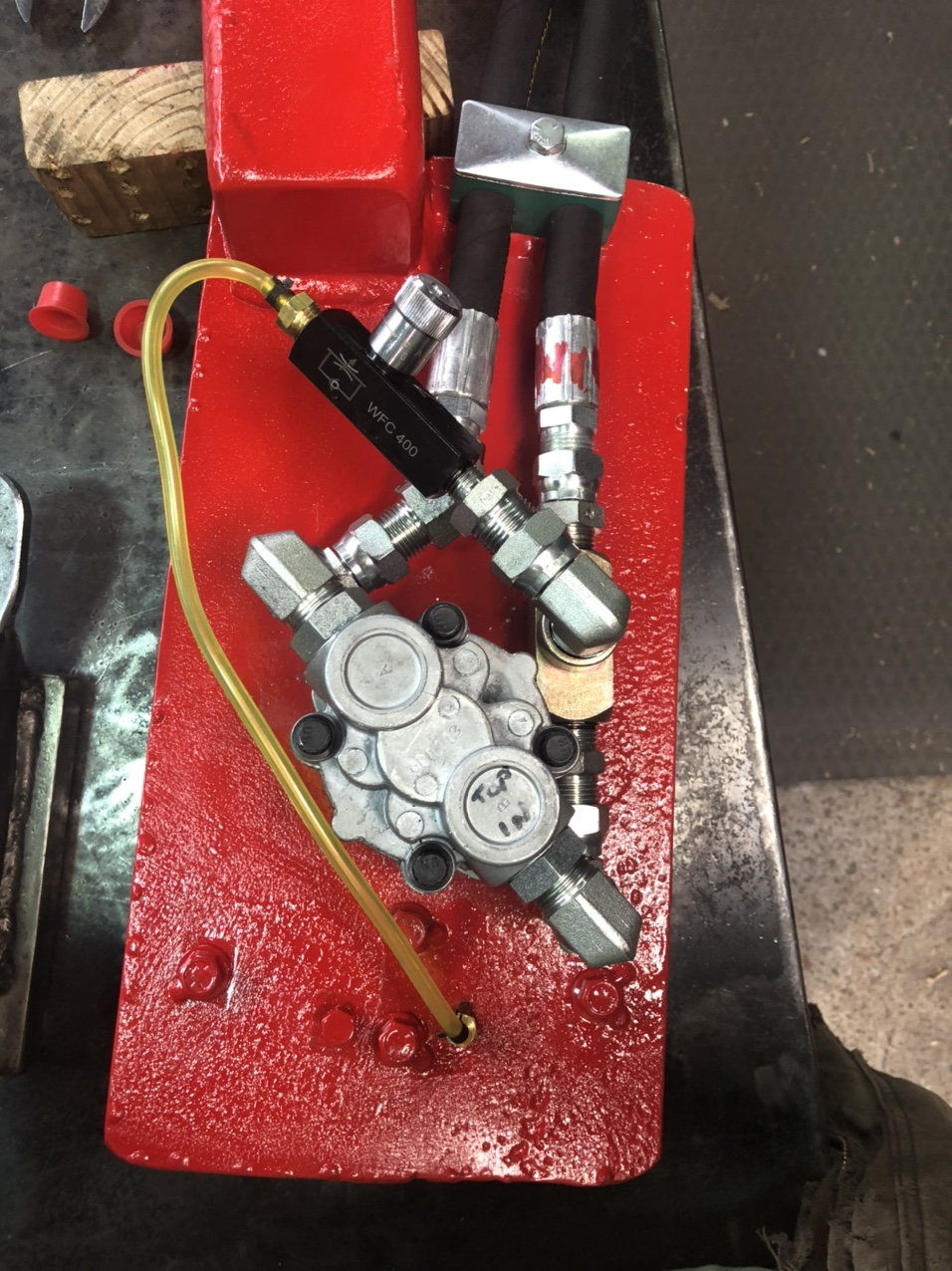

20” bar limbsaw.
Surplus Center Parker motor.
Adjustable chain oiler.
Controlling bar speed and or pressure a concern.

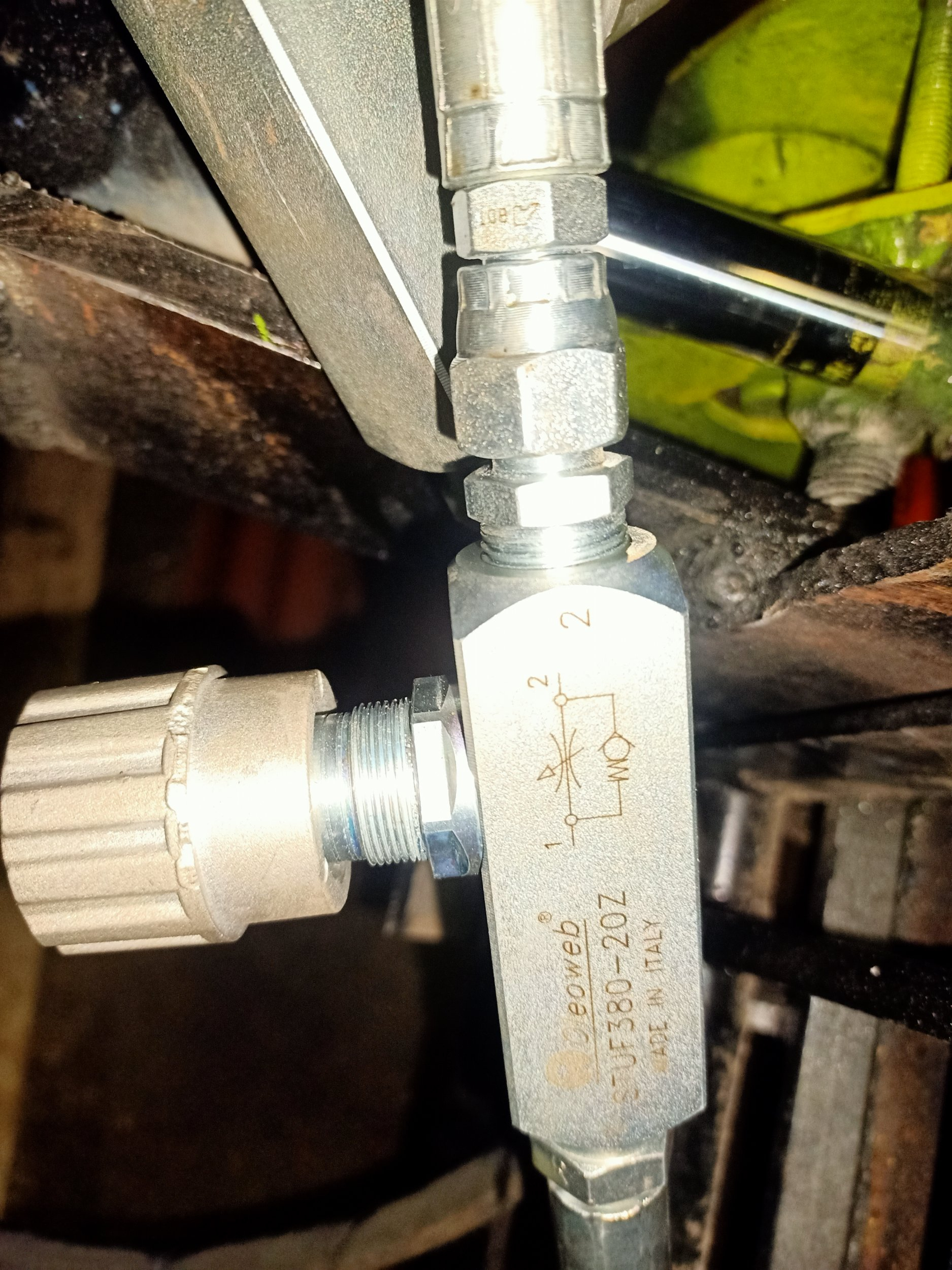

It's not too bad considering its only on a 1.5 ton excavator. Hopefully the last trip to the hydraulic shop today to get a inline check valve then I can finish the rest of it off and give you all a finished product next week.

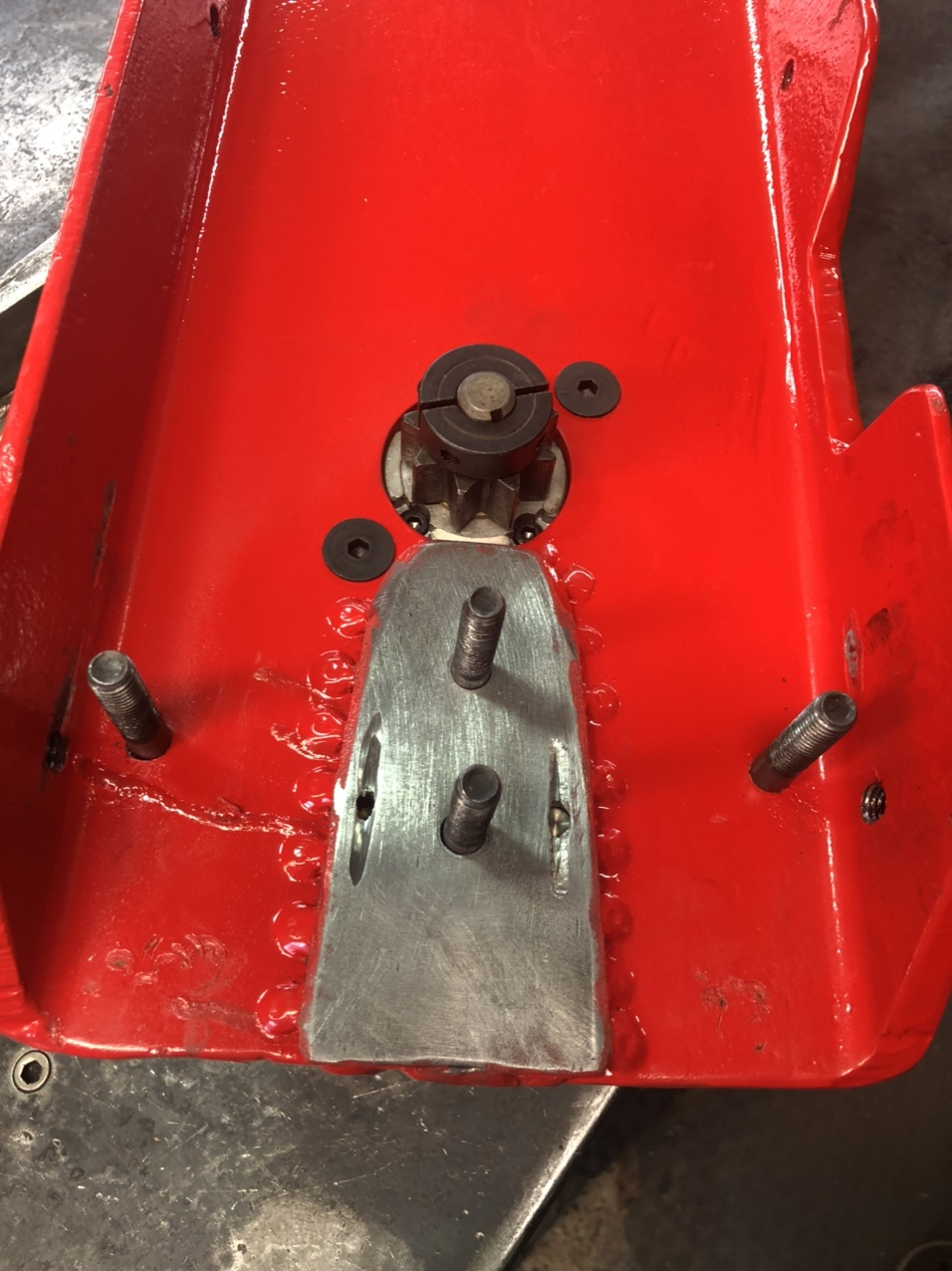

The top (red) section is simply hinged so weight and gravity controls the downward force on the bar.
Forward, reverse saw gets out of a bind.
Currently 9/16”, 0.325, 0.063 on 7 spur drive gear. Gathering some broaches to use 3/8 chain drive rims. Hard to find drives to fit small hydraulic motors. If I recall correctly at 12gpm, 2500psi, 5,000rpm makes about 15 hp.
