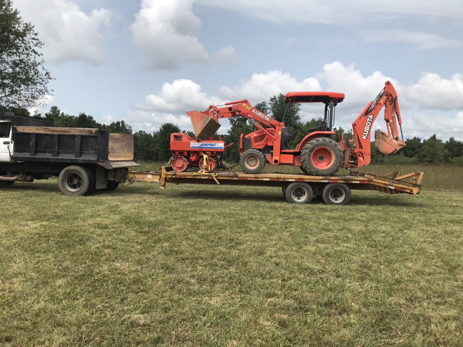

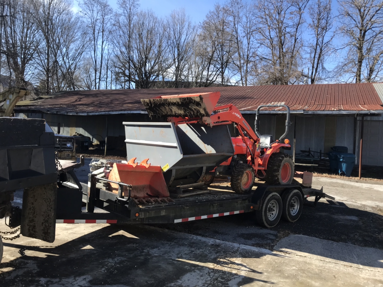

I put mine on my deck over trailer without issue. I do like the lower height of my other trailer though. IMG_9079.JPGIMG_9434.JPG
