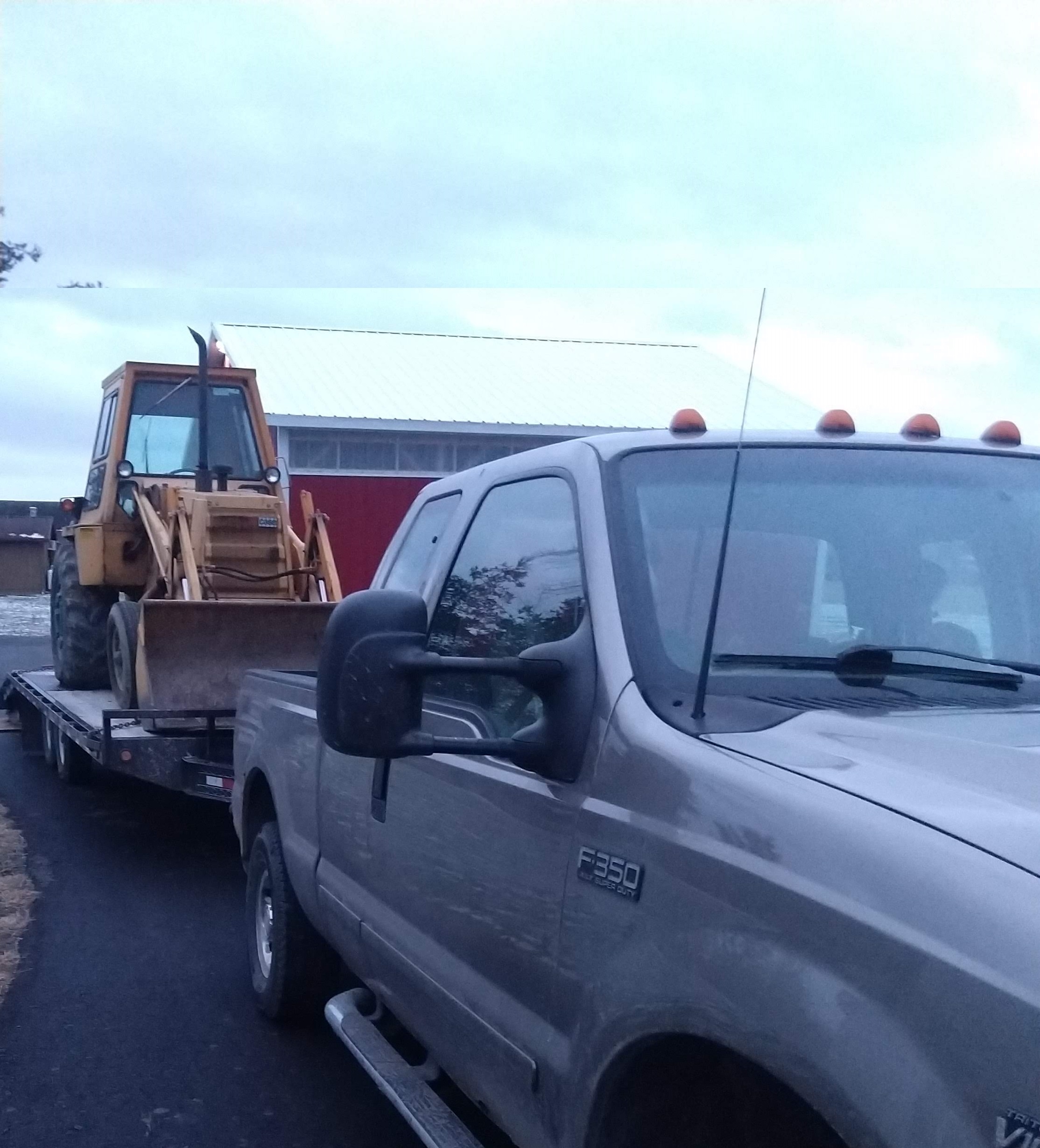

Loading my buddies 80 on the deck over is pretty sketchy but it’s too heavy and wide for the black trailer so that’s the only option we have. Steel tracks on steel trailers have zero traction to make it better.

That setup enters on an entirely different league. It open a lot more opportunities for bigger machines.

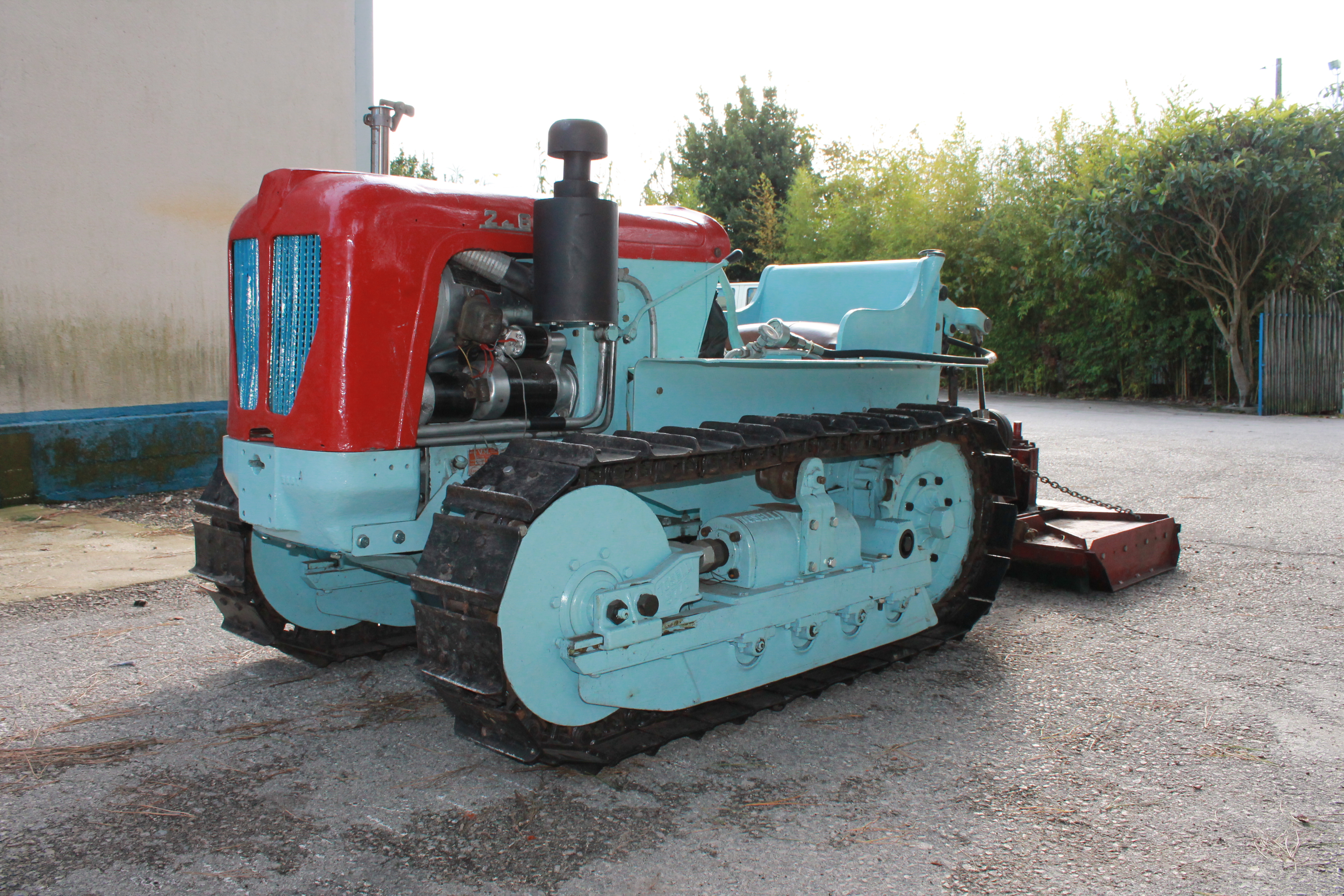

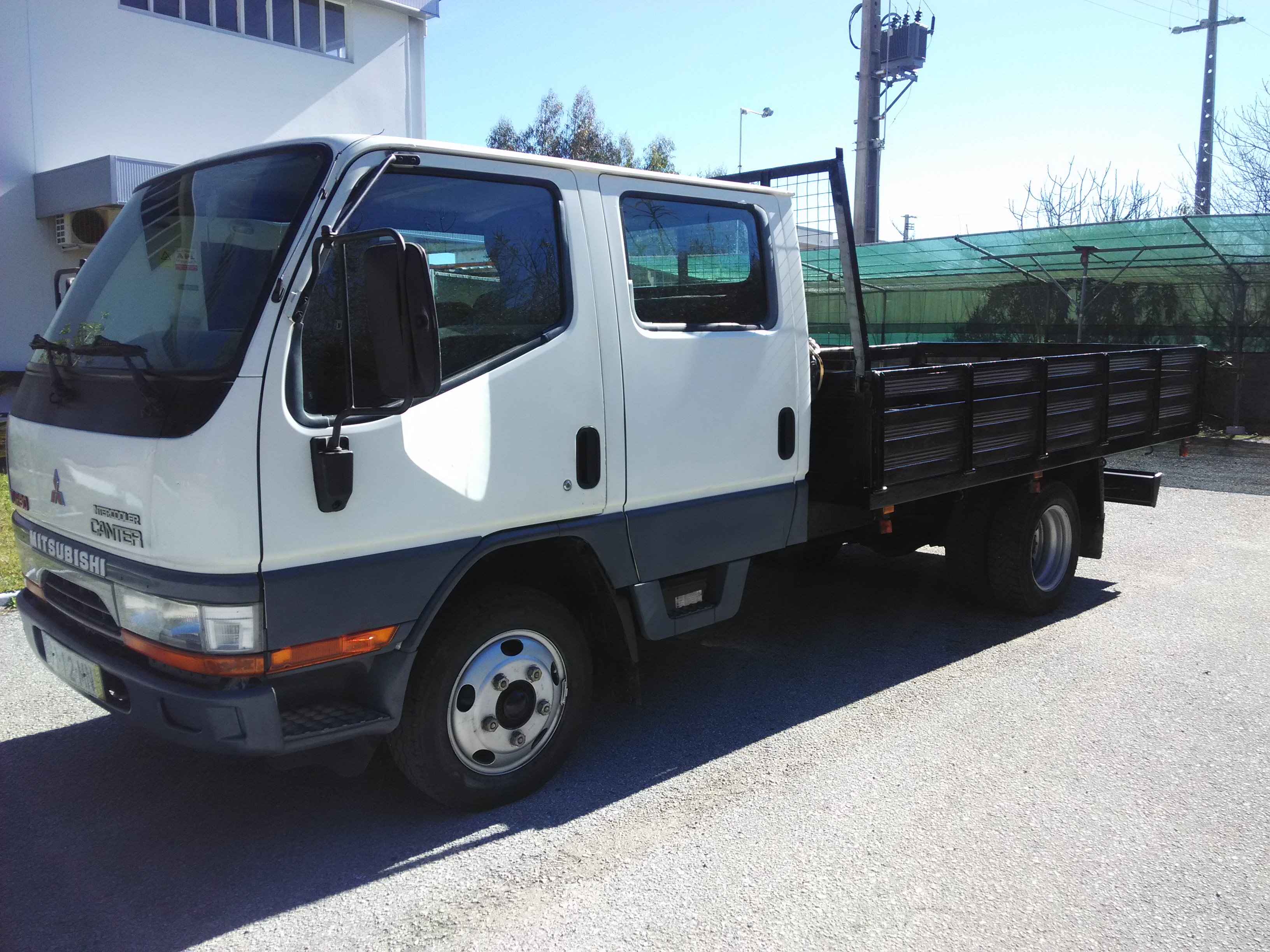

Back when I still had my small crawler tractors, I had a this Mitsubishi truck with a stake bed (not sure if this is the right term). The bed floor was diamond plate, so I went to the local tire retreading place and got two rolls of truck tire retreading material. Every time I loaded that crawler tractor, I would lay the rolls on the bed of the truck and put the tractor on top of it.
This tractor had actually fallen of a similar truck once in its life before I got it and broke the casting on one of the final drives.
Pictures of the truck and tractor:

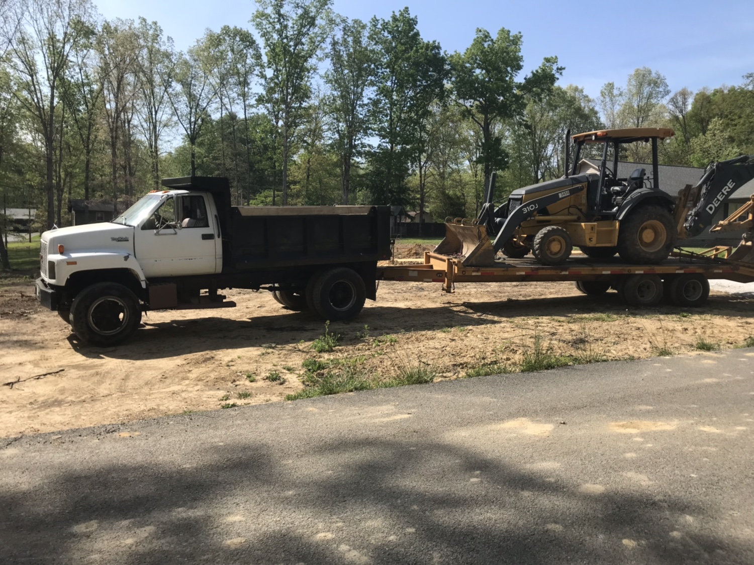

The loading job leaves room for improvement but weight wise this is legal in most of the 50 states without a special requirement. Some states don’t allow trailers over 10k despite the total still not being 26k.

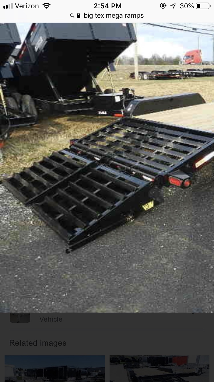

The ramps on my trailer leave room for improvement. They have the angle iron in between the channel sides and the track pads are wider then the ramps. They just sit on the slick channel and get zero traction. If they were built with the angle on top like this they would be way better. How much trouble is it to run medium duty trucks over there? IMG_9638.JPG
That capacity would be very nice to have here. Even for small contractors to move machinery around, as they are usually overweight most of the times with mini excavators, skidsteers, JCB 1CX, etc.

The ramps on my trailer leave room for improvement. They have the angle iron in between the channel sides and the track pads are wider then the ramps. They just sit on the slick channel and get zero traction. If they were built with the angle on top like this they would be way better. How much trouble is it to run medium duty trucks over there? View attachment 684955
I've noticed that as well on some of the videos I see of people towing stuff. That for sure can make for a sketchy ride.
Maybe you could just weld some short pieces of rebar on the channel sides of the ramps. It would provide something for the tractors to hold on.
