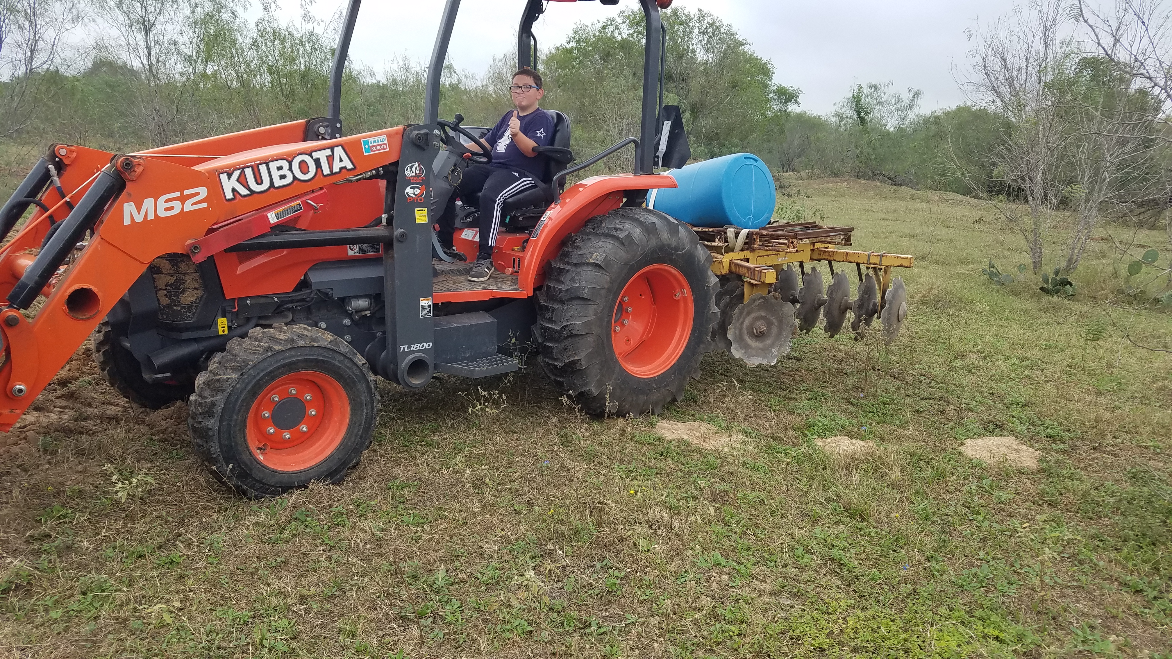

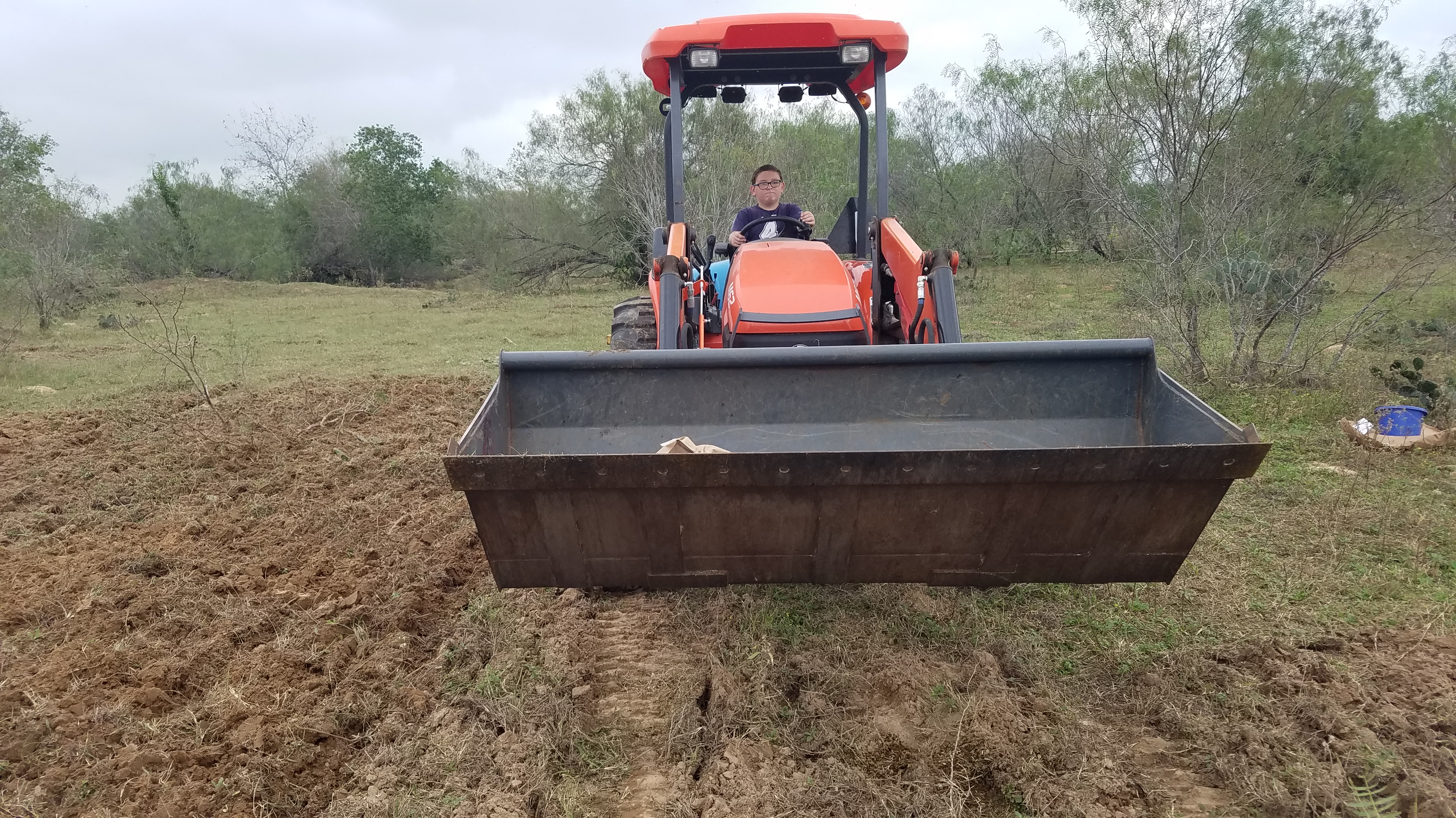

M62 with a 8 foot 3 point disc on it. Putting in a few winter oats and rye grass seed. Letting our son work the dirt.

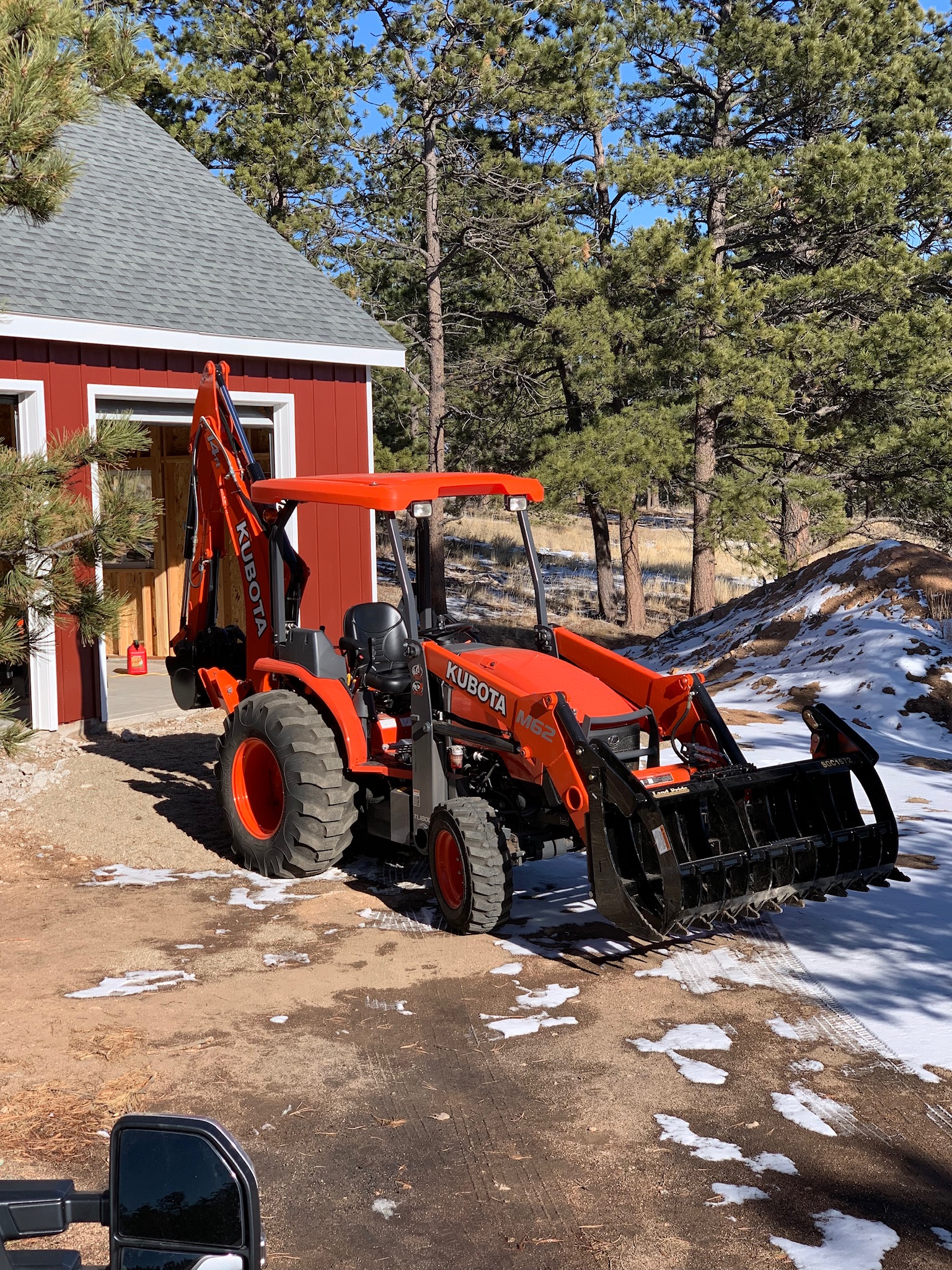

Well I dont have a work shot...ground is frozen in my area... But I did remove the grapple and put the bucket on yesterday! Hey I know you guys are experts but that took me a bit to get down :)
