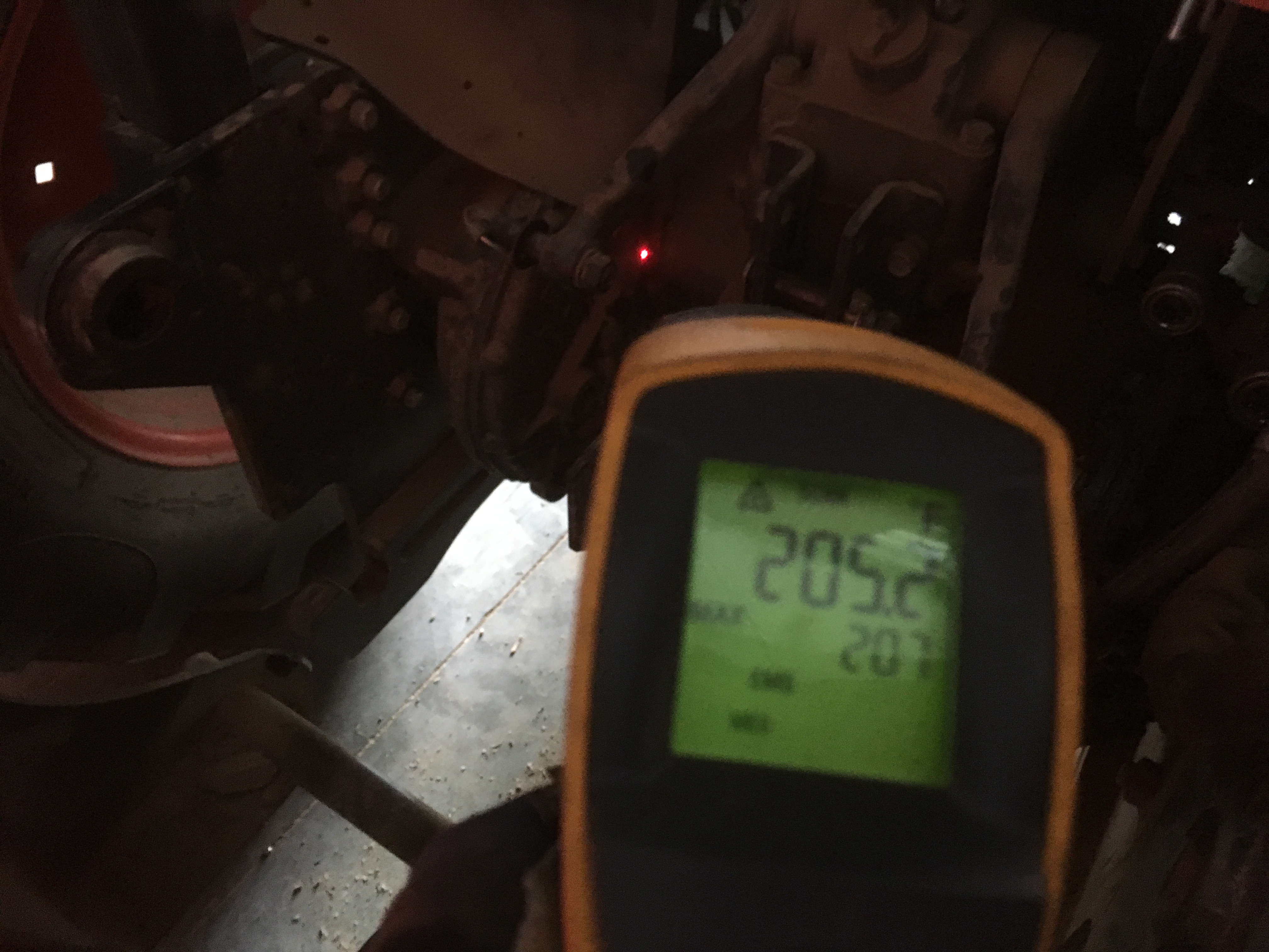

Hey Mutzfarm, congratz!
Can you tell me if your hydraulics ever get hot enough that the casings could burn you, if you held onto the metal for say ..... 5-6 seconds? I'm running my M62 with a Landpride 12' batwing at around 2200rpm & after an hour or so I can begin to feel the heat rising up from behind the seat. The hydraulics are that hot! Of course thats running in M gear using both hi/lo speeds & the PTO engaged. The metal casings are so hot that it's painful to remove the 3pt. hitch from the back end...
I've checked all fluids & I'm good there, the radiator screen is a joke, everything gets past it & clogs the radiators. It's a real booger cleaning and requires a pressure washer & shop air. Someone mentioned about putting bigger radiators on or an additional hydraulic cooler. I think I might just try doing that, but was wondering if anyone else has noticed the heatsoak.

#13
Just a few thoughts re. the heat. 1) Yes, do the radiator cleaning as often as needed. Don't know if there is anything unique about the M62 layout that makes it any worse than a conventional Grand L unit. Just speculating though... you've got a lot of extra backhoe subframe and loader structure you're carrying around, so maybe there's not as much airflow getting to the engine bay and transmission areas. 2) The engine is rated at 2,700 rpm, not 2,200 rpm, so are you really making the full rated hydraulic flow at 2,200? If not, that may be contributing to the heat build up. 3) That 12' cutter may be a handful depending on what you are cutting with it. Have you tried dropping into L to see if that helps? 4) Does engine temp also go up? 5) Do you have access to an IR heat measuring device? The hydraulics do get really hot in operation... I think 185 F is typical. I could always tell when mine was getting hot because there was a distinctive aroma to the HST fluid that was my signal to back off what I was doing. Good luck sorting this out.

   / Having a blast with our new M62 #18
Well, I still don't believe what found but the hydraulic radiator was clogged again. This is only after ~15 hrs. of use. Here's the problem I see with a crankshaft driven fan & your operating rpm 2500+, you have a good suction through the front. Additionally you have the FEL in front of the exhaust pointed at the ground that's blowing anything loose into the air right in front of the radiators. Finally you have no screen or anything to filter the debris fron entering the hydraulics radiator. This by the way is the most effective screen for the coolant radiator. Additionally, you have no temp gauge for the hydraulics yet you have a coolant temp gauge & the overheated hydrauic system can cost more than the engine ever thought about... I'm trying to find any sort of idiot light or any temp sensor in the hydraulic system, surely there is one?
In any case, dunno if it's my enviroment or what but I now have to blow out the radiators before work every morning, I should have been doing this from the start but lesson learned.
