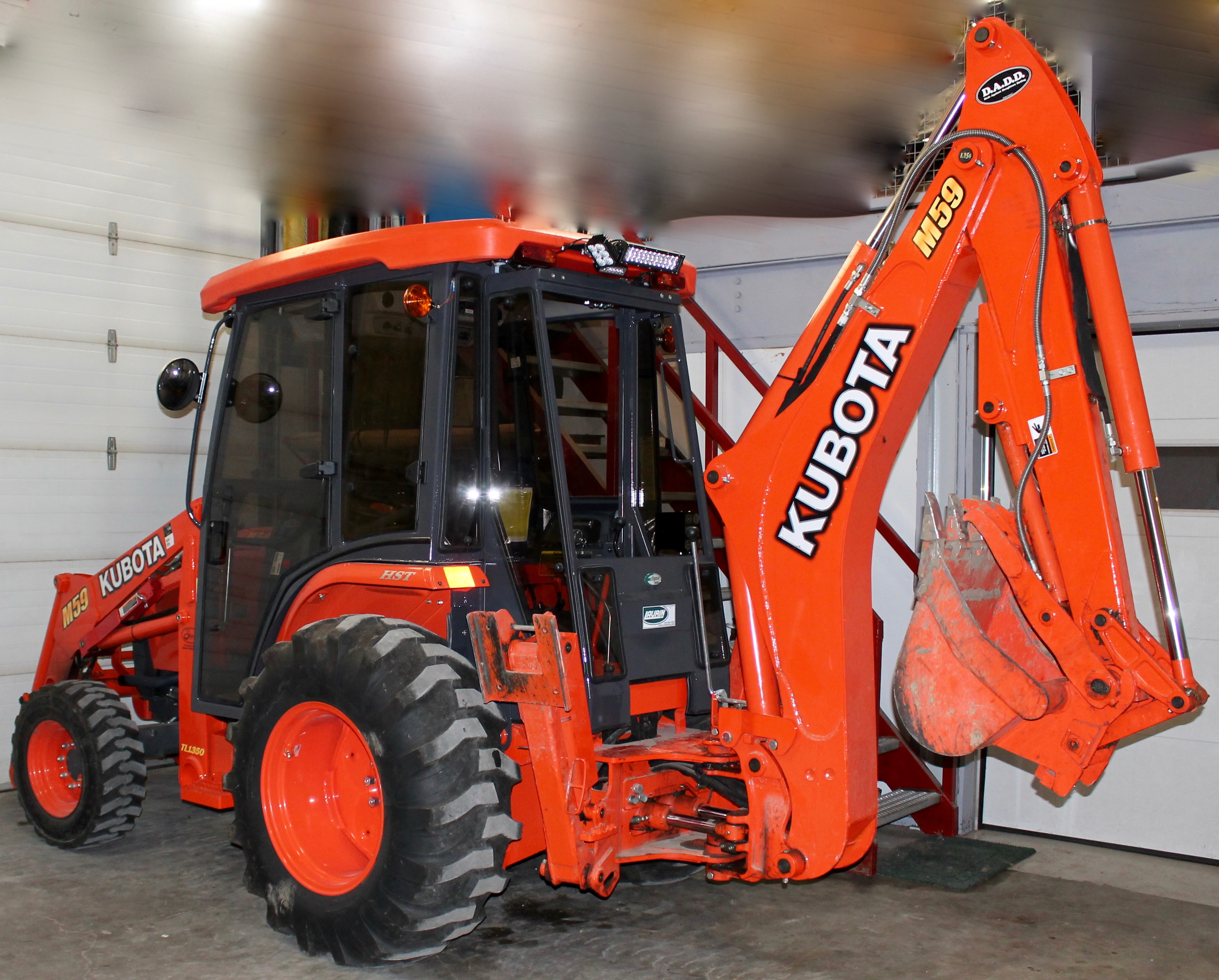

I went and operated an M62 a few months ago and REALLY liked it! It had the cab option installed and it was nice to get a feel for it. I thought when operating the hoe though that it really needed the tires filled. The hoe is so powerful it pushed the machine around a lot.
Do you guys notice this or am I just too used to a full sized construction backhoe? Overall, I liked the M62 better than my full sized backhoe.

I think it does need a little weight added. I will probably go with wheel weights VS filled tires. Manual says to take liquid ballast out when using backhoe. I dunno. Anyways liquid is not good for me due to the environment I work in. LOTS OF THORNS and some nails. I have some AWESOME tire sealant in my tires and this doesnt go well with liquid. My last tractor probably had more wood than rubber in the front tires.
I dunno if you can over ride the creep feature, but I can tell you I left it in M instead of L one time and I thought it creeped faster.

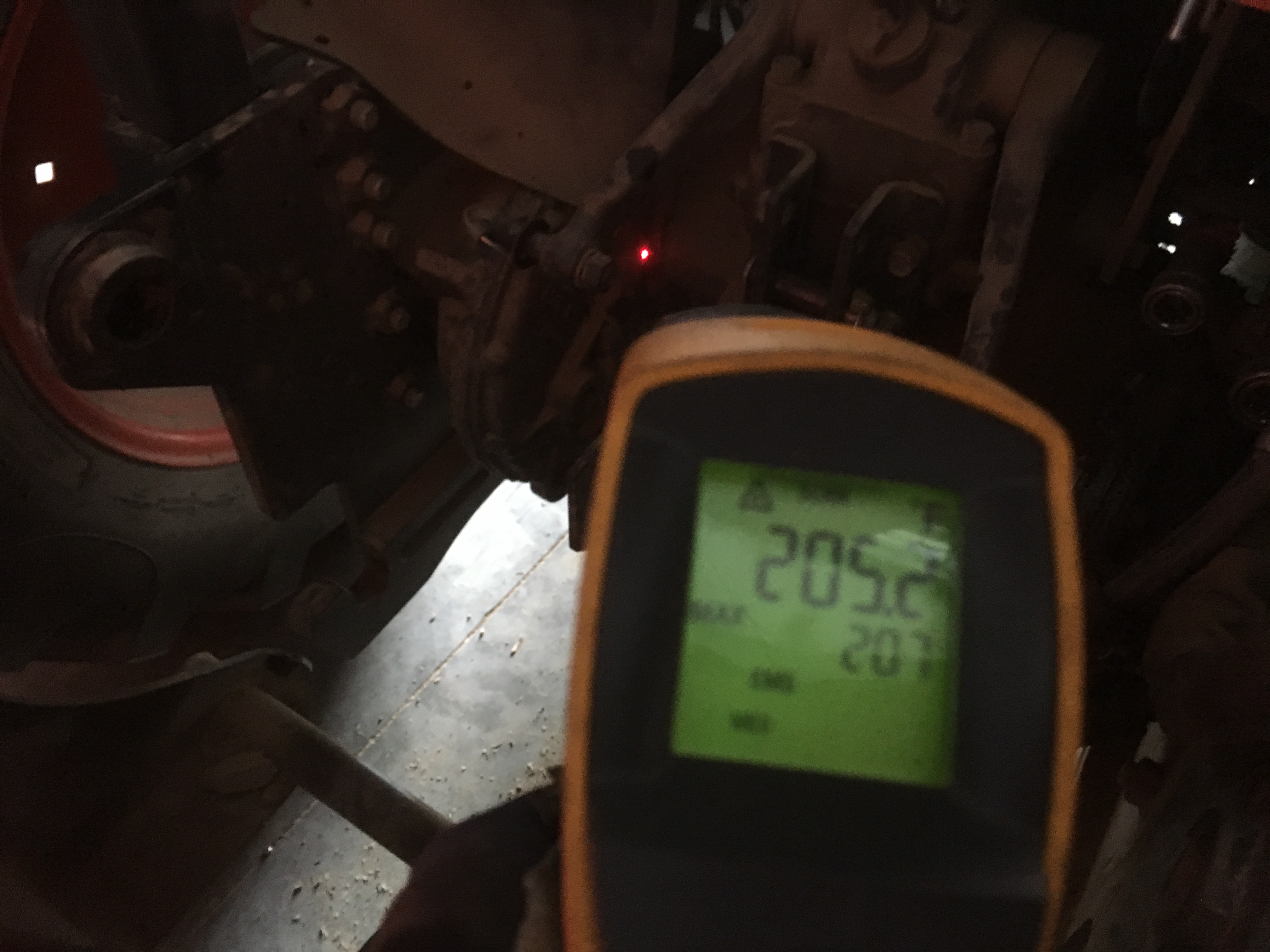

Well, I still don't believe what found but the hydraulic radiator was clogged again. This is only after ~15 hrs. of use. Here's the problem I see with a crankshaft driven fan & your operating rpm 2500+, you have a good suction through the front. Additionally you have the FEL in front of the exhaust pointed at the ground that's blowing anything loose into the air right in front of the radiators. Finally you have no screen or anything to filter the debris fron entering the hydraulics radiator. This by the way is the most effective screen for the coolant radiator. Additionally, you have no temp gauge for the hydraulics yet you have a coolant temp gauge & the overheated hydrauic system can cost more than the engine ever thought about... I'm trying to find any sort of idiot light or any temp sensor in the hydraulic system, surely there is one?
In any case, dunno if it's my enviroment or what but I now have to blow out the radiators before work every morning, I should have been doing this from the start but lesson learned.
Wormwood
I dont think a temp of 205 is bad depending if it is normal though. I wonder how high it gets when you think it is going bad.
Most engines today run at 190+. Some of the tractor truck / 18wheeler thermostats dont even open till it is at 215 degrees which IMO is CRAZY. I think that is when crap starts to warp. I think the 5.9 cummins in my dually doesnt open till about 210+. Still makes me uncomfortable, but thats emissions for you.
I know on the other tractor we got rid of sometimes I had to blow out the radiator every 30minutes in the summer cutting thick grass. Gets old in a hurry.
