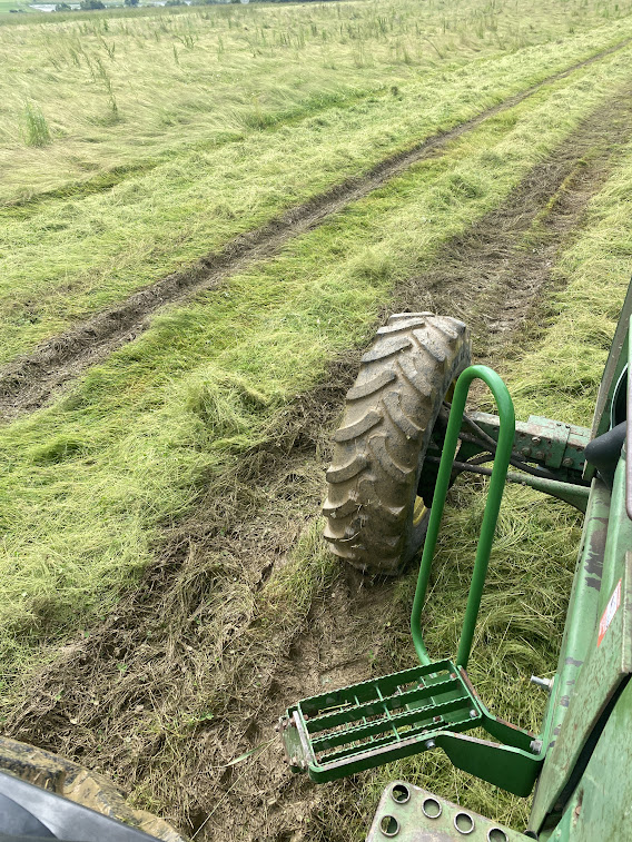

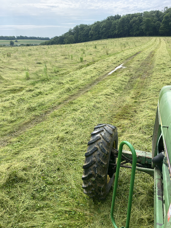

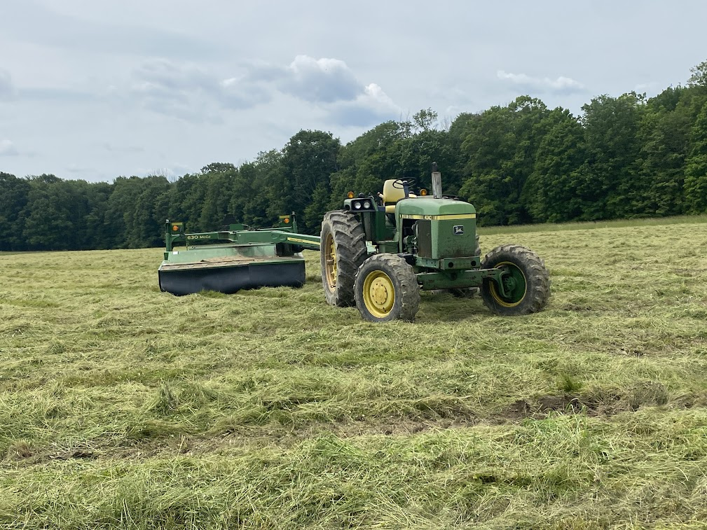

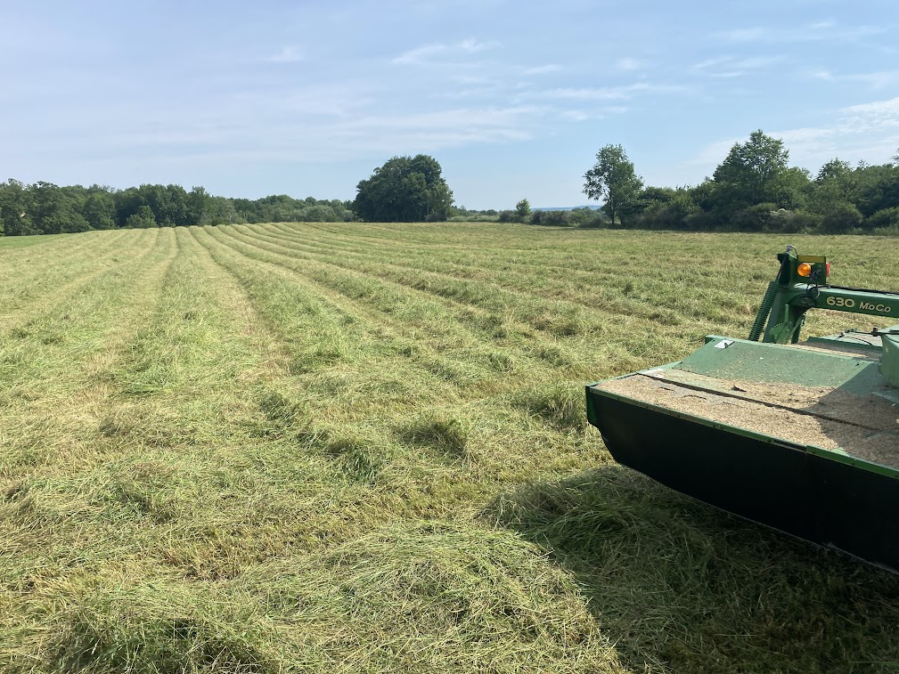

Have a whopping 6 acres down when we should have 20-30. Look at that ground. Entire time mowing was thinking how nice this was.
Then we went to the other farm that is good ground and knocked down 11 acres for baleage and knew why we made the decision we did. There is soft then there is well beyond soft. Nothing but standing water and mud.

How soon after you cut until you got that baled up? Usually I get an alarm for too much moisture if I bale over water or mud.
Man your ground holds a LOT of water!

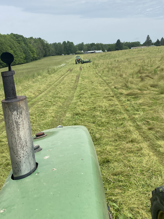

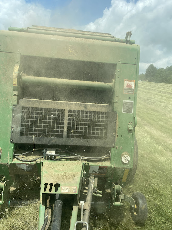

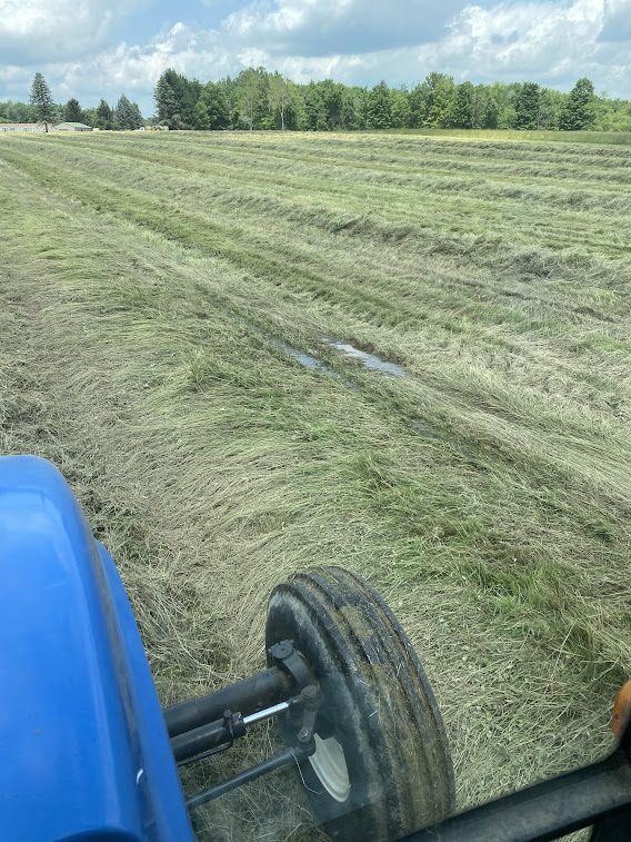

I guess I hadn't posted the pictures yet. It was baled the next day and wrapped.
The dust isn't because the hay is dry.
Just a wet depressing year. Got 13 acres of 185 done up as dry. Have some rye down now for baleage that now is wet from rain.

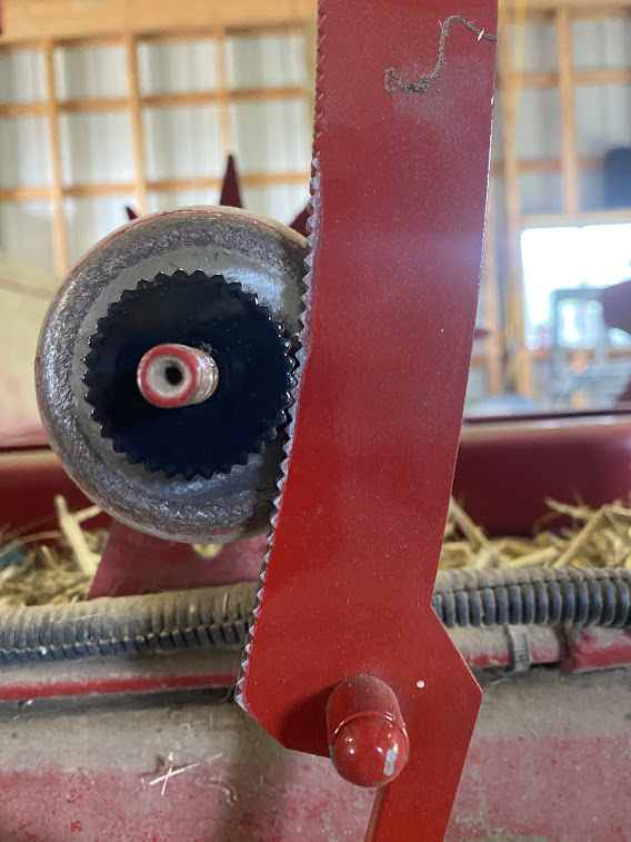

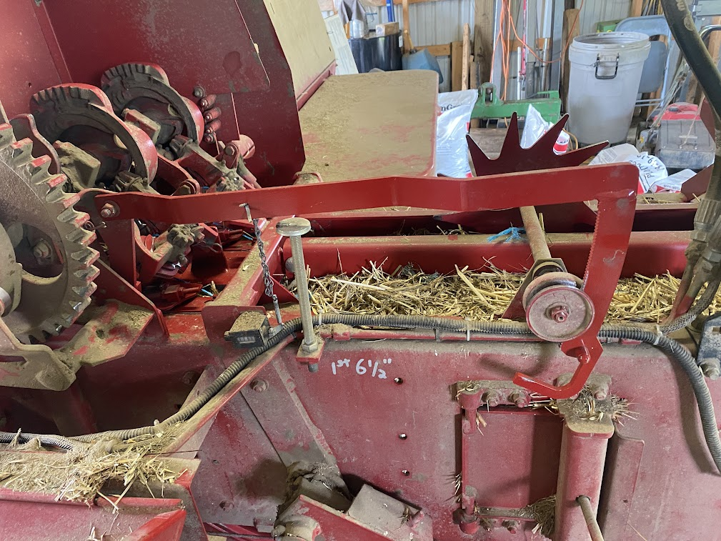

Square baler was ready for a maintenance repair. $338.30 later
View attachment 3669044View attachment 3669068View attachment 3669111
I'd say so. Those are wear parts afterall. Looks like the 575 I sold a couple years ago, minus the knotter blowers and one shot knotter stack greasing. NH in my opinion still makes the best small square bailer with a Hesston inline coming in second. There is another outfit (Macchino or some such) that builds a copy of the Hesston in line.

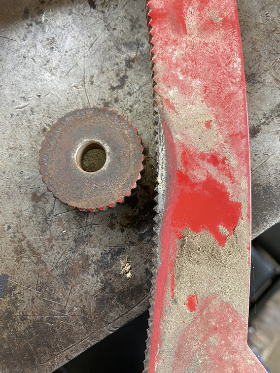

NH makes the serrated wheel harder than the arm, concequently, the teeth on the actuator arm wear out and round off when causes the bailer to trip erratically. You have my physical address so you can contact me and I can remachine your old one with new teeth if you want, In fact I need to look but I may have a remachineable one in the shop somwehere. What I did with mine to insure uniform bales is I took a small block of die plate and slotted it and drilled and tapped it for a thumbscrew so I could attach it to the trip arm to provide additional weight so the trip arm was prevented from bouncing as the bale grew in the bale chamber and you could adust the weight for optimum bailing. If you want one, let me know, only take a minute to slot a piece of die plate and thread it for a thumbscrew. Once I got it 'dailed' in my bales were all uniform length.

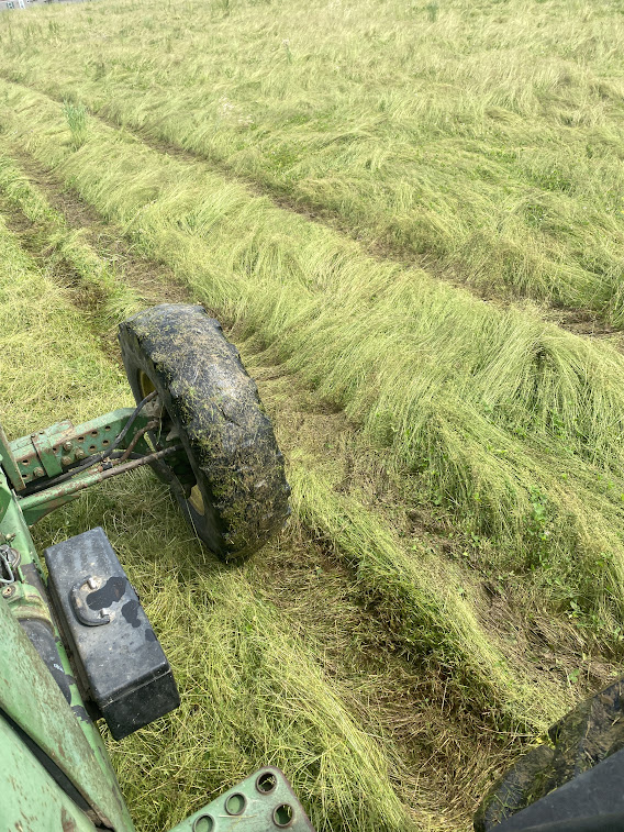

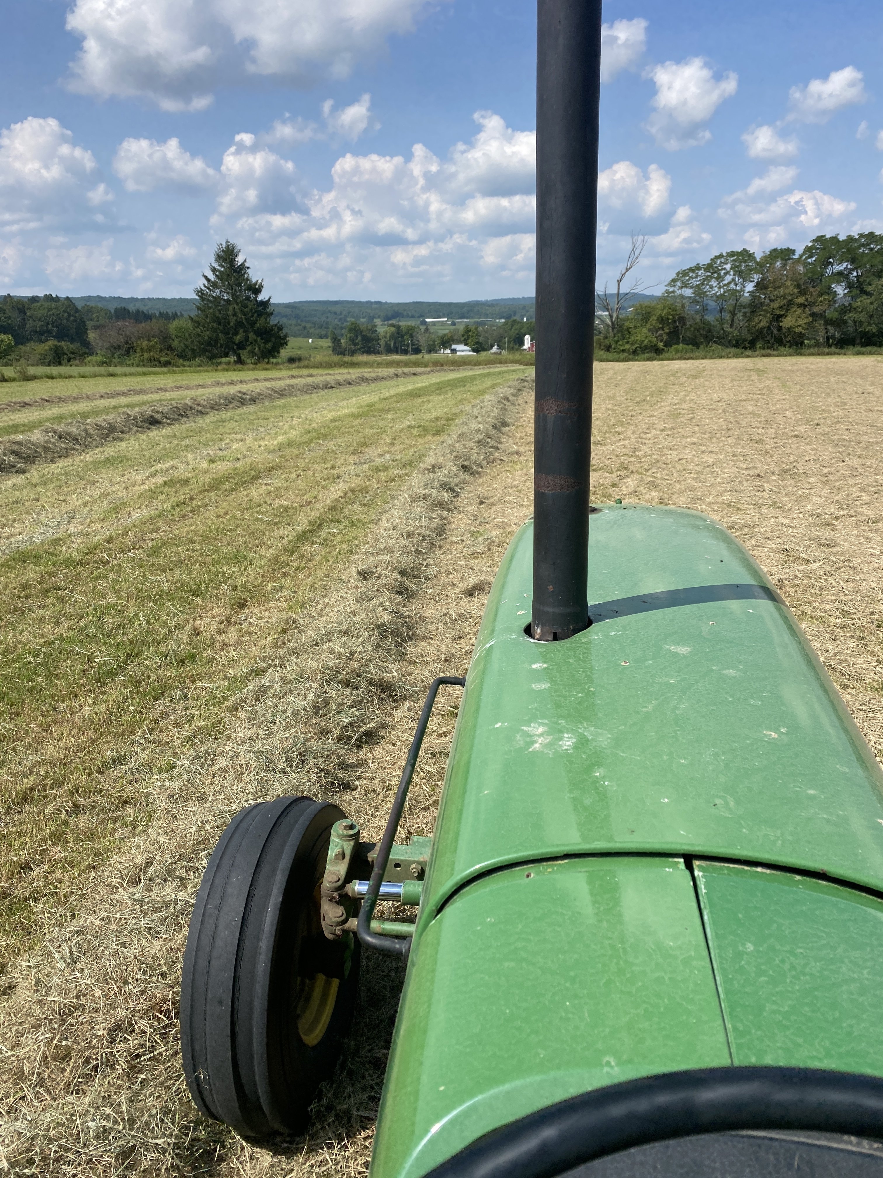

You almost have to wrap in your situation, right? I mean it’s like fighting a losing battle to make all of your hay dry hay?
In the last picture, it looks like you had less than stellar cutter bar results. Was the hay lodged real bad from heavy rain?
It's a weed field that I haven't decided what I'm doing with it yet. Lots of low growing clover and Johnson grass. Needed to be cut weeks ago to salvage the Johnson grass. Once it dies just falls flat on the ground. Cattle love it though.

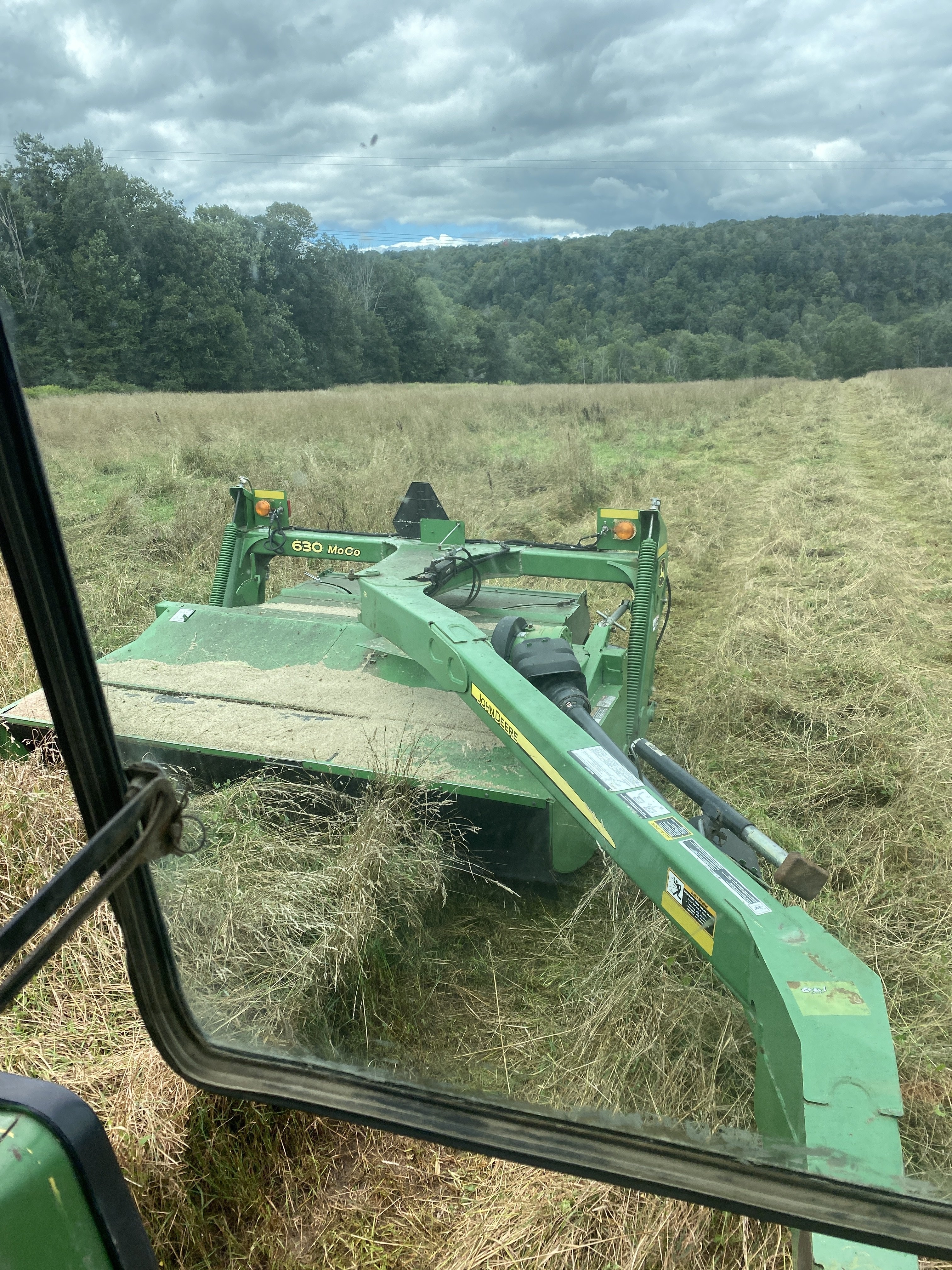

Dozed off. Mowing yesterday wasn’t any better. It’s rough
